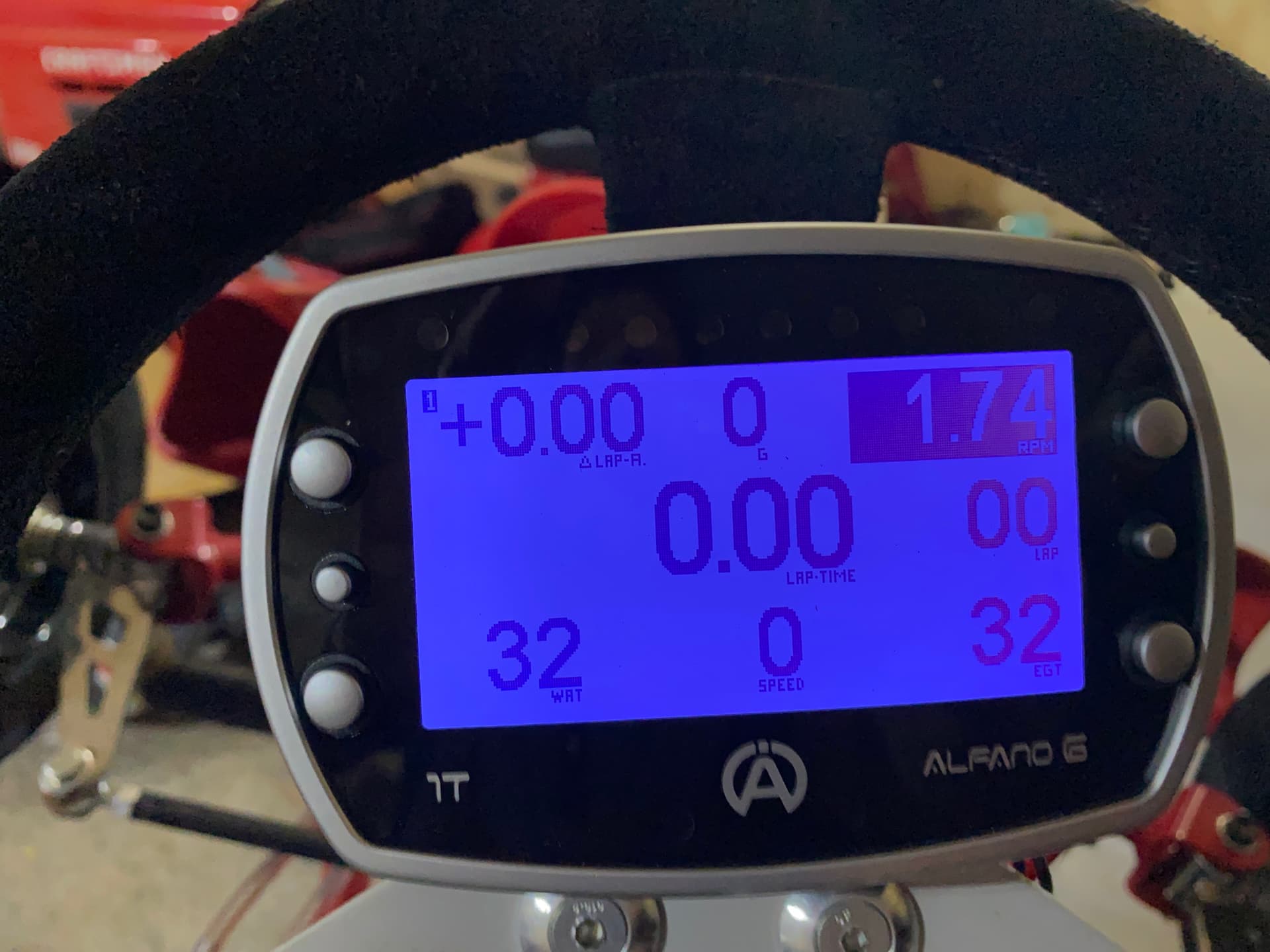

How do you change the RPM display to read as 5000 and not 5.0?
I have the factor set to 1x and it is giving me a reading like the 5.0.

I tried to change those settings and I’m still showing 2.0 instead of 2000.

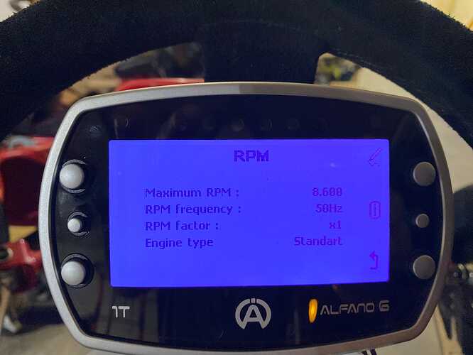

Step 4: Set RPM Frequency to **10Hz** (Not 50Hz like I mentioned earlier)
My bad, thats what I get for going off my memory. :laughing:

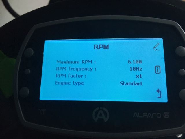

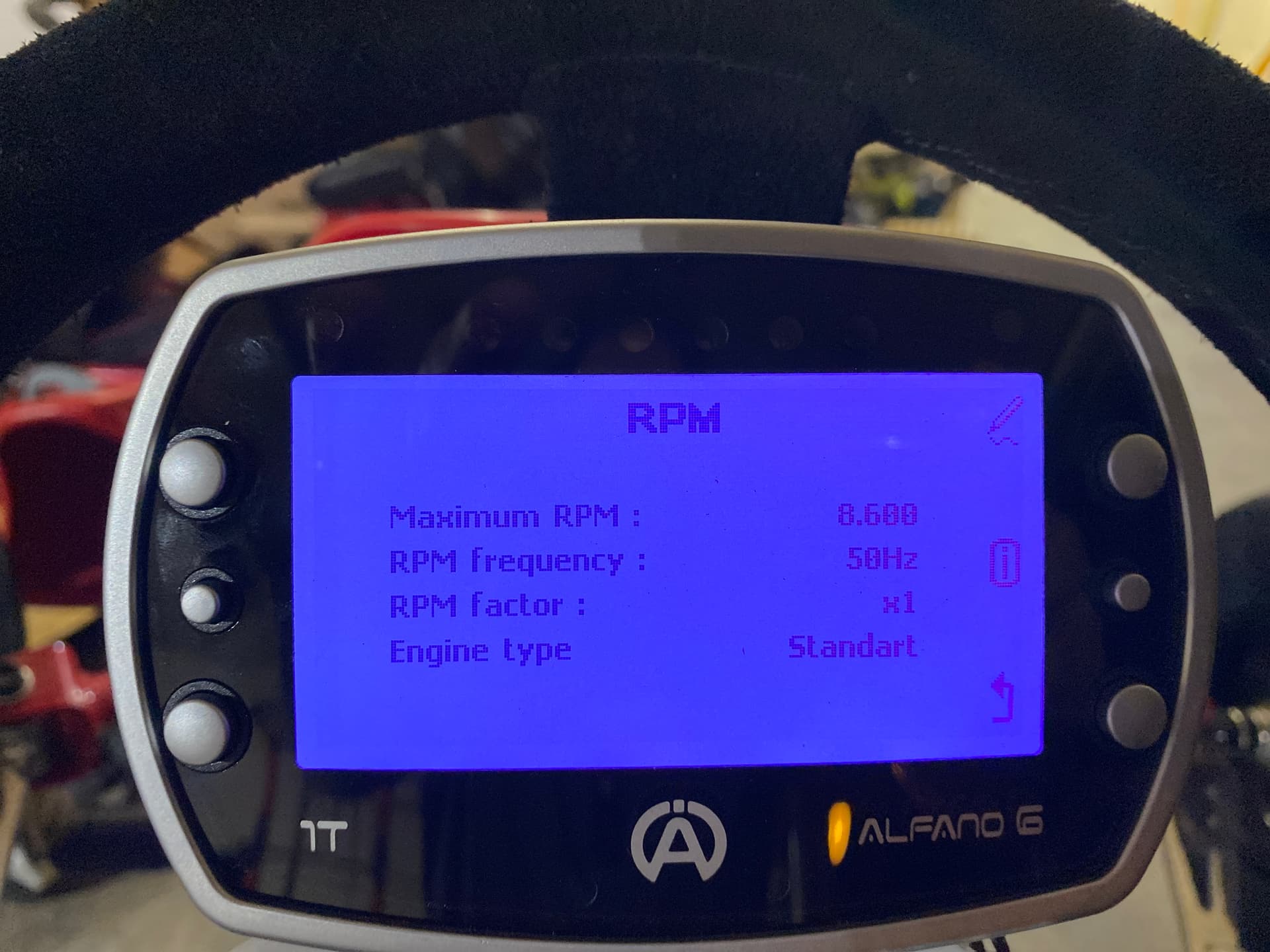

I had to check the settings off both Alfano’s (1T and 2T): Both set the same but with different Max RPM bands. (Lo206 and Iame)
I’d run them to show you the RPM’s but they are being stored. I know on one of mine the change wasn’t immediate, after reseting the inputs, on the stand it was still reading 1.6 RPM. But once I put in a few laps it changed to 1,600 RPM. I have no idea why the change wasn’t immediate?
But both karts say 1,600 RPM now, and this is what I have them set too. :+1:
Sorry about the second pic, that kart is on the bottom of the double stack and I couldn’t straighten the wheel for the photo.
