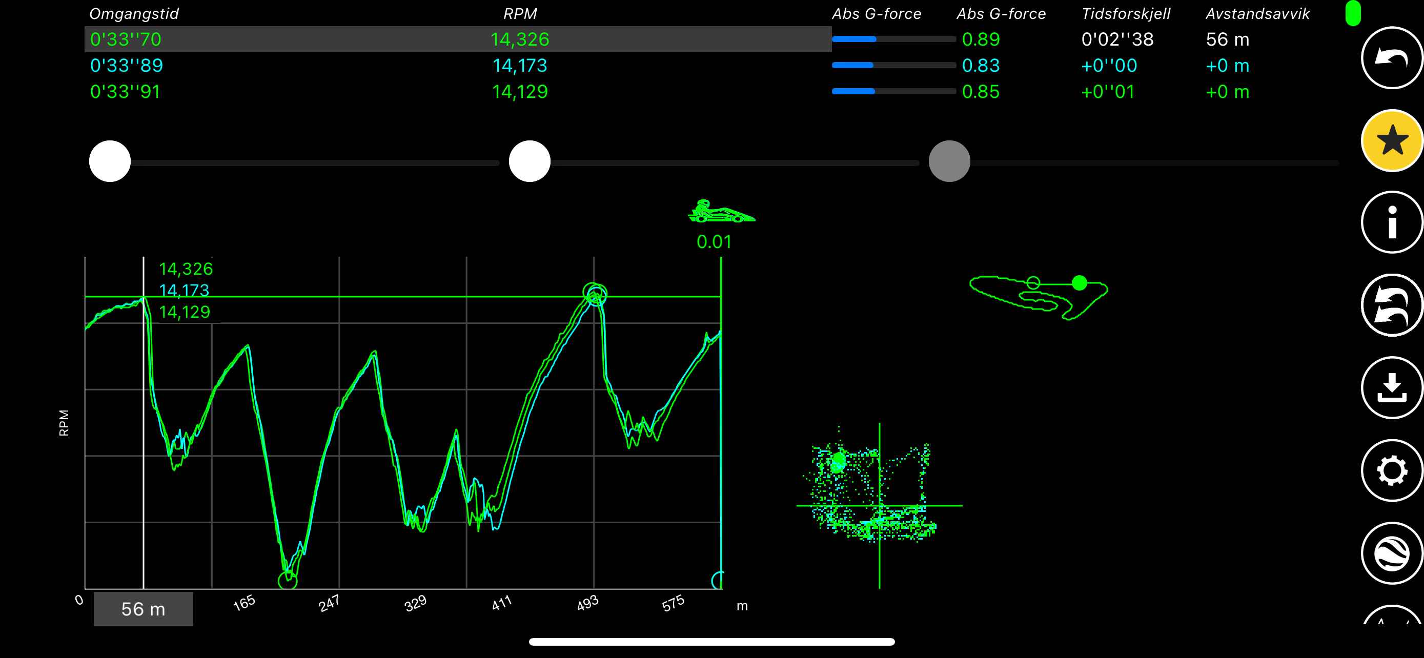

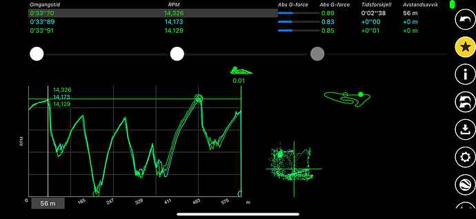

can this help?
Yes, that’s what I was looking for. Is this downhill or in a draft? Sure looks like your engine is actually going there.

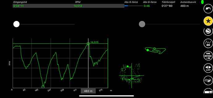

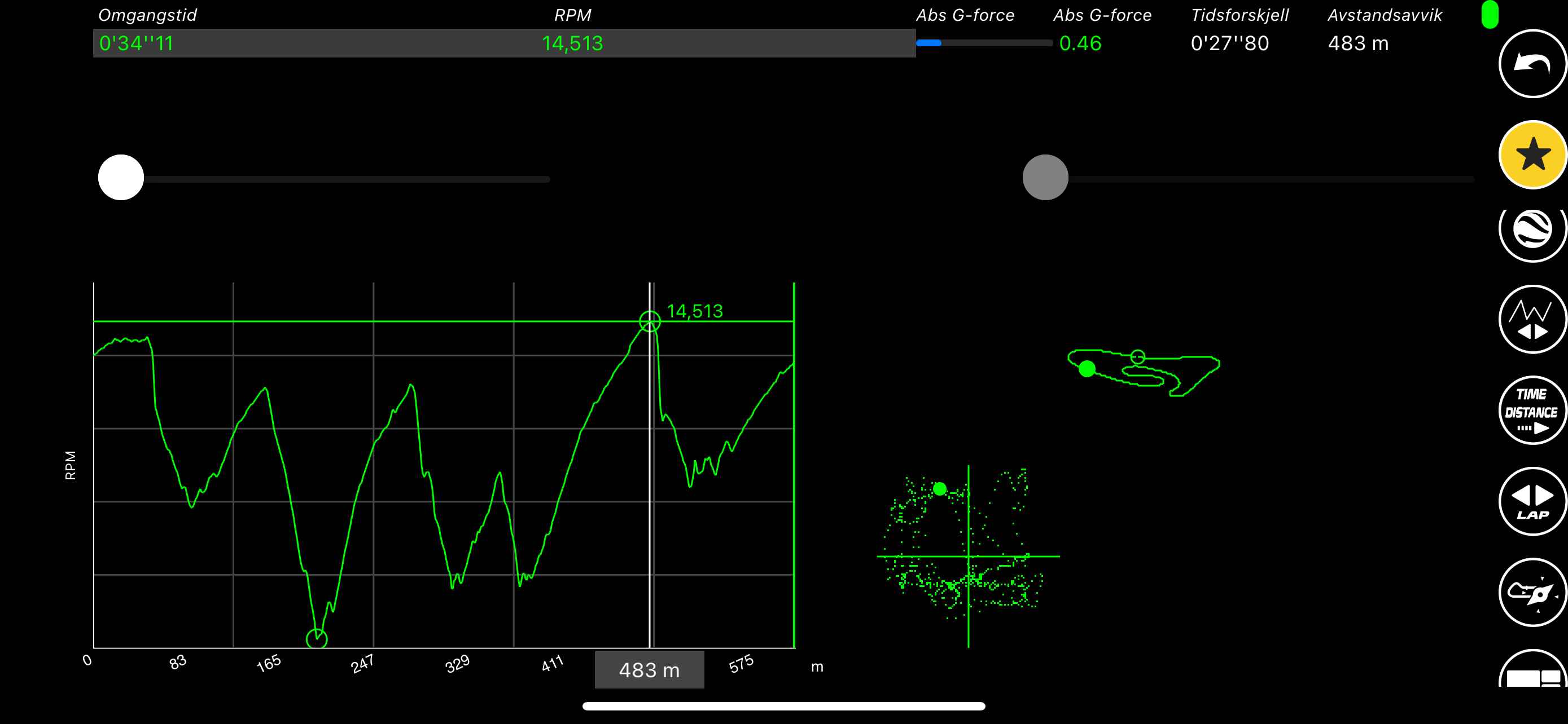

Yes, where I have placed the marker there is a slight downhill.
In this image, the marker is placed at a location that is uphill.
I think the data is correct.
