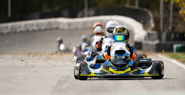

I was given the opportunity to drive one during a club race day at Atlanta Motorsports Park last fall when their mini traveling series thing was in town for the weekend. Overall I had fun with it, but there are a few points around the experience that are worth highlighting:
  1. They are HEAVY. And this is coming from someone who typically drives master shifter at 410+ lbs. We ran as a combined group of juniors and seniors without any minimum weight requirement so there was no additional ballast on the kart, and I’d reckon I was running at 420+ lbs easy. On one hand it seems rough from a competitive balance standpoint to not have a minimum weight, but on the other I think we’d be approaching issues with safety if they got any heavier, especially for junior drivers.
  2. We were running them with a relatively hard Vega Red tire compound. That combined with the weight meant there was quite a bit of slipping and sliding. I’m someone who enjoys being thrashed around and abused in a way that only comes from a soft tire, so this didn’t quite scratch that itch but it was still an interesting challenge wrangling that much weight with only so much grip available.
  3. It was rear brakes only, and with the weight and hard tire the main word that comes to mind is “sketchy.” It felt like trying to stop an outdoor rental kart that’s going twice as fast. I was able to more or less get used to it, but they definitely involve longer and more sustained braking than I’ve experienced before in a kart, and that whole time you’re just trying to modulate while feeling like you’re just not slowing down at all. Worth pointing out that they do offer a configuration with front brakes that also has a higher output motor which would probably feel a little more solid but that’s not what I drove.
  4. Obviously lots of torque on hand which is always fun. The throttle response (or rather accelerator response would be more accurate here?) felt a little funky - it was almost like the motor was just ever so slightly delayed from what I was expecting from my input on the pedal, and when you have that much torque with so little grip you want to be precise with your right foot and I always felt just slightly out of sync with the motor. I think there might be some mapping options available in the software, and either way it’s probably something I’d eventually get used to, but in one day I didn’t have the chance to get that deep into it.
  5. Maybe this is another obvious point but the lack of engine noise means you’re primarily treated to the sounds of wind, tires being tortured, and occasionally steel tubes grinding on asphalt. Once I got into the headspace where I was only focused on driving I didn’t even really think about it, but initially it was a slightly strange experience so still notable.
  6. Battery swaps and recharging seemed pretty straightforward. I’m not certain if I was on the same battery the whole day and they were just fast charging it between sessions or if they were swapping to a fresher battery after each run (I was still running my own kart and class that day so I wasn’t the one doing it, maybe they told me and I just forgot) but in all of our sessions I never noticed a drop in performance, granted we only ran maybe an 8 lap prefinal and 12 lap final. It did look like everyone there the day before was able to get plenty of seat time practicing so it seems to me like recharging and battery swapping isn’t a huge limitation.
In short, it was a fun experience even if it was VERY different from what I’m accustomed to. I’d be down to try one again, especially the higher output version with front brakes, though I’m not about to trade in my current kart for one anytime soon.

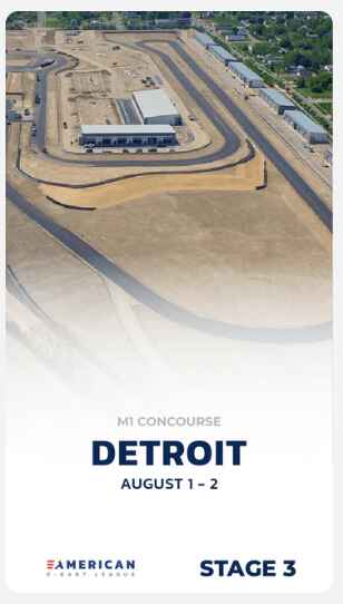

American E karting Championship Comin to M1 Concourse at Pontiac Michigan near Detroit.. August 1 - 2 2026 Go to Getshockt.com to find out more about the karts..
