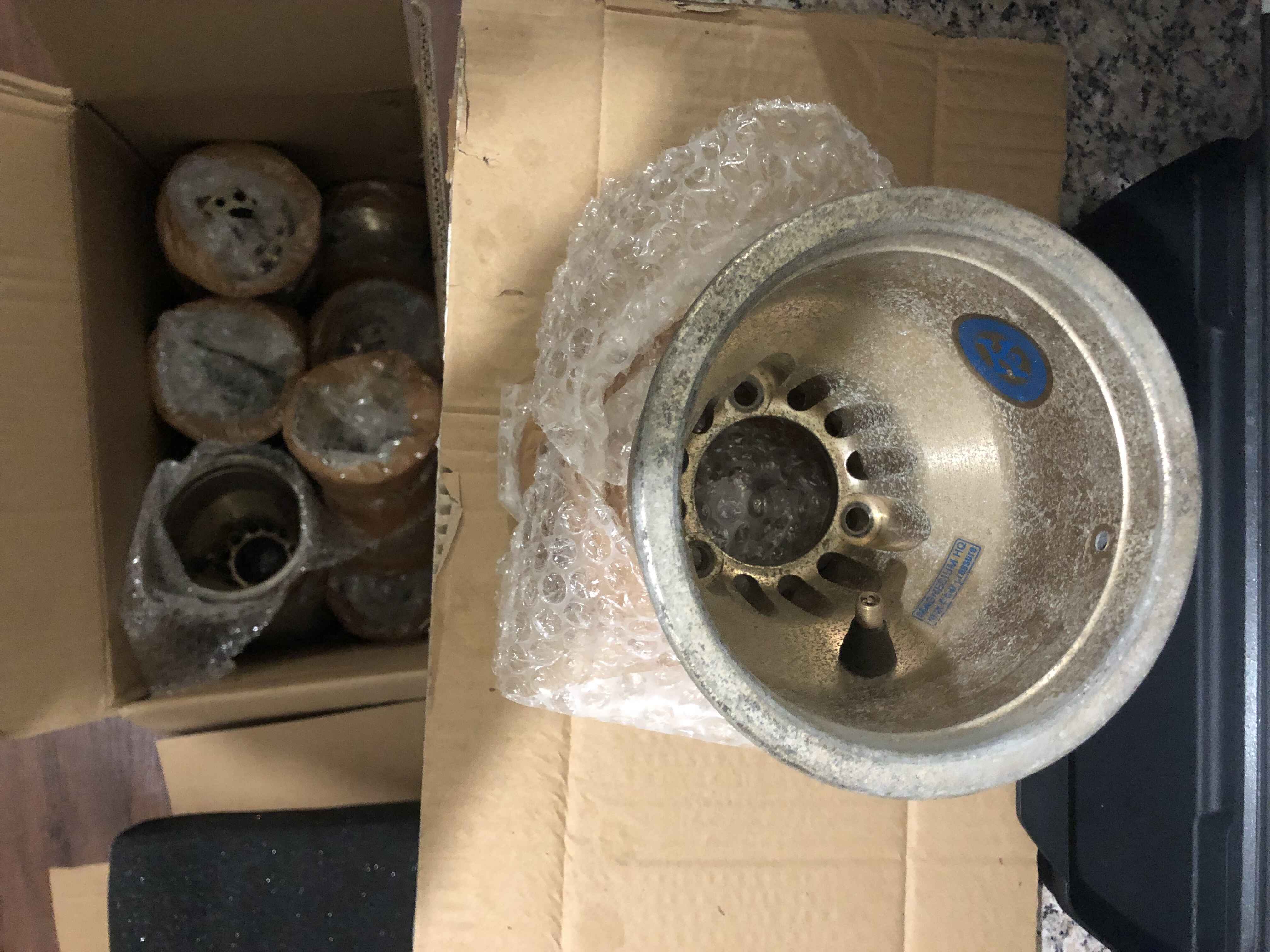

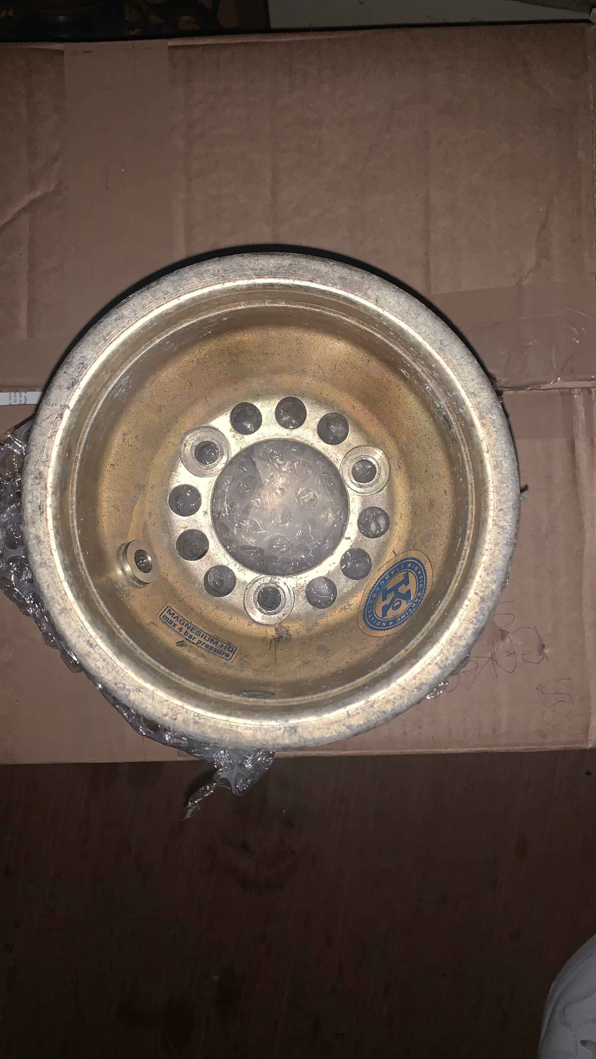

Do these look amv KR wheels? I had them for a while and i am not sure what they are for. Front and rears are the same 68mm pattern and they are magnesium
They look like 9F. The telltale sign for AMV wheels on KR is usually a big black label that indicates that they are AMV made specifically for Kart Republic.
The guys at AMV have told me that they don’t make 9F for KR, but you never know what happened in the past as a limited run or one off.
These are definitely odd rims, they are magnesium but are wet rims. Always thought the way to go with wet rims is aluminium. Is there a way to find out exactly what these rims are so that i can advertise them properly? Shame the rears are 68mm as i could make use of these rims on my crg chassis
I found the answer. It is not an AMV wheel. It is a “knock-off” that was made in Slovakia. It is actually 67mm and was made for Parolin.

Parolin markets a lot of their components under the “Eurostar” name, and I’ve seen some Parolin wheels labeled as such before. Could be worth a search.
Otherwise, they’re likely just a standard magnesium wheel with extra holes for cooling. Any other pertinent info would be just dimensions which you could measure.
Probably KKart or ElZet
Horrible finish on their magnesium stuff. Oxidizes in what seems like 5 seconds.
