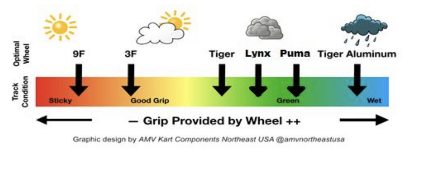

Looking into Tiger wheels for the lower grip tracks but I keep finishing conflicting info online… does this sound right?
Puma or Tiger for lower grip. We ran the Puma in Vegas and it worked great on the low grip parking lot track for the first couple days. However it started to overheat once a little rubber got put down and temps warmed up.
If it’s colder temps the Puma is great, otherwise the Tiger is a good standard set for low grip too.

I wanted to go with Lynx but info on their website is contradictory.
Also, the track test showed that Lynx provides more grip than Tiger.
“Though not ideal for these conditions (for our chassis/class), the Lynx wheels have some interesting characteristics vs. the rest of the AMV line:
Very positive and responsive front-end feel, shifting the balance of the handling more towards the front than with the Tiger.
Less overall grip than the Tiger, making it ideal for medium to high grip conditions
Lower air volume, creating less air pressure rise from beginning of session to end…”
So, where does it fits? Closer to 3F or closer to Puma?
The top one is correct according to Tommaso at AMV. I have not tested them back to back as running KA does not provide much of a need for either wheel.
You are right about the Lynx providing more front.
