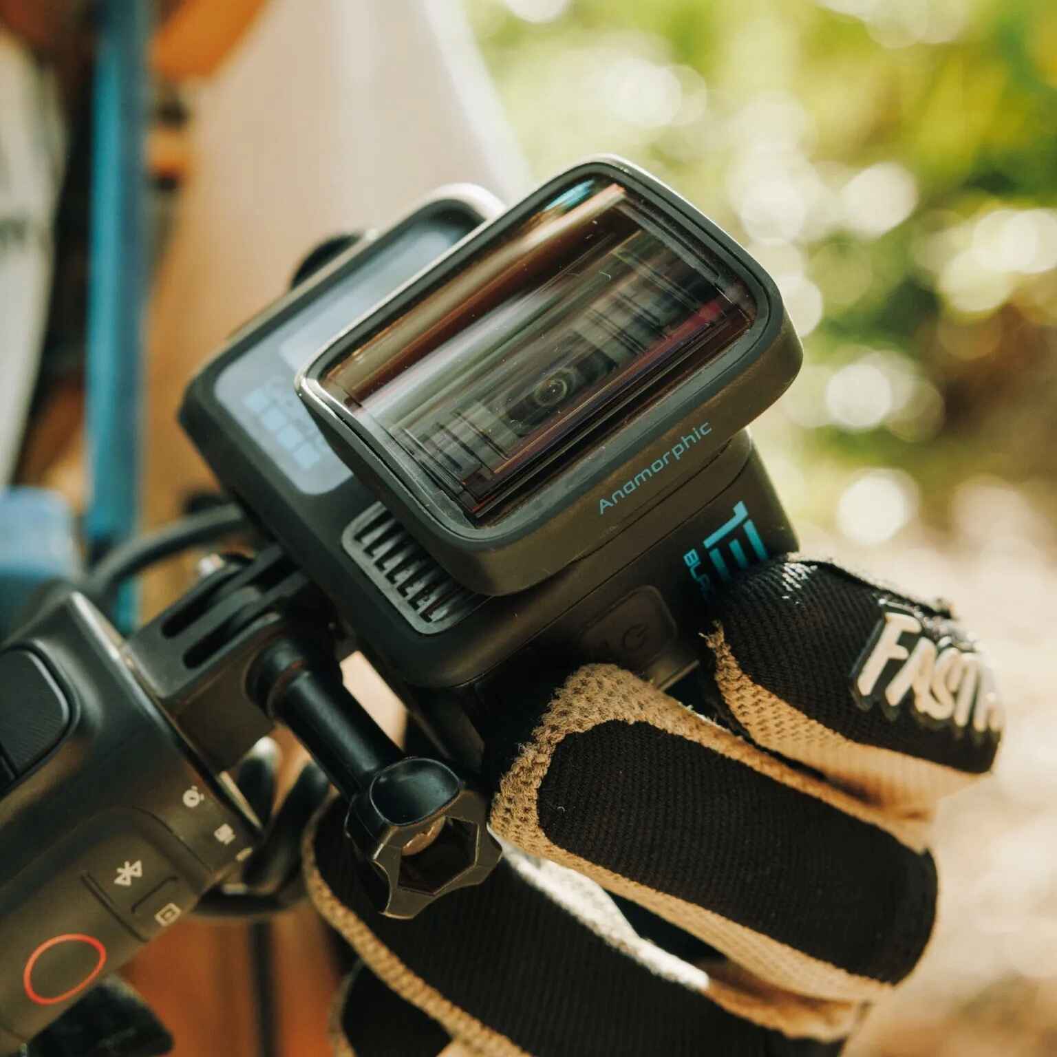

I personally am excited for the Anamorphic lens mod that will be released TBD for the hero 13. I want panavision + bokeh.

It has arrived!
https://gopro.com/en/us/shop/mounts-accessories/anamorphic-lens-mod/AEWAL-011.html
Now to wait for the Hero 13 to go on sale!
Stoked to see what the video on this looks like
I did see a negative review that suggests that the light sources tend to make horizontal prism lines
However…
I bet it will look very cool for my kart vids

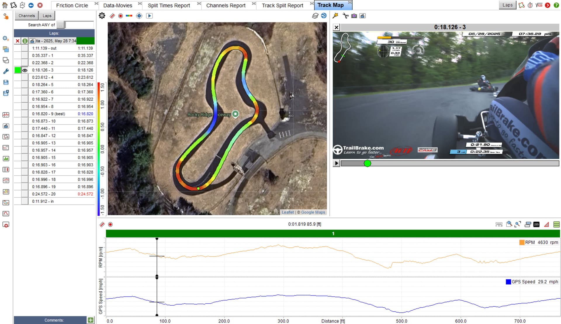

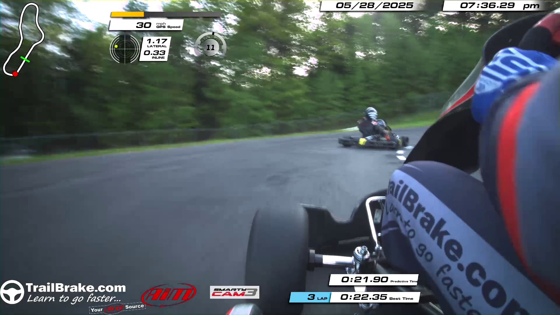

If folks have a MyChron, why don’t you go with a SmartyCam? The integrated data and analysis is worth the extra money IMHO. You also get all the data on the video, so you can see speed, RPM, G forces, predictive time, lap time, etc.
The first gen smarty cams were definitely behind the curve on video quality and digital stabilization compared to the GoPro. Fine for doing personal driving review, but definitely less impressive if you were looking to make clips to show your friends or generate promo material.
From what I’ve seen, they’ve gotten better, but are still paying catch up to get the ultra-smooth, great color footage that GoPro has
Like Elliot said, I think a lot of people were turned off by having to pay a lot of money for the SmartyCam, but it was a crap camera. After that I guess I’ve never taken a serious look at them again as an option.
I should look again for my son as the data overlay would be nice. For myself when I’m pulling data it’s typically to compare to my brother so SmartyCam has less value there.

And yeah, despite the awesomeness of the data integration of the smarty cam, the actual camera is hot garbage for the money. Way way way behind the curve.
