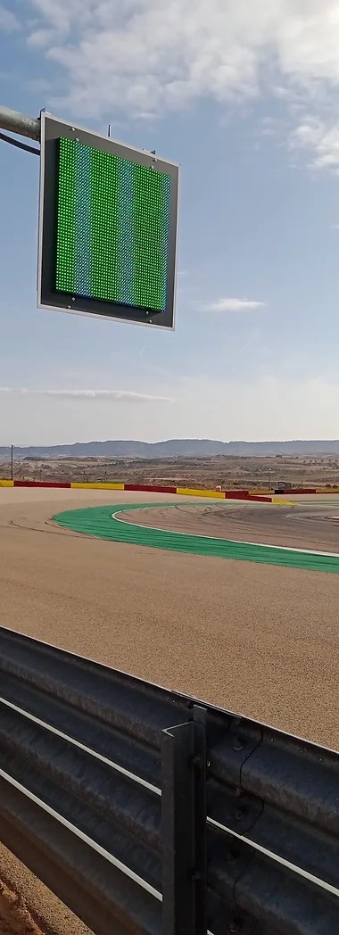

Here’s a pic of what I normally think of when I hear about these systems. (From the website of Jackson company).
We utilize the PixelCom System at FIA Karting International level, on each marshal post. They are powered by 12v portable batteries, exactly the same as the ones used in X30 / RoK and are remote control operated.
All modules are synched between them and are both able to automatically cascade (ergo: Upon the activation of a yellow flag at Marshal Post 5, Marshall Post 6 would automatically light green) and can be controlled in unison by a master remote, held by the Race Director.
