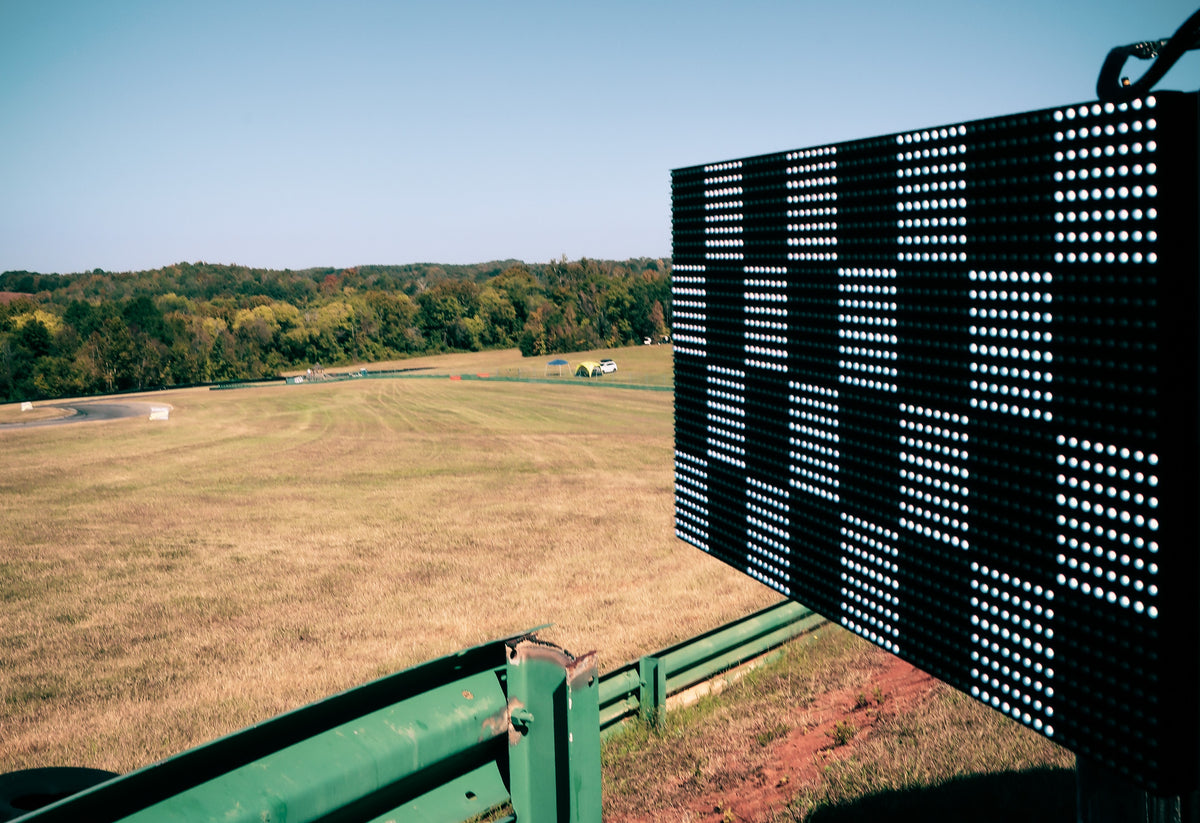

I can only vouch for the system we use, but it’s quite incredible how bright the LEDs are, even in July - 12PM - Middle of the day - full sunshine situation. It’s almost impossible to stare at the panel directly from up close, while it’s flashing, as it hurts.

We use this system, which we bring with us to all the events we organize and run
I believe the Pixelcom system that Simone mentions is the same one that Jackson represents with Track Systems NA.
I’ve mentioned it before, but having raced in a series (Stars Championship Series) that utilizes this system, it’s hands down better than old school flags in every way.

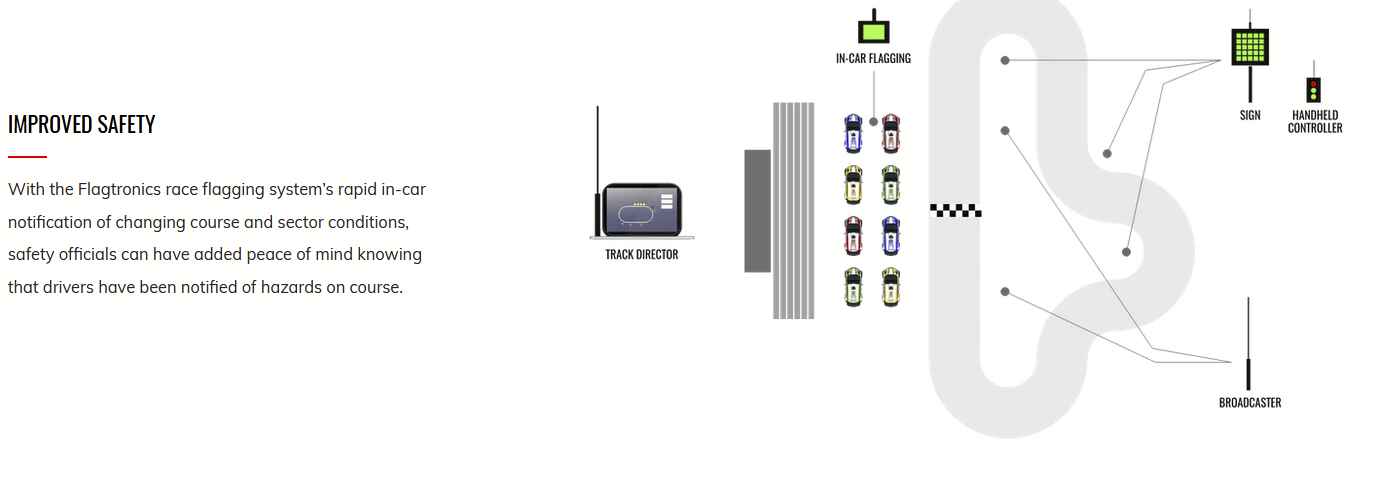

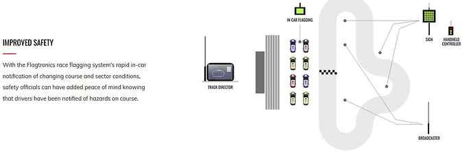

Encountered this system from a US company called FlagTronics today. Our ice racing club up here have bought a system, so I guess that means it works well in cold conditions…
The system has an onboard option too. Would need a power source on a kart of course, but I can’t see the requirements being super high. I always dig price transparency too.
