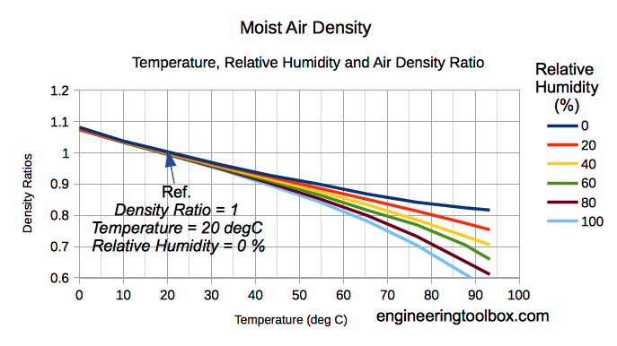

That’s what set this off. My last race felt good, pace was good, but times and top speeds were off relative to dryer conditions. The weather was the dominant thing, so I was trying to understand if humid day equals less top end. My top speed into t1 was 46-47mph versus 48-52. Yet my pace relative to field was good. I wasn’t getting walked in straights at all.
The chart I posted above is my initial answer to “what difference does RH make?”. At 40C, there’s only a 5% swing on air density, so at first blush, a 5% reduction in power would drop a theoretical top speed of 50mph to 49mph. A drop of 50mph to 46.5 (average to average) would take a 20% power loss.
Looking deeper into it, lower air density also reduces drag, but that’s a linear change whereas power and top speed are cubic, so I think we can ignore that. This tell me that something else has changed, OR there is some compound effect. For example, a 5% change in O2 content might cause a 20% power drop if the engine is just hyper-sensitive to fueling. With my limited exposure (206 and C51), neither of those engines are anywhere that sensitive. I don’t know what you are running. I also don’t know the track - could it simply be that there was less rubber down on the penultimate corner, and this lead to the 2mph drop?

I was wondering if the generally wet air would also make things slower. I suppose the answer is yes but it’s not that significant.
