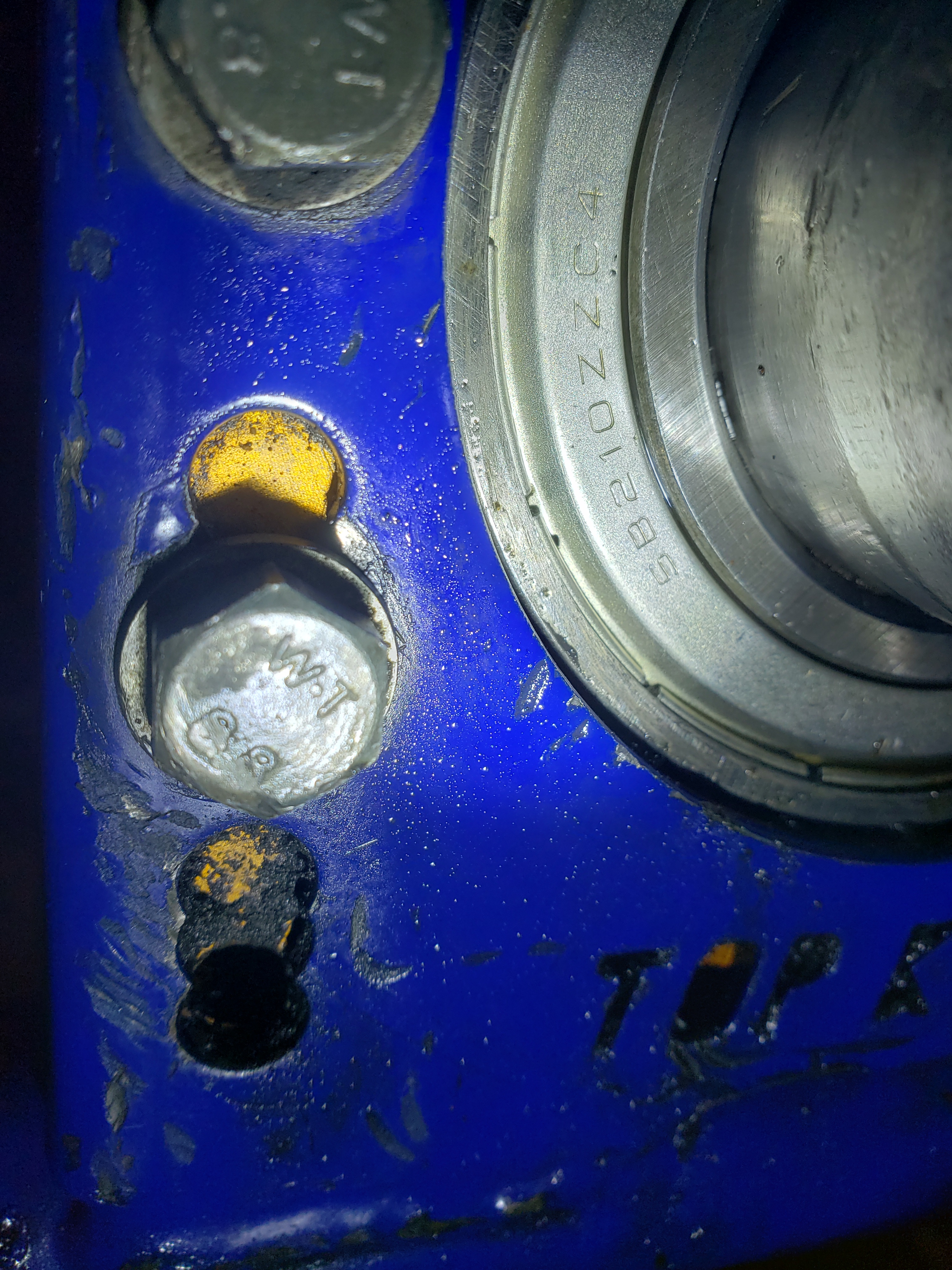

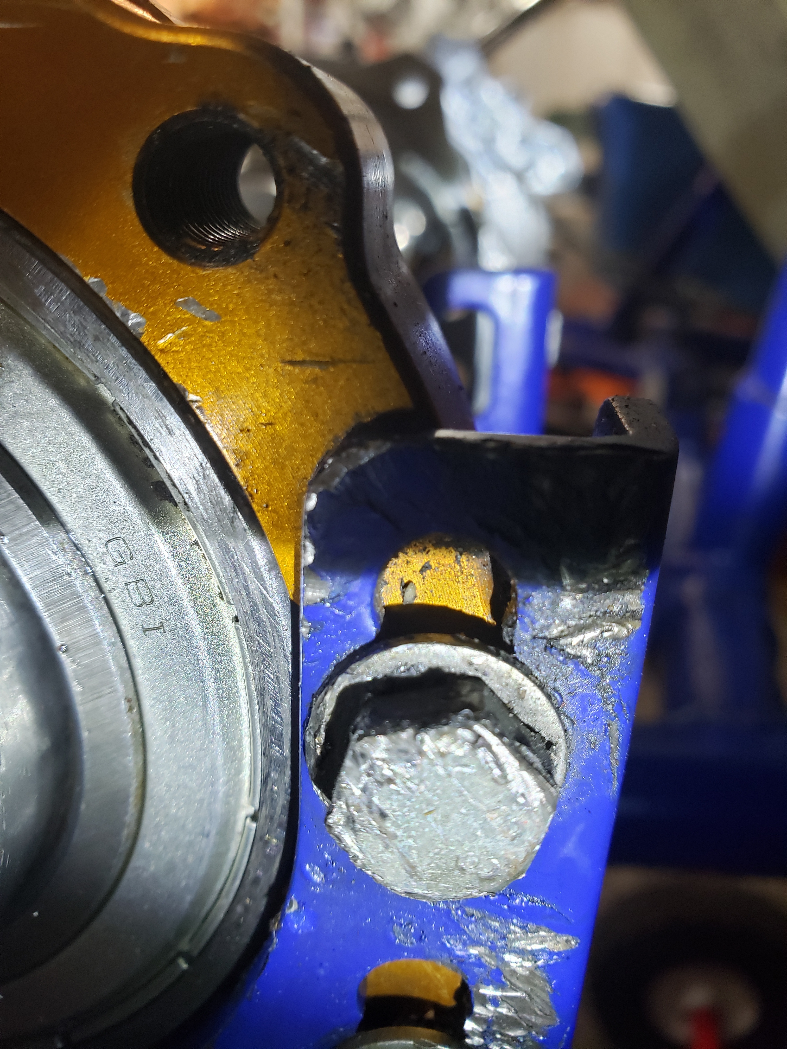

I have two questions. We have recently acquired a second additional kart. This new kart has rear 50mm axle bearings that seems to be very spinny and when you turn the axle they spin really well. The bearing has the number 58210ZZC4 on one side and GBI on the other. I’m liking this bearing and was looking to see where I could find them?

It’s actually a SB210ZZ and C4 is the internal clearance. You will notice that the shield doesn’t contact the inner raceway which makes the bearing free spinning. Give your new ones a good spray between shield and raceway with a good lubricant and they should free up with more use.

The Bearing Number is SB 210 ZZ Made by GBI

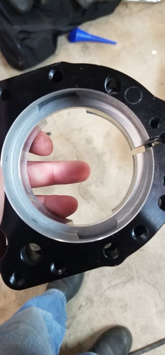

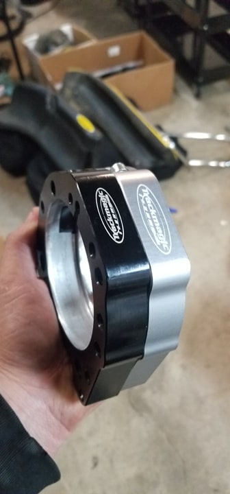

Phillipe Kunos, you do need to be aware that 50mm bearings do come in a few different sizes. The most common are 80 and 90mm O.D. with slightly varying widths of both the bearing and collet width. I suggest measuring the bearing OD and generally the widths will not effect the performance.
Also, the GBI bearing is a decent bearing but I have not seen them since 2011ish but are very common on karts though both the 210 and 210/208 models (90mm and 80mm O.D. respectively)
Here is a picture of the different carriers and how you could at one point get both 80mm or 90mm in the same model year so you got to really just measure.
