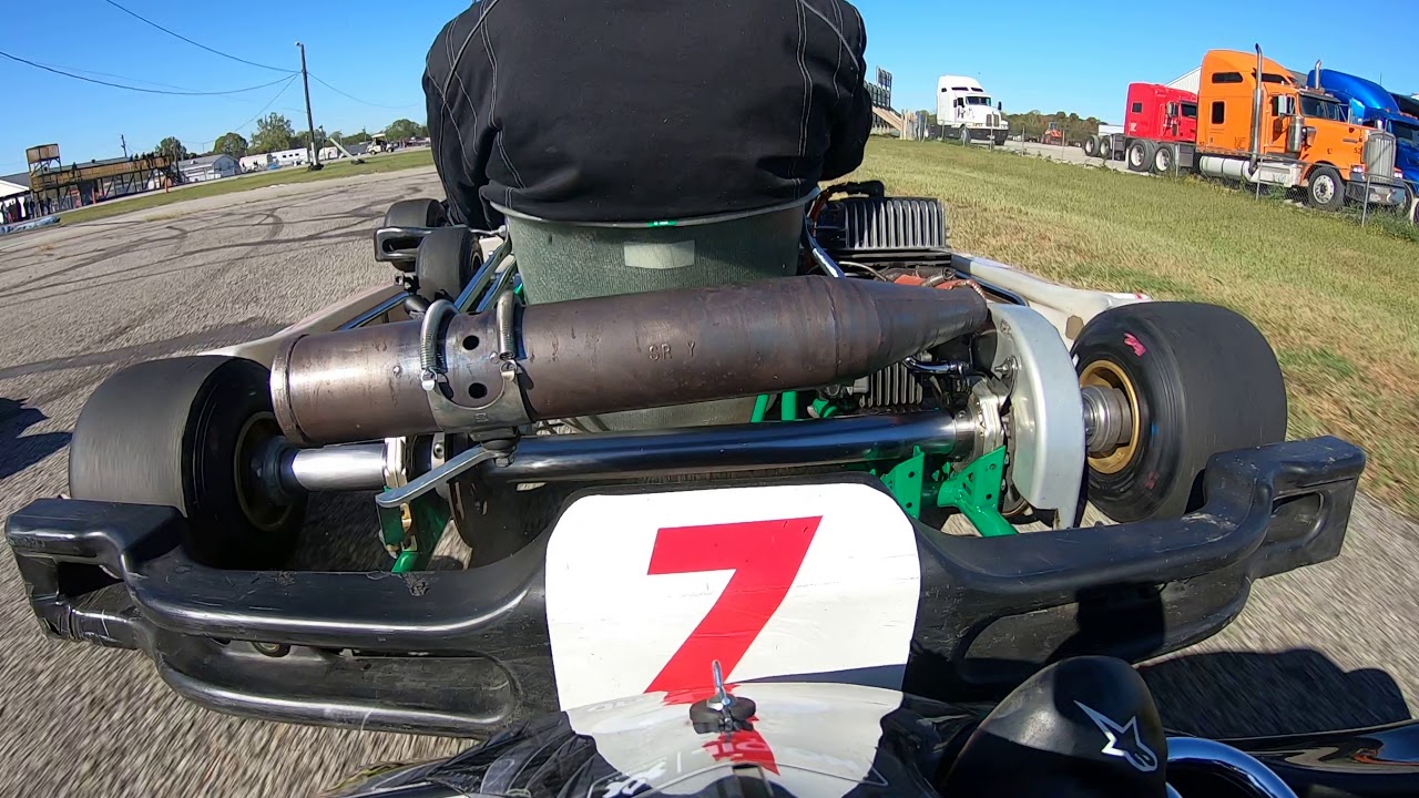

I can do one better, we usually run with Yamaha legacy pipe now. The 420cc karts are at minimum 460lbs about 100lbs over Yamaha. This video is a few years back running against the always fast Andy Kutscher and Chris Kutscher.
These are small camshaft, stock ports, stock carb slightly bored, stock piston, stock flywheel and on 91 octane… 420cc 7 bolt engines. A good 460cc makes upwards of 50hp on Alcohol, these only make about 22hp.

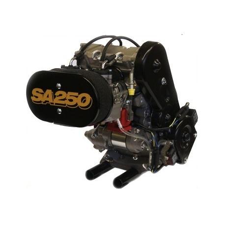

Not all 4 strokes are dead slow , i had always an open eye for the biland 250 .
I i think it was and maybe still is imported in the united states .
