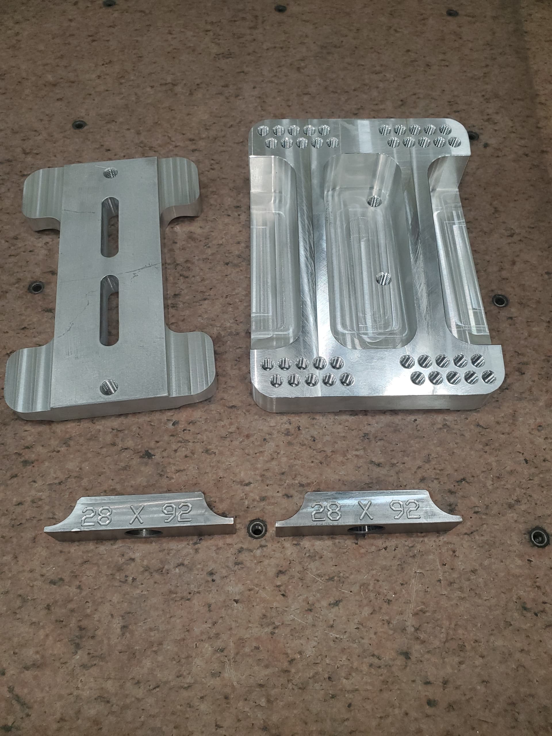

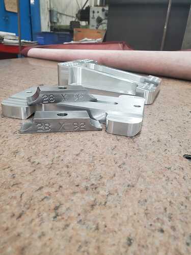

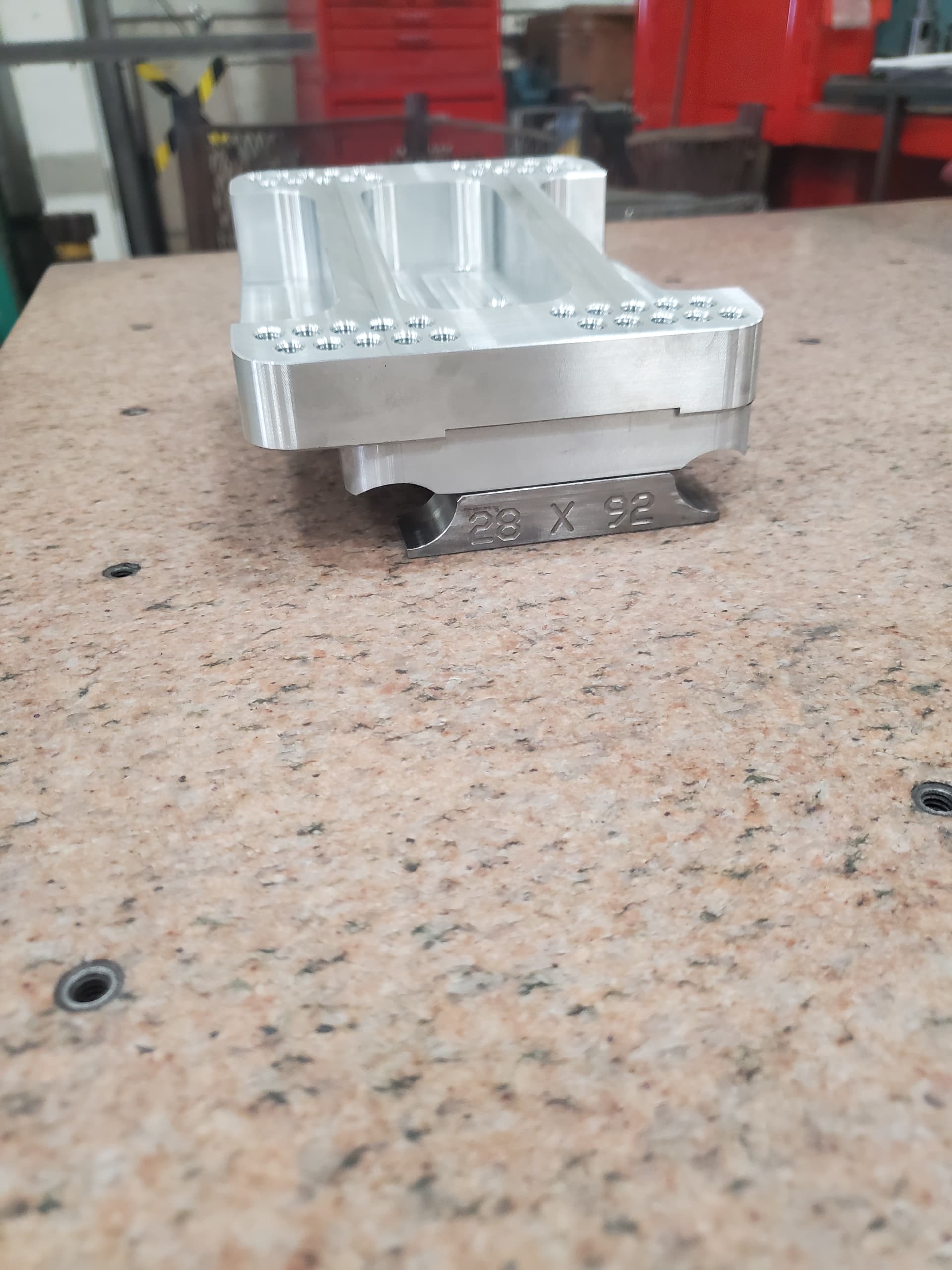

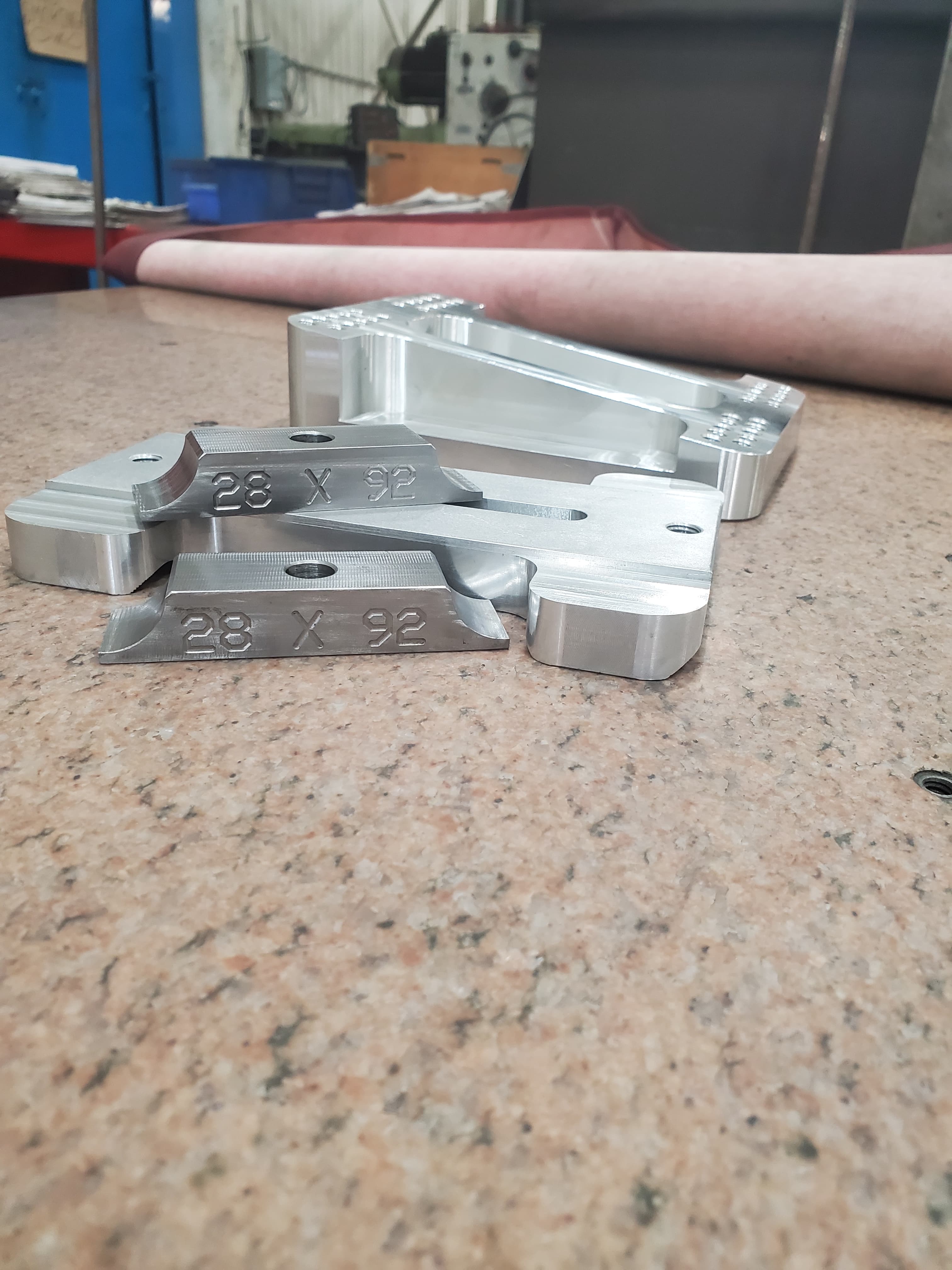

New mount all done, gotta pick up the hardware I ordered from the fastener store tomorrow.
I applaud your skills, but this is just a direct copy of the odenthal design, correct? Any personal touches and/or improvements?
Yep pretty much an Odenthal knock off, unashamedly at that. I see this as Revision level 0, get something assembled and on the kart and then I can start figuring out what I like and dislike about it and go from there. I’d like to figure out a way to do all the tension adjustments from the topside and possibly incorporate a fine adjustment to it, rather than just shove it forward and crank it down.
Makes sense. Good luck. Interested to see what you come up with.
Very impressive. I love to see someone tinker with making something on their own. Looks beautiful.
This is milled from a block of aluminum, yes?.
Very gratifying to see and do, I am sure.
Yes, 3/4" aluminum plate for the base and a 2" thick billet for the top plate.
