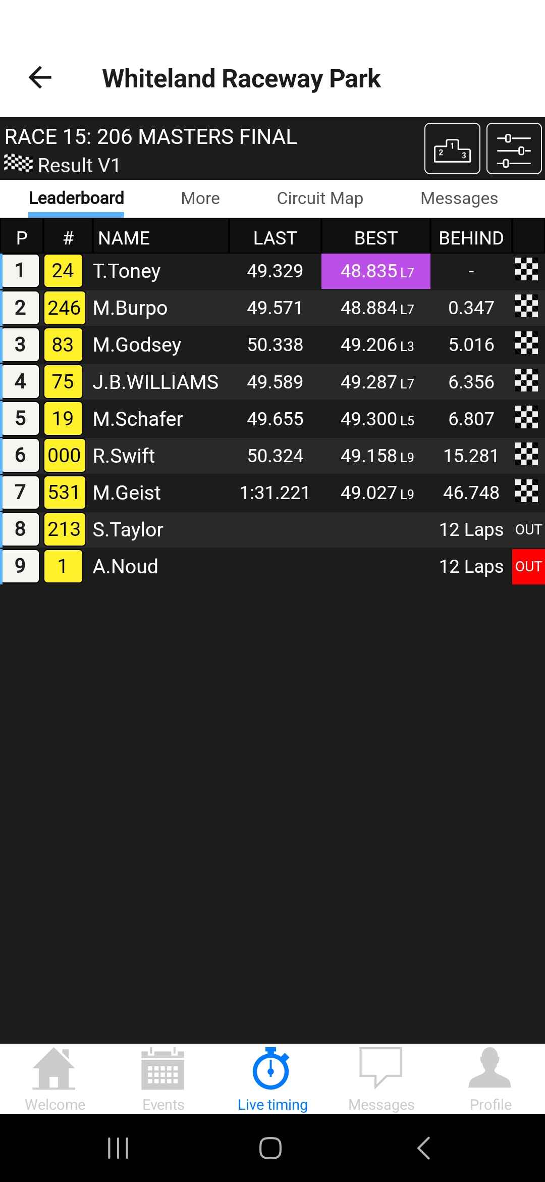

I think the Birel RY30 is pretty good… First race I ran at WRP this year, third overall race this year, chassis fresh out the box… Came across at 396#.
Caveat to this is the chassis with 3" of fuel in the tank was 171 with no lead.
