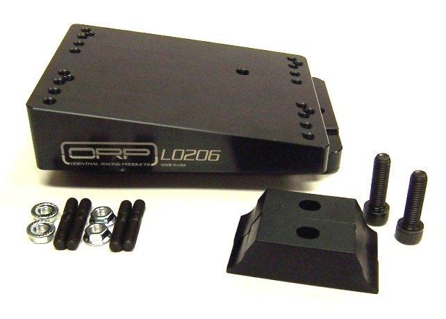

I love my 4 stroke ordenthal. I have used it on an older birel and now on my new atomica. Plenty of adjustability. And super easy changes and chain adjustments.

I second Odenthal. I have not had a mount from them I did not like. It allows engine adjustment and removal without loosening frame clamps. Saves frame in the end. I have not tried JDC

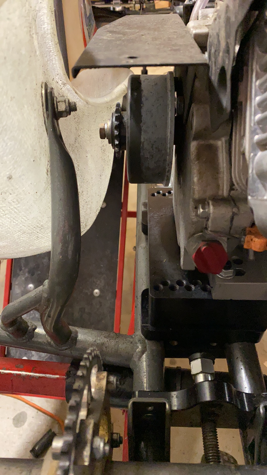

Euro chassis here. This was with my birel offset. As you can see I was able to move to the left another inch or so and still have plenty of room.
Thanks for the visual, I am trying to run the clutch inboard as well. so that I can run the engine more under the frame and balance the go kart better.
Important to realize that running clutch inboard or outboard doesn’t really change where the lateral offset is, as the end of the crankshaft will still be the same distance from the seat either way. Running inboard seems to be “in” lately, but all it really can affect is where you put the rear sprocket carrier.

It is not necessarily the crank end position which is critical, turning the clutch round can alter lateral clearance at the drum o/d by 3/4 inch or more.
@d-i-y80 correct, yes on your definition - ‘inboard’ means closest to the crank case, ‘outboard’ is closest to center line of kart.
The end position of the crank is indeed crucial, as it can only move so far left (if viewed from rear of kart) before interfering with the right seat support or side of seat. Yes, you are also correct, swapping the orientation of the clutch allows you to adjust the sprocket hub on the axle, depending on your particular chassis, and where it needs to sit on the axle for proper chain alignment.
