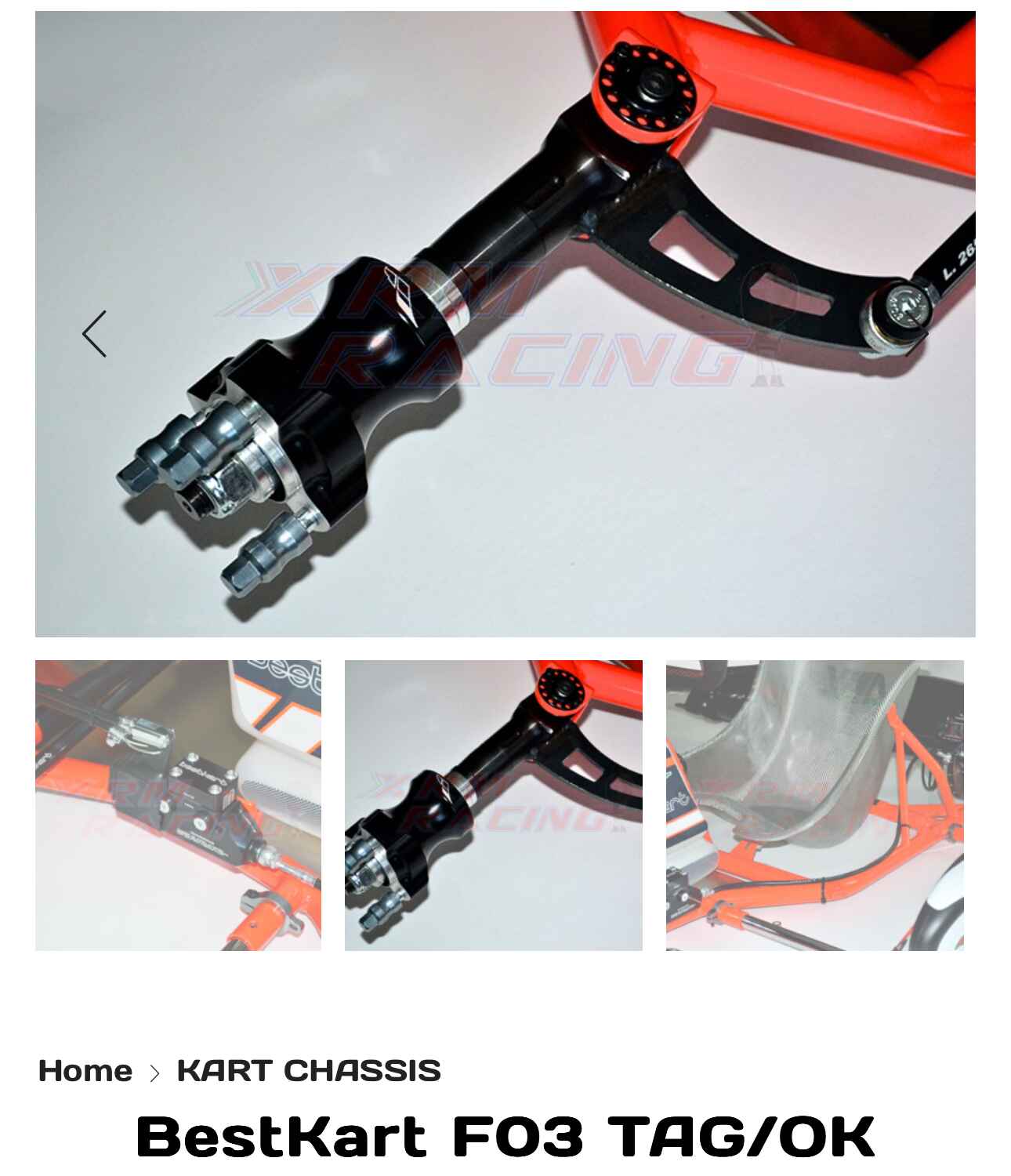

Also on Ackermann. If you are your only option is taking some out I would think it would just make the problem worse. You would have less jacking per steering angle so more of the rears in contact with the ground pushing the fronts. So in my head you would want to add some. Looks like you only have the two options if this picture I found is accurate. Sorry for the wall of text.

I had more Ackermann to add if I wanted.
