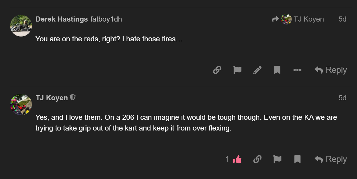

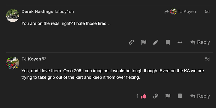

This did not age well :wink: Updated opinion?
One bad date doesn’t sink a relationship Derek. :joy:
This particular set seems to have had a bad weekend, but now that I know that you can destroy these tires by overdriving or overheating them too much, I just have to keep an eye on that and maybe I’ll finally put batteries in my temp gun that’s dead in my toolbag.
Also, I had no issues like this for the entire season. I think part of the equation is the track layout at Trackhouse, which is mostly fast corners and mostly right-handers, so there is a lot of load going into the tires if you aren’t careful about managing them. Particularly turn 4 which is now a super-fast bowl that you cruise around at nearly max speed with all the grip that’s been laid down. That surely is torture for the left front. And given that I generally am hard on front tires, I think I probably need to adjust my driving style a bit to prevent that from happening in the future.
