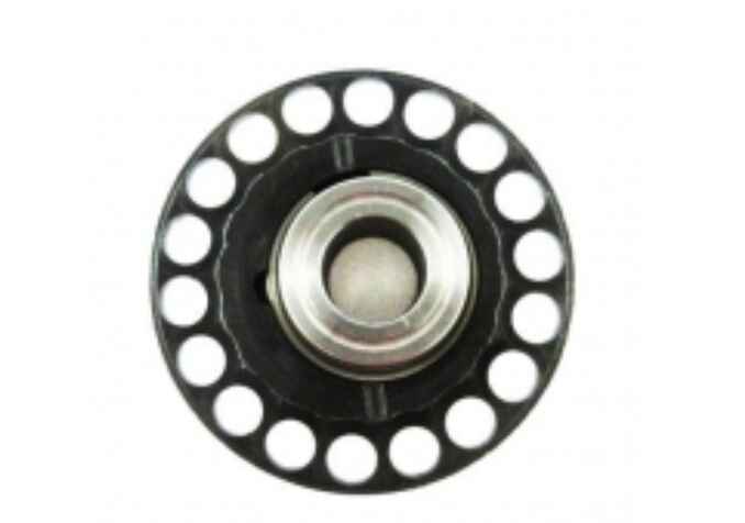

Is the top one a 0,5 or 1,5 ecentric?
If its a 0.5 you Can just change it out with a 1.5,
Birel/freeline have those two options availible, i think compkart have a few other options then that.
I’m not sure, are they marked somewhere? I don’t see anything indicating what degree of caster they are.
They are not marked, but you Can see the difference, will take some pictures later
theres a really tiny dot right on the edge closest to the kingpin on the birels
So the dot denotes the pill size, for caster?
There’s a .5 and a 1.5 degree eccentric available. They’re very distinct from each other visually.
Screenshot_20240621_211907_Chrome
Screenshot_20240621_211923_Chrome
Looks like I have the 0.5, which is probably the original to the kart. Thanks for all the help, folks!!
