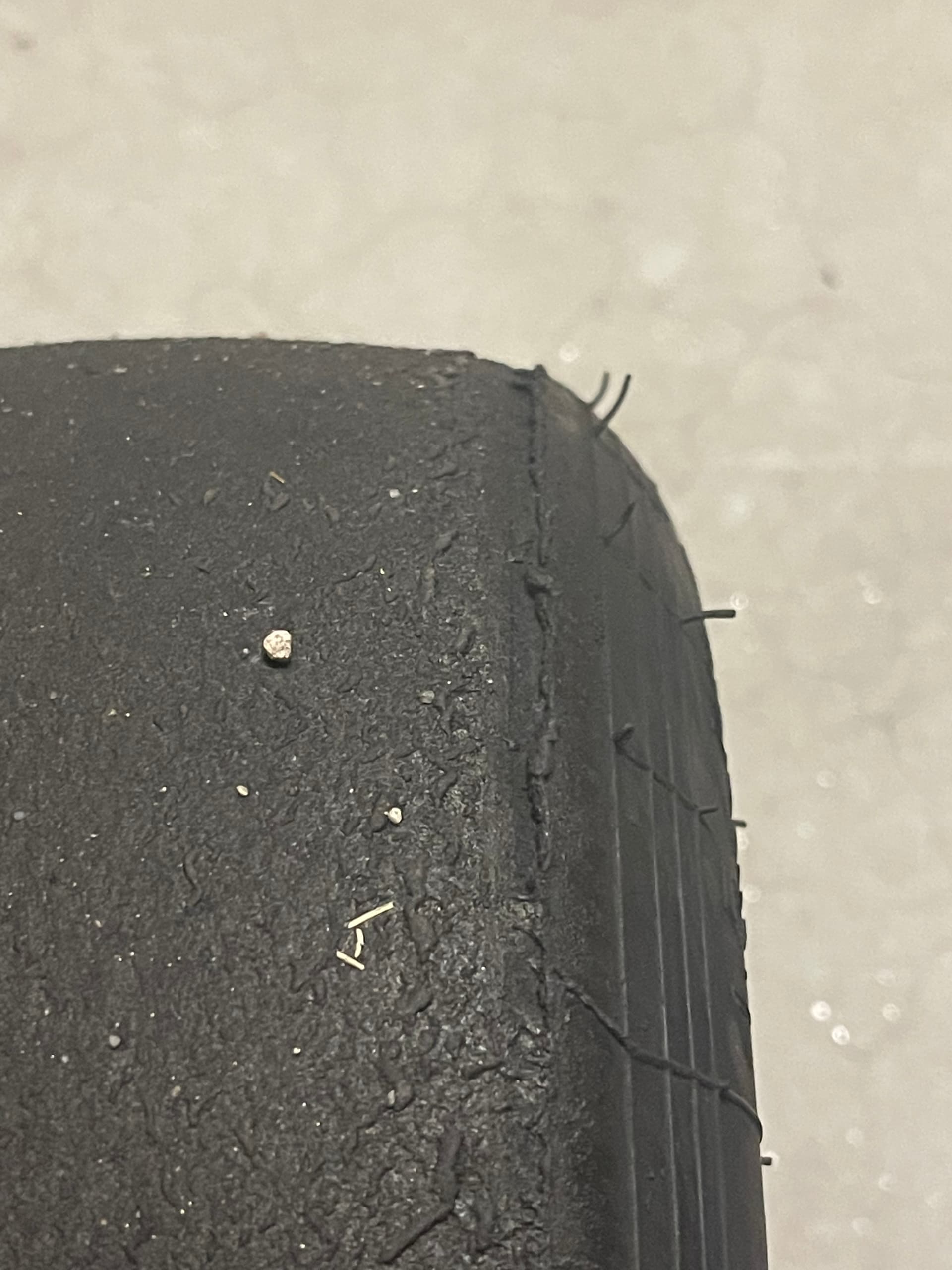

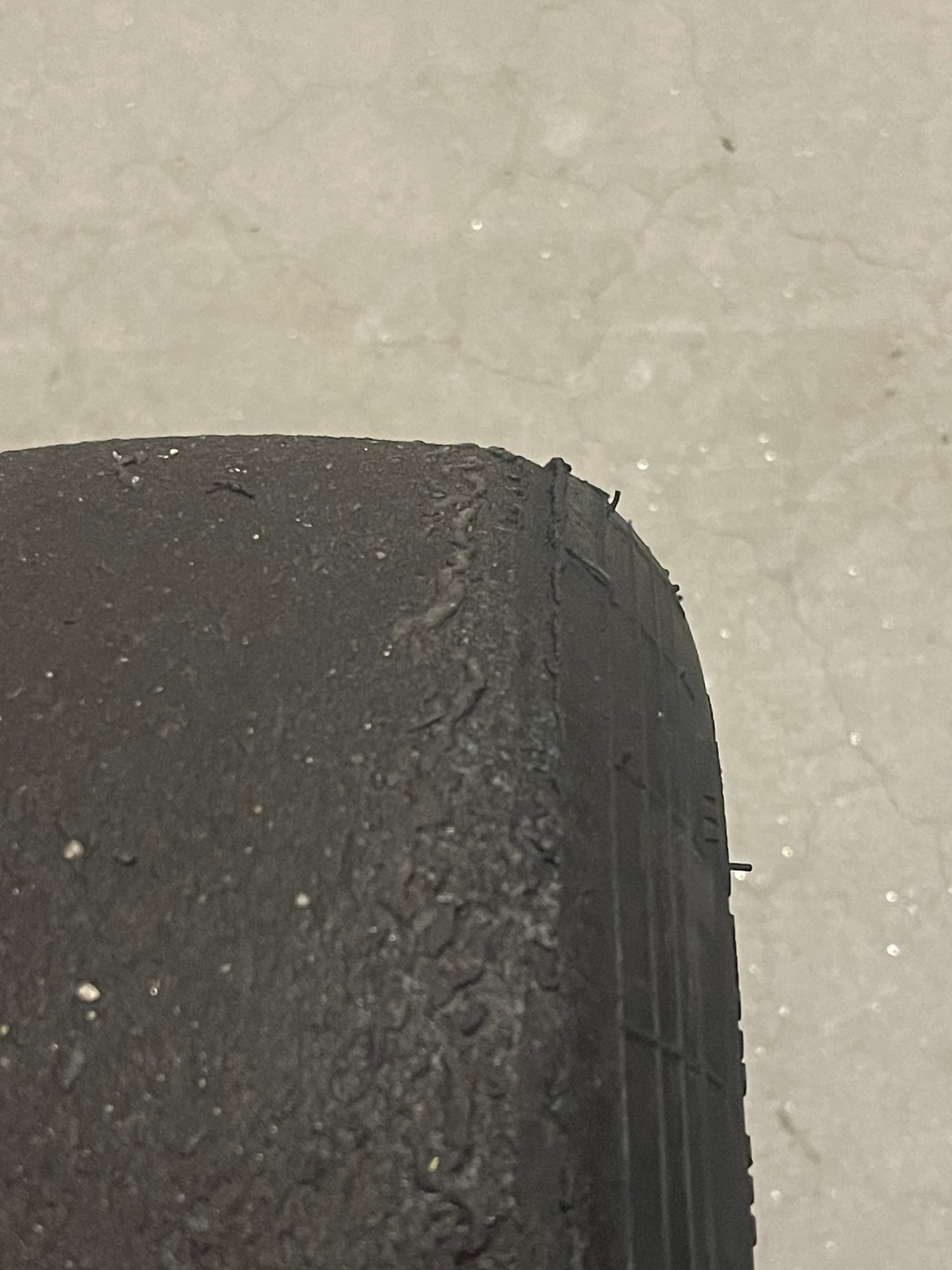

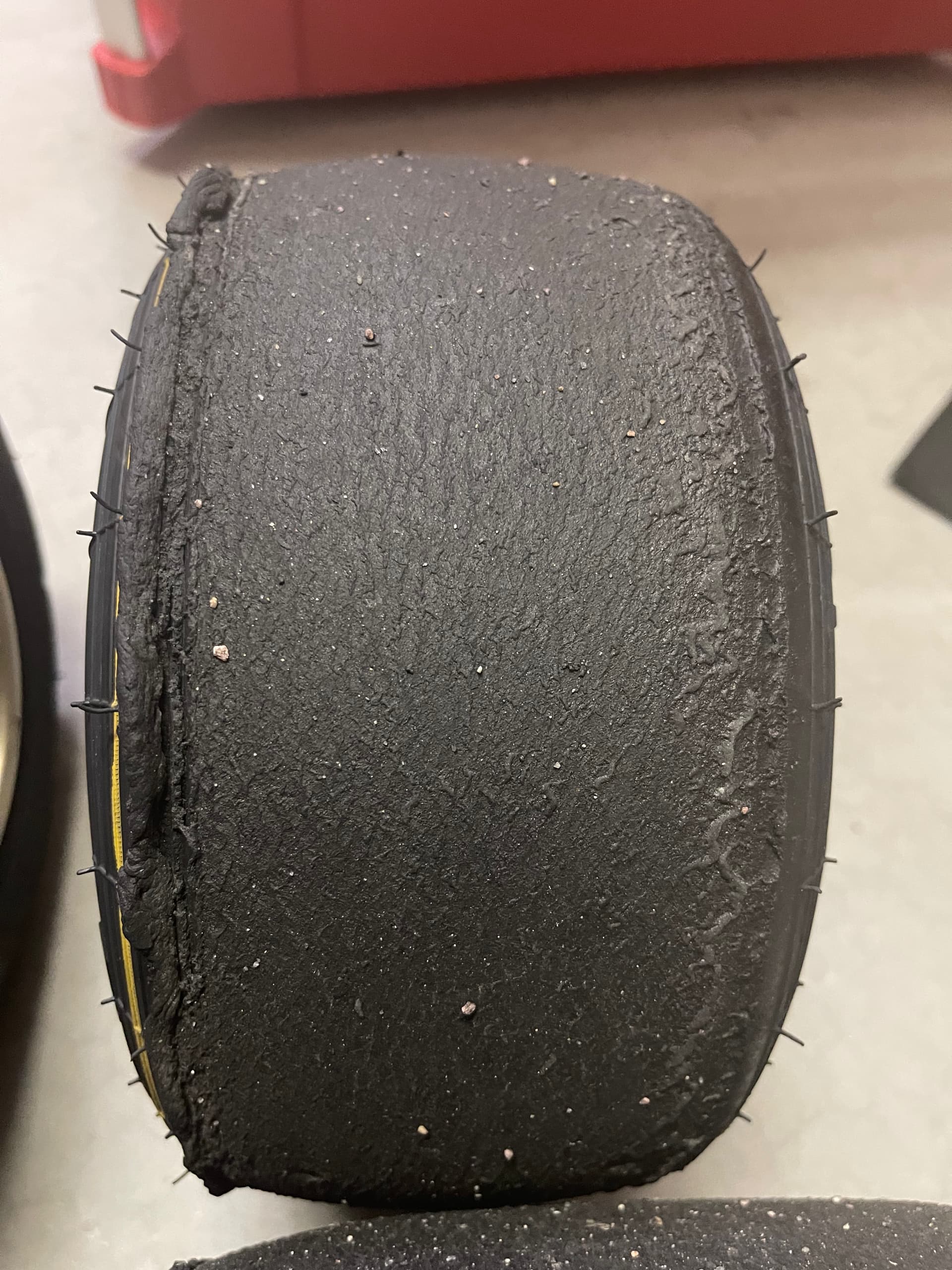

Here is some wear on a new set of tires with maybe 30-40 laps. The first inside 2” is getting destroyed and heavy feathering in the first 4”. I was trying to keep the tires cool and stopping in the pits every 7-8 laps. It seems interesting to me where there is a very defined start/stop of the strip of heavy feathering.
I think I’m going to try longer rear hubs to keep the tire flatter. Also my other suspicions are that I’m too low on pressures and really overworking where the tread meets the side wall. Tire might be over flexing and friction is killing the inner edge.
As suggested in this thread; Have you tried flipping every 15 or 20 laps? If I remember Mojos were tough to dismount and mount, so that might not be fun. Is there a drop off in lap time over the 8 or so laps? Although, it seems obvious, measuring tire temps might help get some insight.

@KeslerDesignWorks have you looked at other drivers’ tires in your class? Is their wear similar?
I’ve thought about buying the IR temp sensors. My engi-nerd brain really wants that data. Not sure I’m at that skill level yet where that information will be valuable. Also it’s usually be obvious if the tires are in that window due to feel and look of the tread. Certainly would make getting tires in the temp windows much easier. Run it for practice, set pressures, and not have to play the guessing games.
I’d say wear is somewhat similar to others under the tent from a couple weeks ago. I’m definitely wearing the inner edge more than others and a bit more feathering. So I know I’m sliding the rears a bit more than other drivers. So working on that combo of setup and driving. But these past couple practice days back at my home track has really exaggerated the wear.

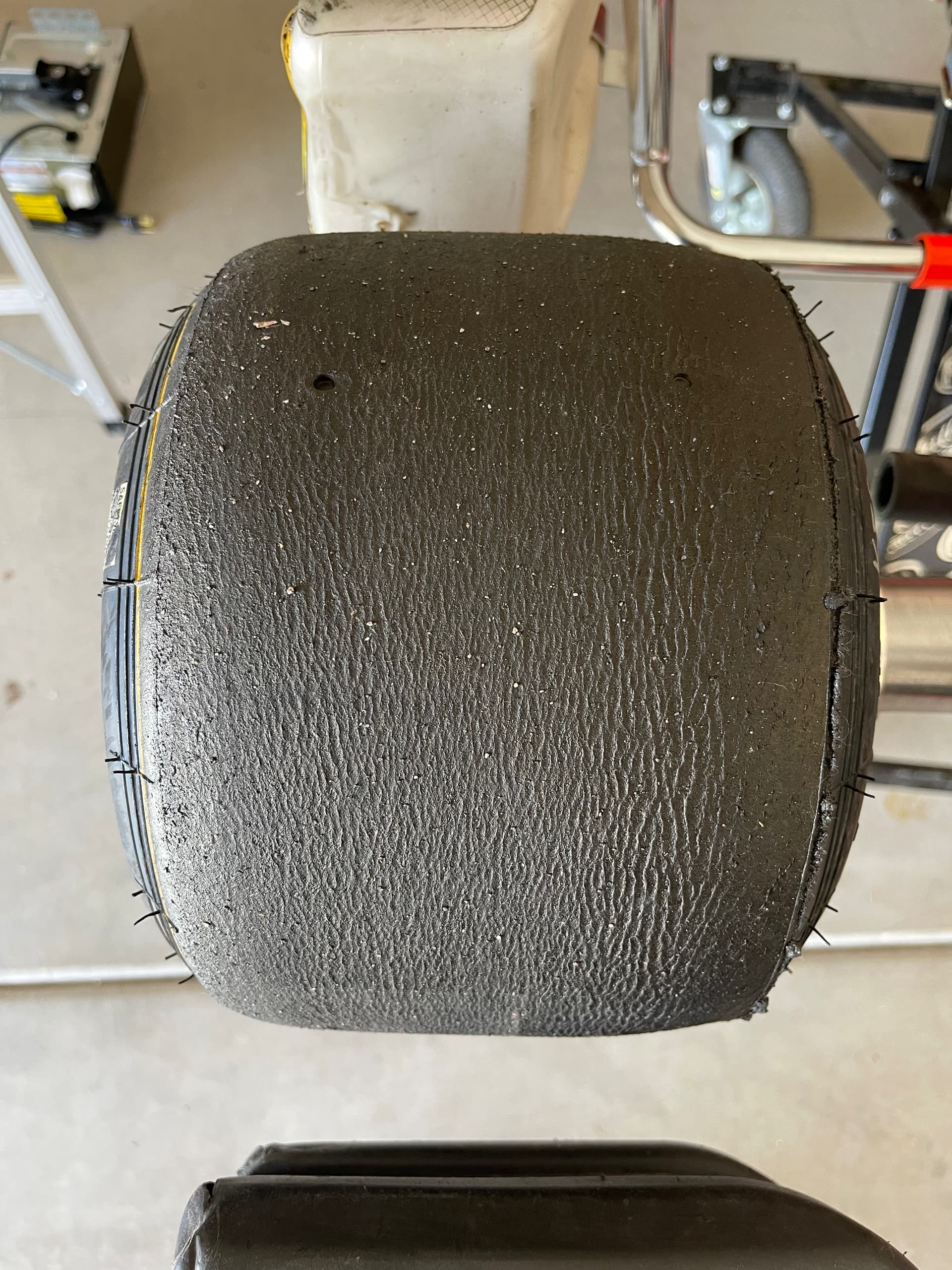

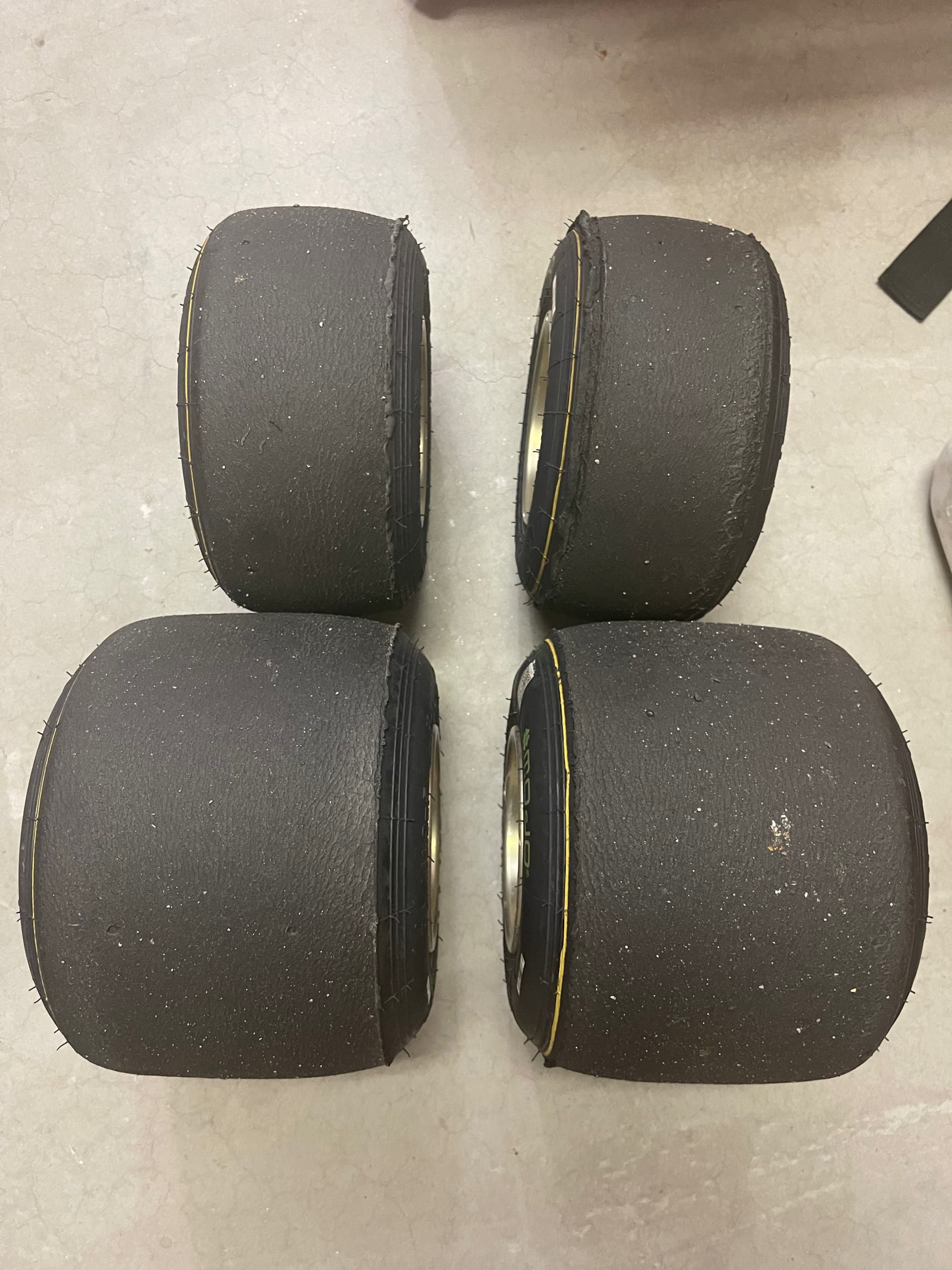

Well, I hit the track yesterday after flipping the set above, no setup changes. Not as hot, but still pretty warm out high 90s to low 100s. Bumped up the hot pressures all the way around by 1psi and it seemed to cure the blistering on the inner edge. I think it was just too low, the inner edge was rolling over, and the added friction was blistering the rubber.
Finally some nice even wear on a set. No flipping needed. About 150laps, still had some life, but they have been heat cycled one too many times.

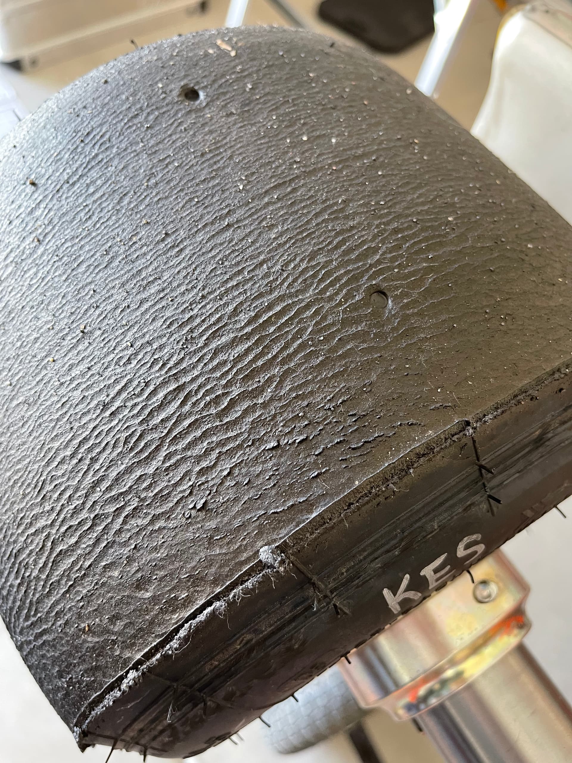

Did see some weird wear on the RF tire on a clockwise track. Outside shoulder has some “blistering” or weird groove in it. Hard to capture on camera.
Looks like build-up from dragging the front tire slightly. Fairly common if you’ve got some corners or a layout that doesn’t clean that tire up every lap.
Yea it’s basically not used. Only 2 real left handers. Really hard to capture but there is nearly a groove worn into the shoulder.
No real concern just odd.
