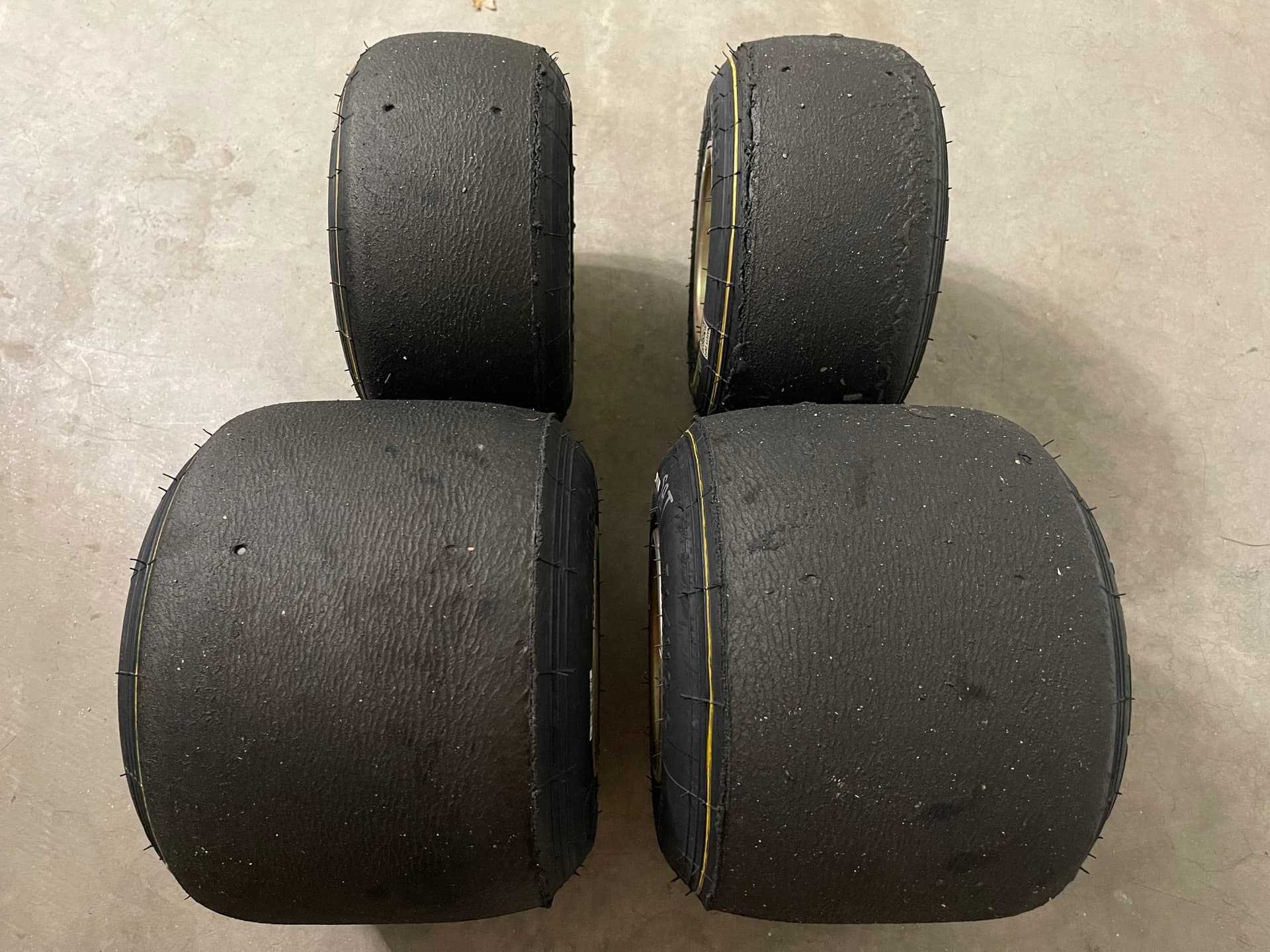

Hers is an example of some tire wear I’m seeing. These have a race weekend running clockwise 40laps. Practice day hot as hell 30-40laps counter clockwise.
Fronts have plenty of life left. I’m really killing the inside edge of the rears. Set on the kart is blistered after 40-50 laps (not pictured). There is sings of graining as the tires age, but kart wasn’t sliding alot in the rear.
Anyone have some thoughts on how to utilize more of the tread on the rears? (LR inside wear indicator gone, outter indicator halfgone) Wider hubs to keep the contact patch flatter?
Other soft tires MG yellow, Evinco Reds I’ve normally chewed through the fronts and had nearly perfectly even wear on the rears.
I haven’t driven on Mojos in a long time and I know the compound has changed a lot since I ran Rotax, but I do know they always looked feathered like that, even when my kart was good.
Is there a handling issue you’re trying to correct? I ask because sometimes people get hung up on poor tire wear without consideration for the stop watch. If a tire looks like garbage but the lap time is good, maybe you don’t really need to worry about it.
Fairly normal for all four tires to wear the inside shoulder more. My current MG Reds have no dots left on the inside edge and lots of meat on the outside.
If your main priority is getting the tire last longer, it could be worth flipping the rear tires on the rims between sessions to use each side of the tire more evenly.

Stopwatch is always king. If my setup is fast and this is just how they wear so be it. It’s just one of those things were I’ve yet to experience such uneven wear not just across the rears but mostly front to rear. It’s like the front are just along for the ride and I’m doing all the work/wear in the rear of the kart.
I can make it through a 10-12 lap prefinal, but I struggle on those last 4-5 laps of a 20 lap final keeping the rears working. Wondering if I can get the rears to work more evenly I won’t be cooking the inside edge and losing performance.

We are driving d5s on a dd2. For all guys in our championship the tire wear looks the same like yours. After the full sunday the innerside is almost gone and outside has atleast 50%. Only the surface looks different for me. Looks like you dont get enough heat into the tire.
Good to know! I think not enough heat would almost be impossible here in Arizona. It was over 100F and track temps in the 130-140F by 8am :sweat_smile: Swapping tires and rims between sessions the rims were almost too hot to handle.
