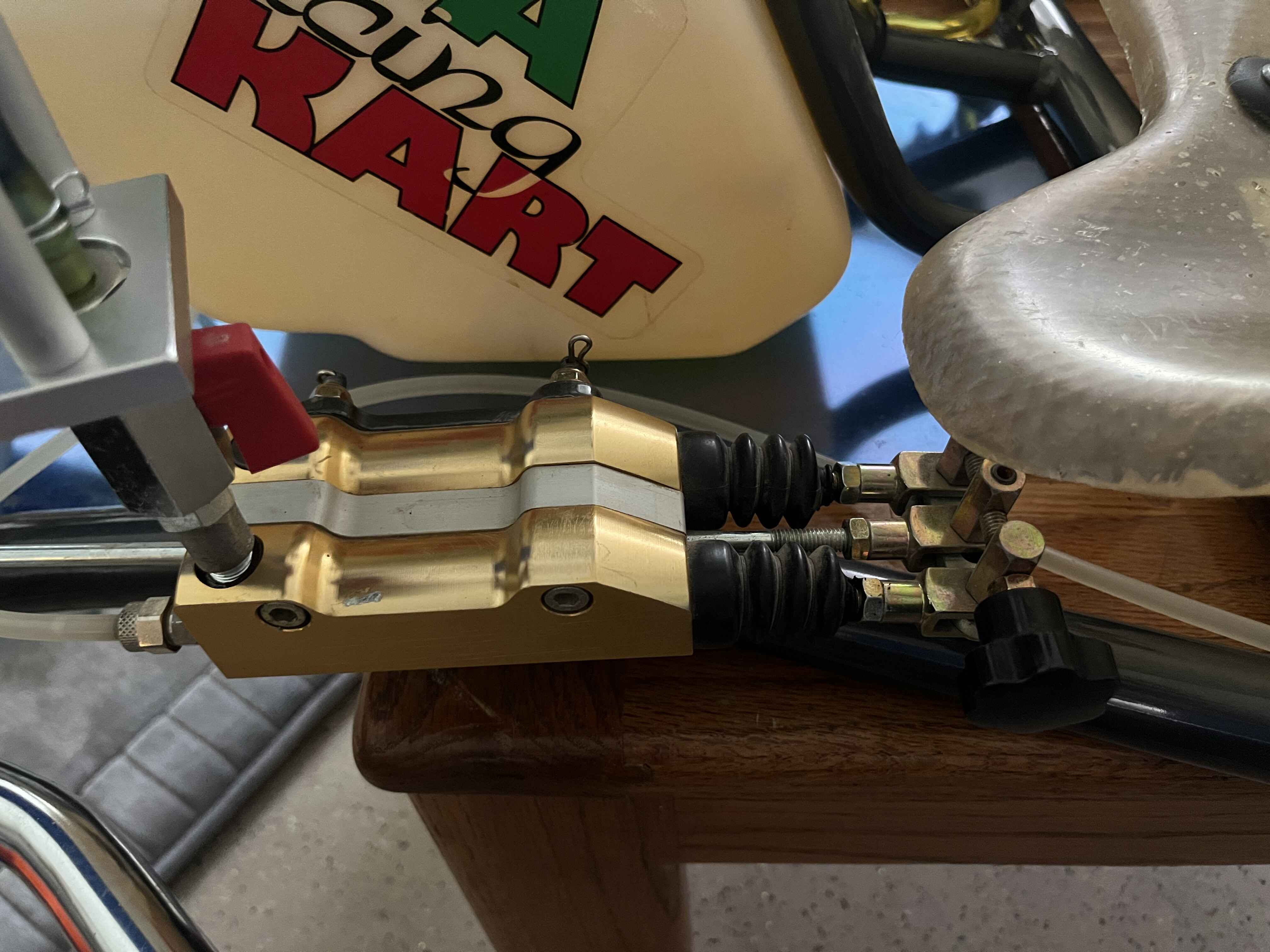

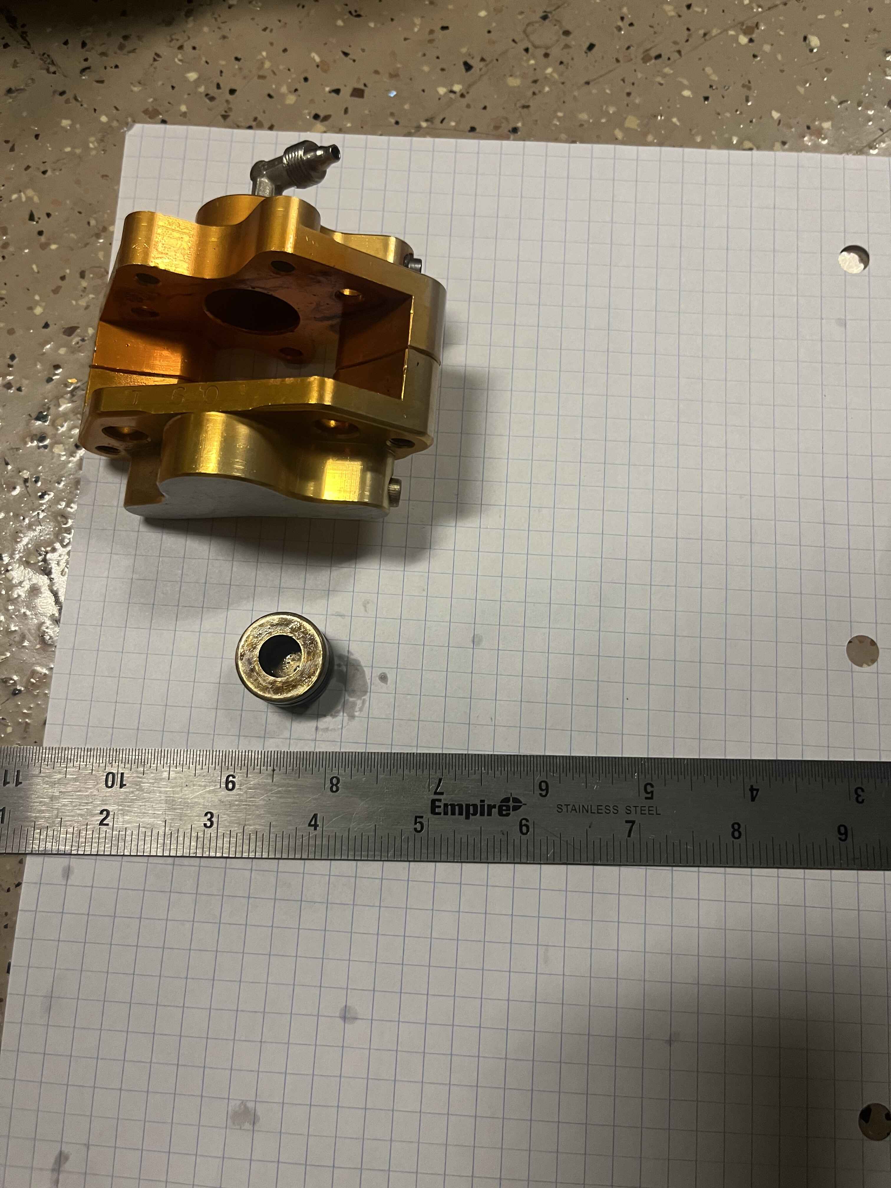

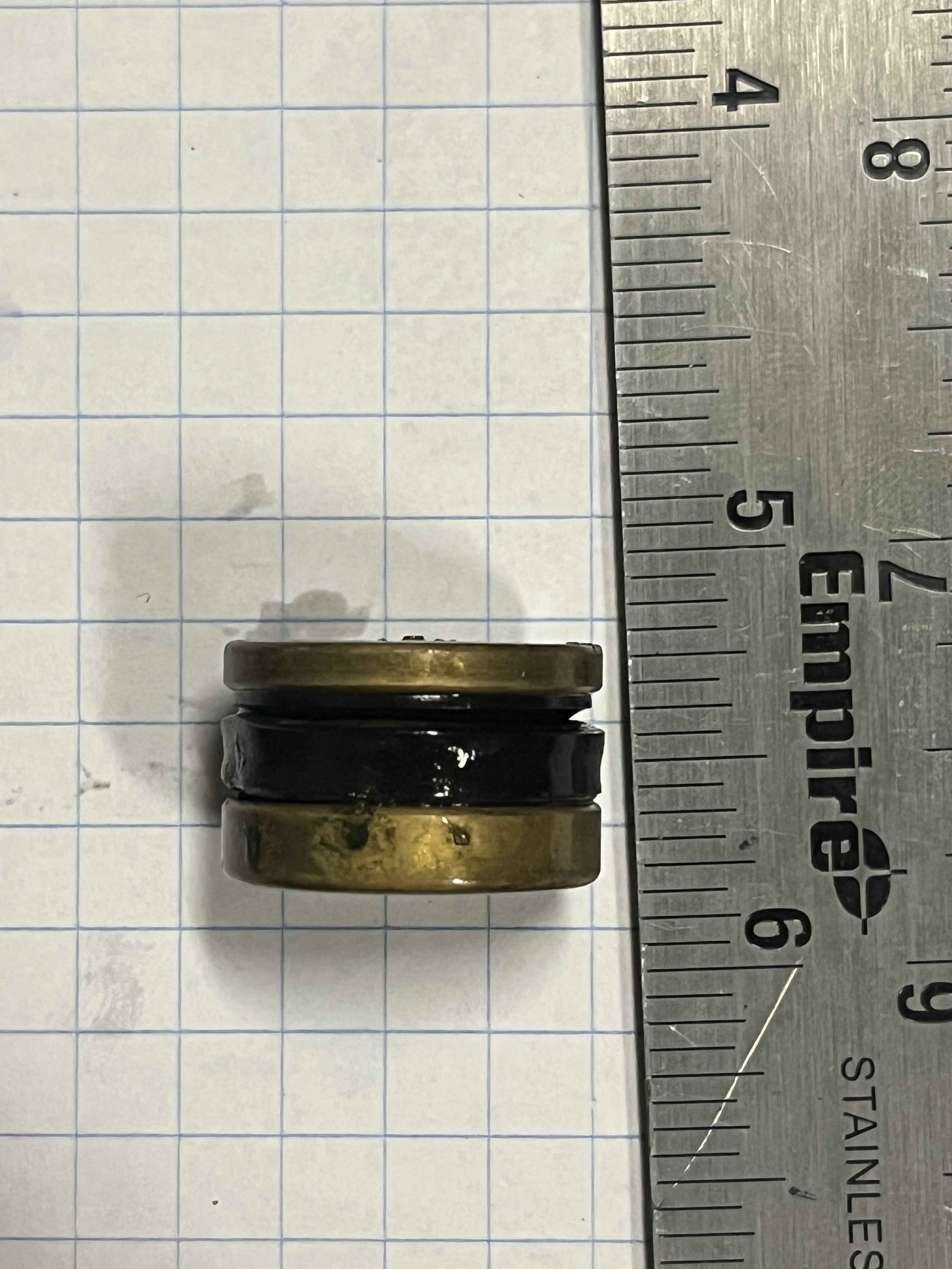

I just got this kart and from what I know it’s a later 90s/ early 2000s Haase kart but that’s about all I know. I would love to hear if you guys can help identify the brakes since my seals are bad and I need new seals and possibly more. Any help or advice would be greatly appreciated
Haase/Corsa uses Runner as their component brand, and those look like Runner brakes. Not sure on the models or parts, but that should get you started.
That’s what I was thinking, this was the closest model resembling what I got but mine are definitely a few years older
Correct, I drove Haase/Corsa from '04-'06ish and the brakes on all my karts looked like yours.

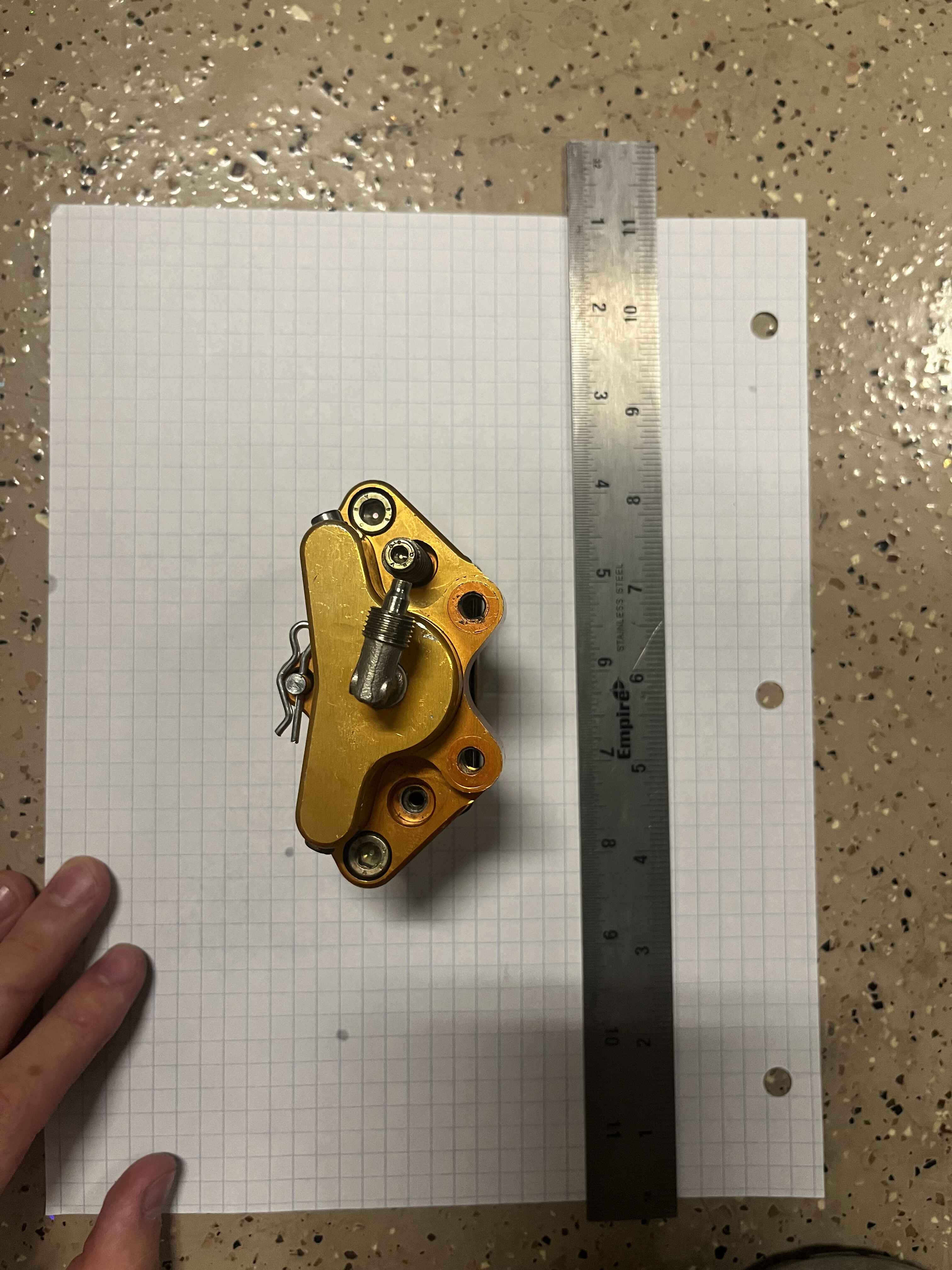

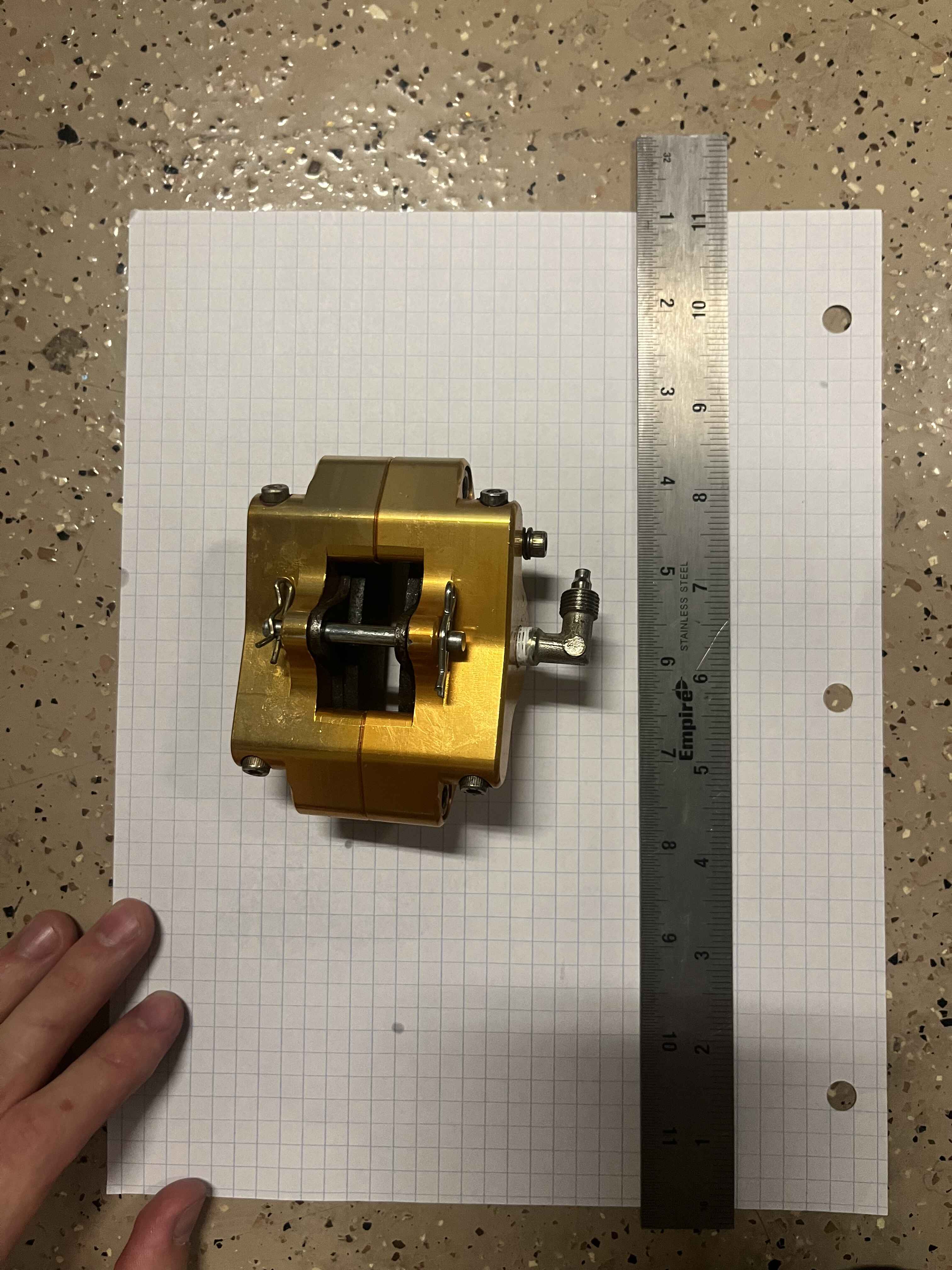

Do you know any spots to get old parts from? Or do you know if some of those parts work with the more modern brakes?
Also would it just be cheaper to get new calipers? The master cylinder seems fine but realistically how hard would it be to get seals for 25ish year old brakes?

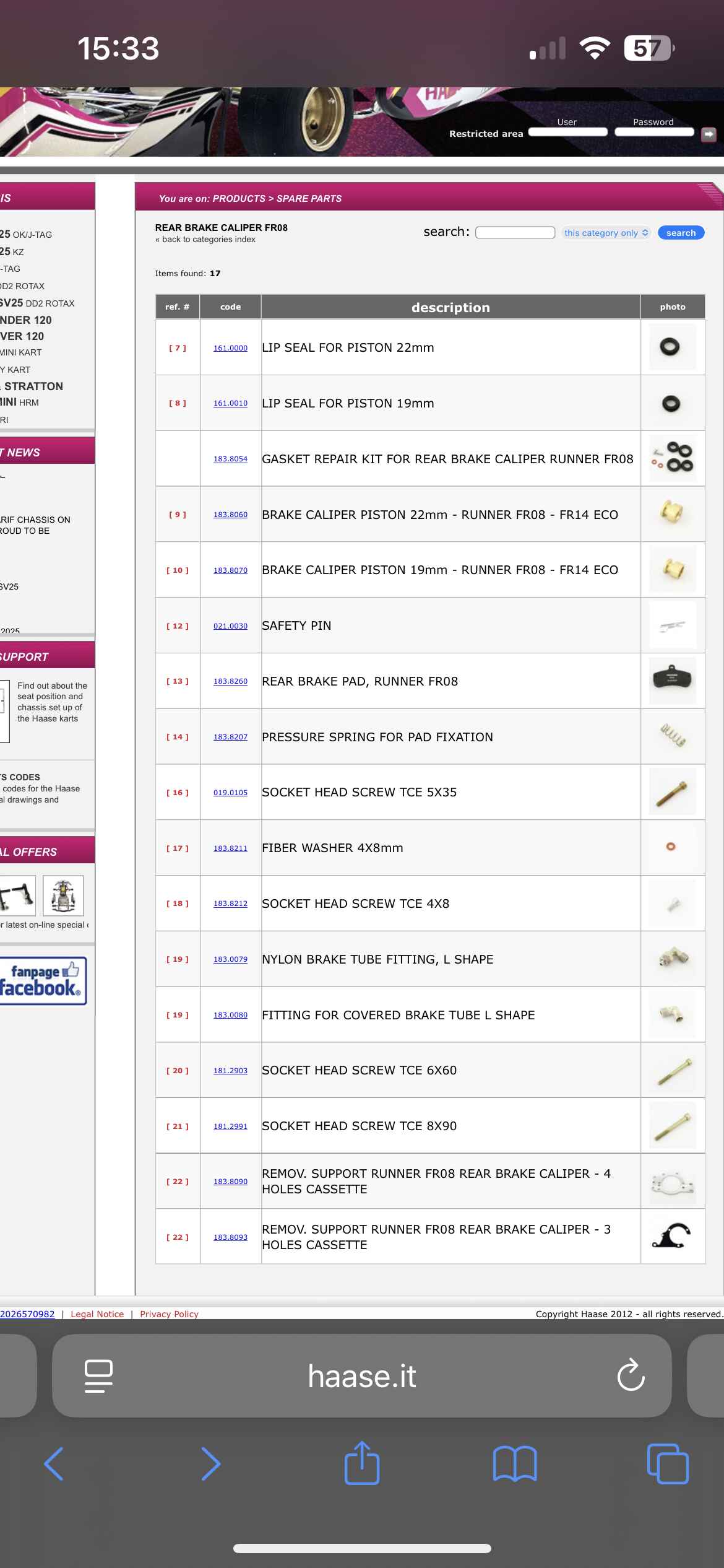

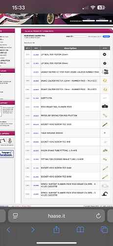

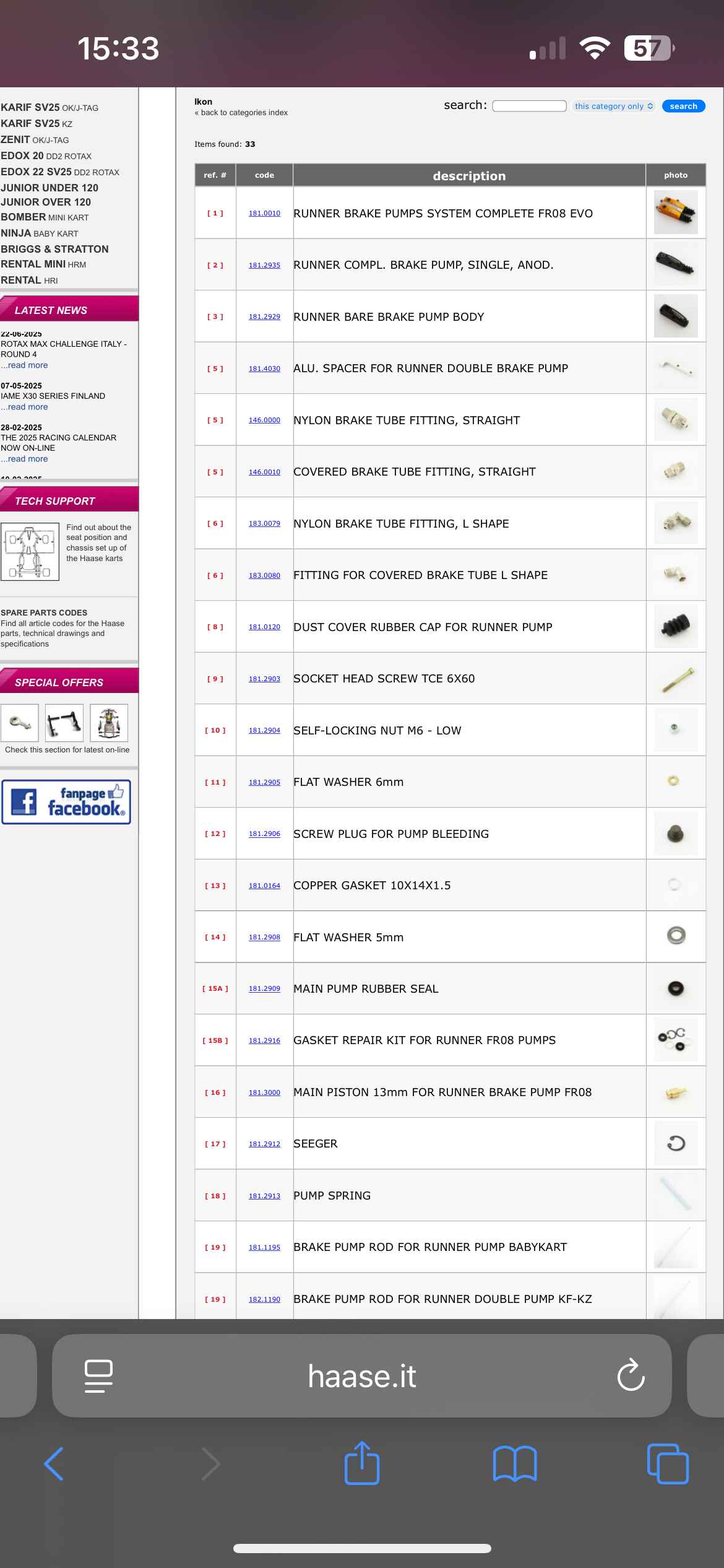

I believe it’s something like these runner FR08 brakes but I have no way to get parts, any help/ advice would be greatly appreciated
