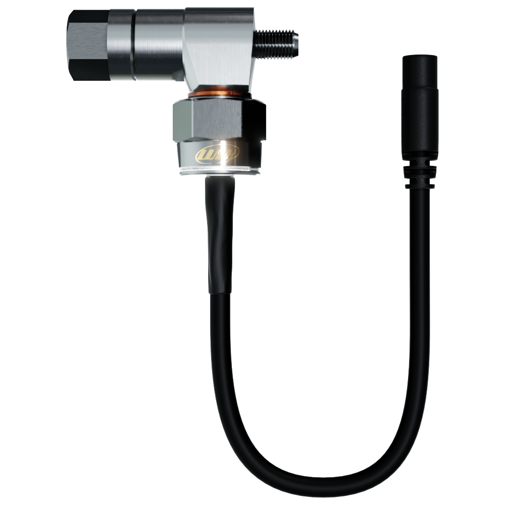

I’ve seen multiple brake presure sensors for the mychron but they all seem to be just for a single brake master cylinder.
Is there any kz brake pressure sensors available, that could calulate the split. I supose you could run two sensors but then how would it connect to the headunit.
You could run 2 brake pressure sensors. You would have to calculate the split in analysis, though I believe you can show both on the unit.

The pressure sensors are universal in that they work with MyChron units or the car units. They are actually available in 1/8 npt, M10, and -3 AN (3/8-24) threads so you can avoid adapters.
I’ll make a video on how to look at brake pressure. It would be essentially the same as looking at the position, but would be the actual output of the mc versus the position of the pedal. It would show if you had any fade, line flex, etc.

I’m going to install one on my OTK.
A problem on my kart is that the brake lines are not long enough at the master cylinder to install the T adapter there.
Someone here suggested installing it at the caliper. That’s very doable and what I intend to do.
