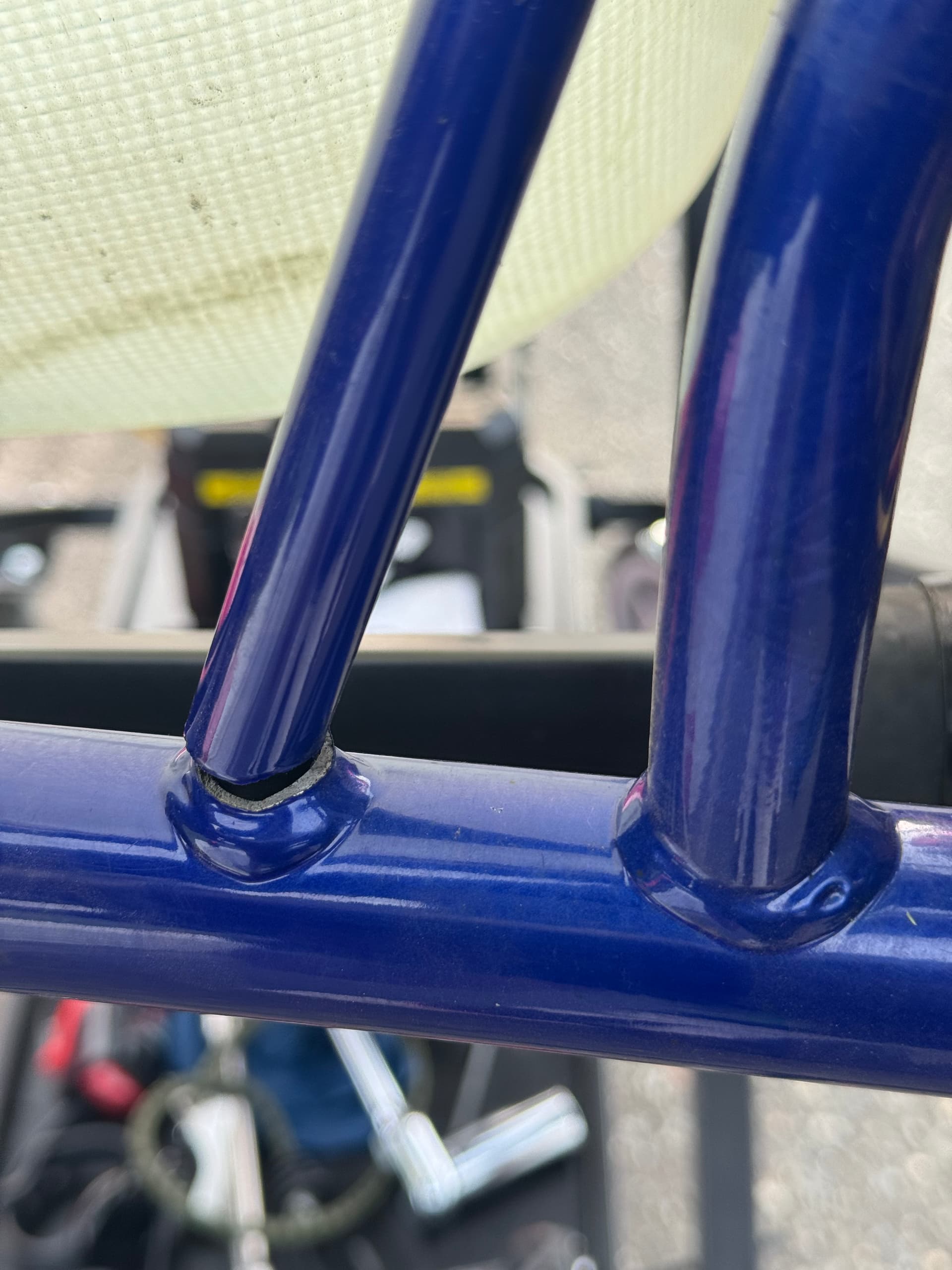

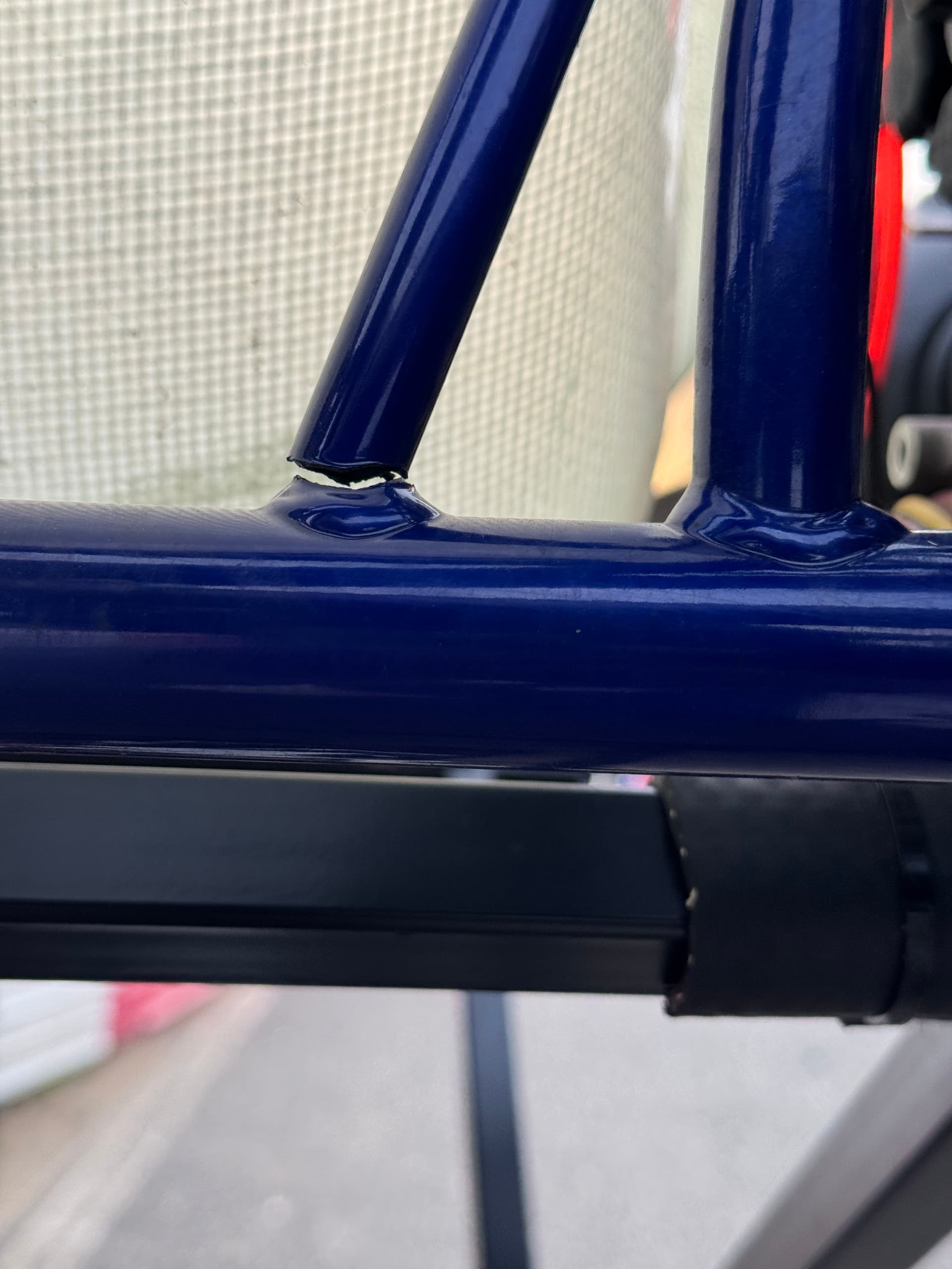

n00b kart owner. 2021 OTK Kosmic Mercury with ~10hrs on it now.
This happened. I’m learning this is common. Even expected / inevitable?
  • What are some considerations I should have when getting it repaired?
  • I assume this is chromium-molybdenum steel. Anyone know the specific alloy? 4130?
  • Should I look for someone who has a an OTK-specific jig or OTK-specific experience?
  • I assume the practice is to get it frame-tabled after and adjusted if needed? Or just weld it and send it?
  • Will this happen often enough that I should just tool up myself? I’ve TIG welded sections of championship-winning FSAE frames and suspensions before, but currently only have a small MIG.

Super common. Not a huge concern. There are two types of people in this world; those who have broken an OTK seat strut weld, and those who haven’t put their kart on the track yet.
I have always MIG’d and sent it. I gather that your style is to be very thorough and detail-oriented, but for me, stressing too much about this kind of thing isn’t worth it, so I just fire up the welder and fix it without too much thought. Sometimes it lasts a season, sometimes it breaks again right away. That’s why I just MIG it quick and go, because it’s probably going to break again regardless of how you repair it. Either way, it shouldn’t affect handling too badly, since you still have the main tube attached and you have an additional chrome strut too. Once it’s repaired, it’ll be basically good as new. Really no need to re-table or jig the chassis. Nothing should shift from that breakage.

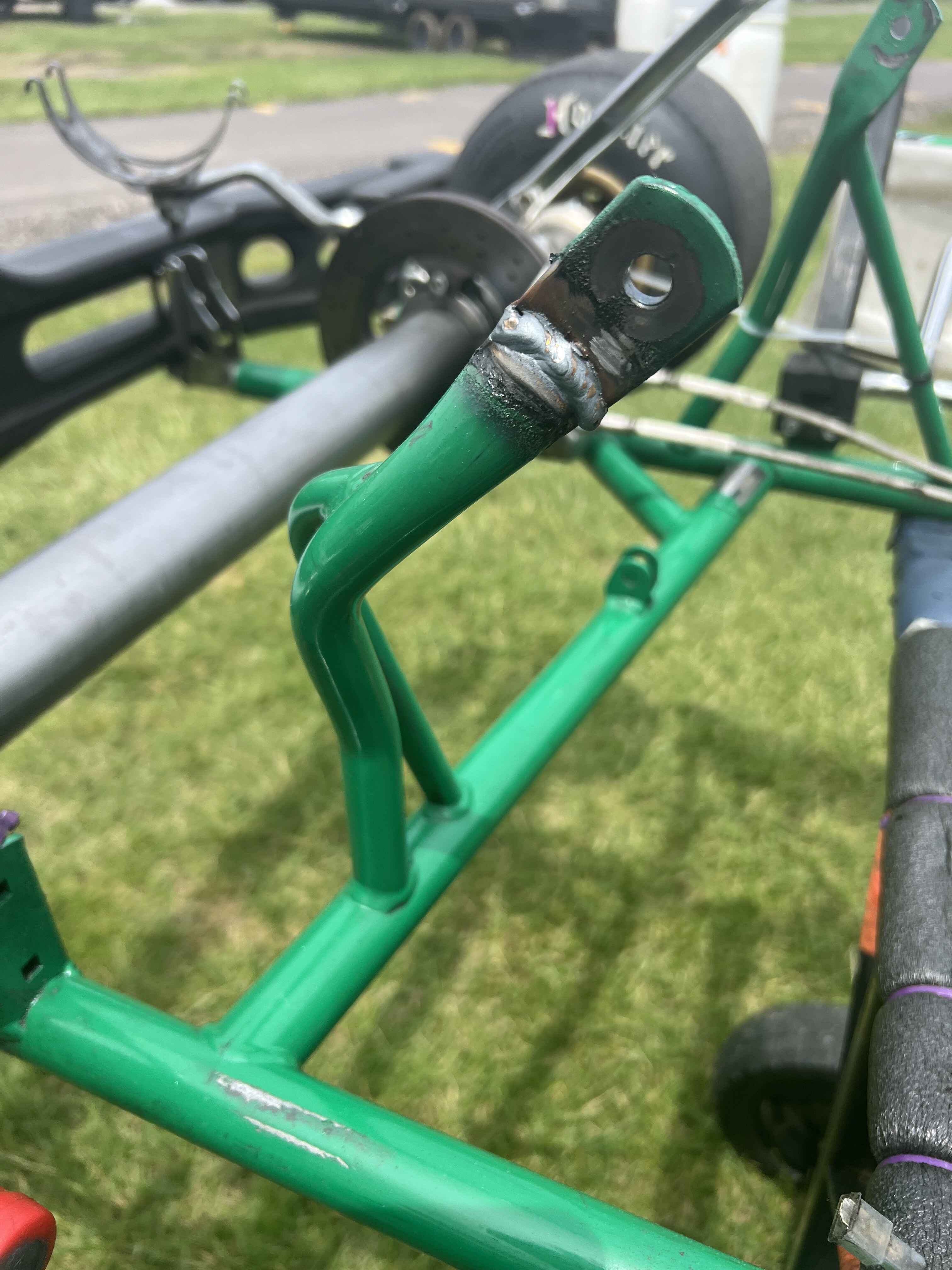

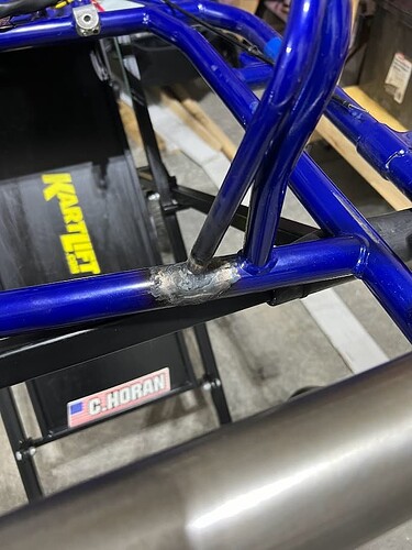

2022 LN kart with 2 frames over 45 or so weekends. Let’s see… 2 seat tabs, 1 entire left side both posts, 1 left side smaller forward post only, 1 right side full break and partial crack of tubes. We never had a re-weld on any repairs, all of those were crack in factory welds. All of the cracks were in the heat affected zone adjacent to the weld. It is an artifact of mass produced chassis where too much heat is being applied on Cr-Mo tube material. It just so happens that the smallest tubes on the kart happen to experience the highest cyclic loads (seat posts) and heat up the fastest during welding.
As for the repairs, we always had an acquaintance of ours with chassis welding and aviation welding experience tig repair them for us. We did 1 field repair at the track with a mig, but brought it home after the race and cleaned it out and re-welded. When welding would work slowly and pause some along the way and then wrap the finished weld. The focus was minimizing heat input and controlling cooldown since we could not perform any PWHT.

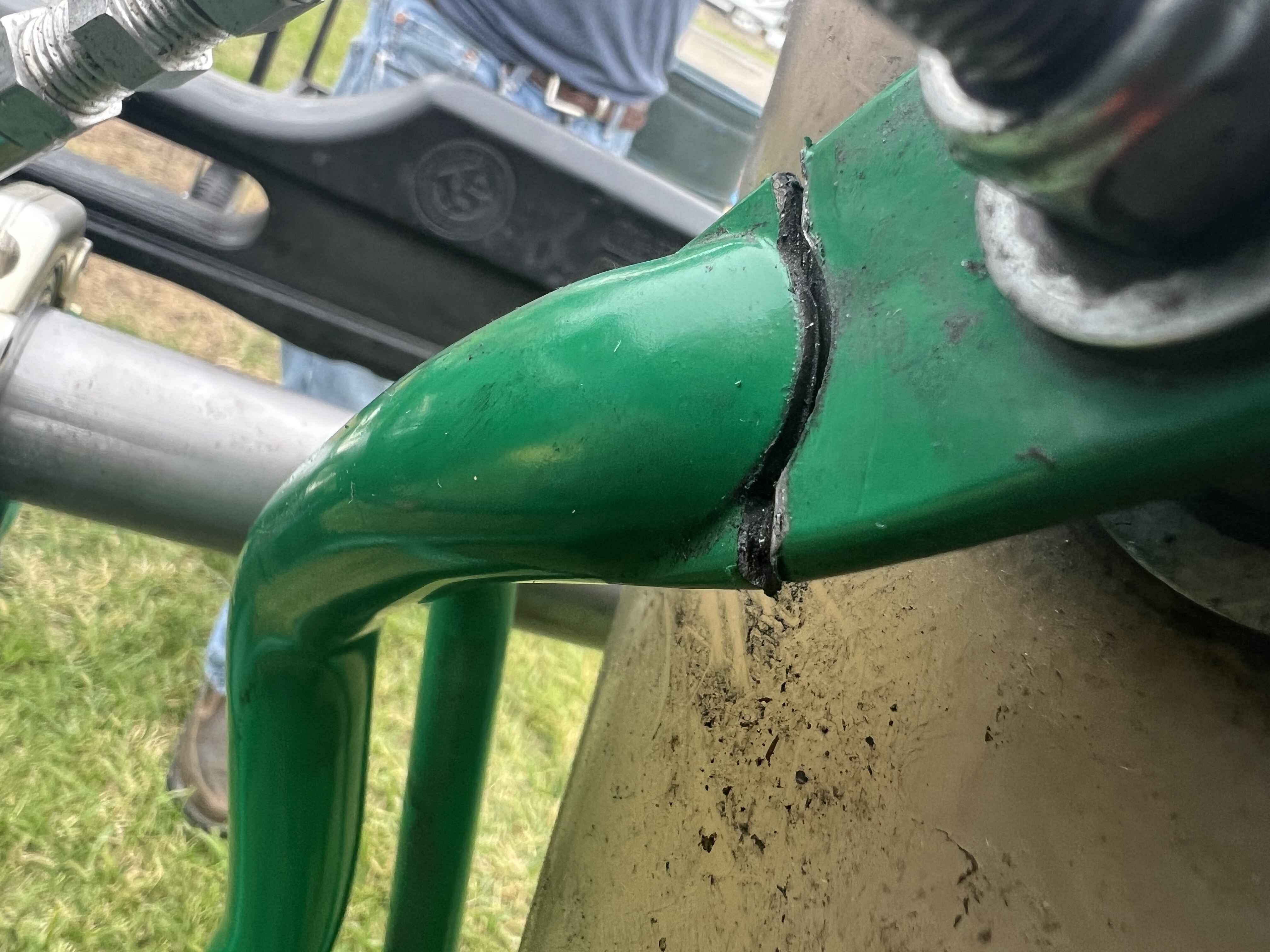

Margay uses bolt on seat struts as far as I’m aware. This issue isn’t stritctly OTK, it’s all karts with welded seat stays. On the Crocs we had issue with the tabs on the seat stays cracking until they changed how the tubing is crimped which has helped. They still occasionally break at the bottom where welded to the main tubes. I figure part of it is the stays are made from a cheaper/weaker material than the main tubes to save money. Some manufacturers played with brazing versus welding on the seat stays to keep from weakening the metal in the heat affected zone.

In my experience when a seat tab breaks it needs to be reinforced with some plate to not break again.
