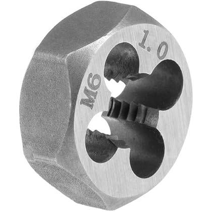

Or just get yourself a nice thread chaser and repair the stud before it’s a problem.
