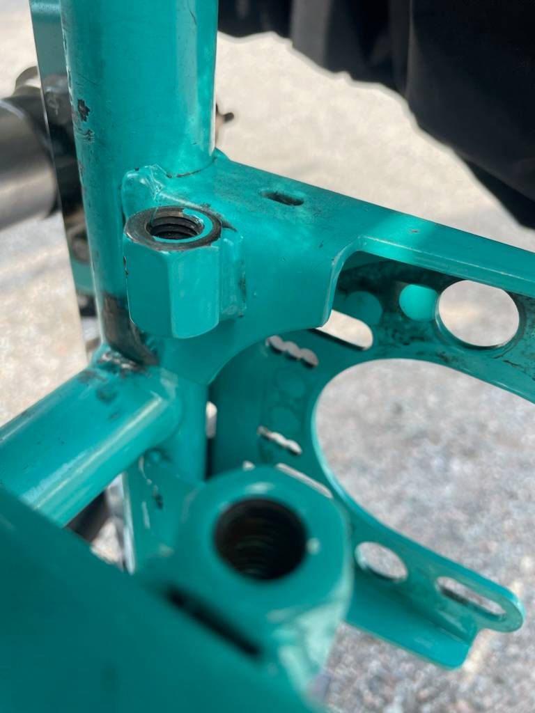

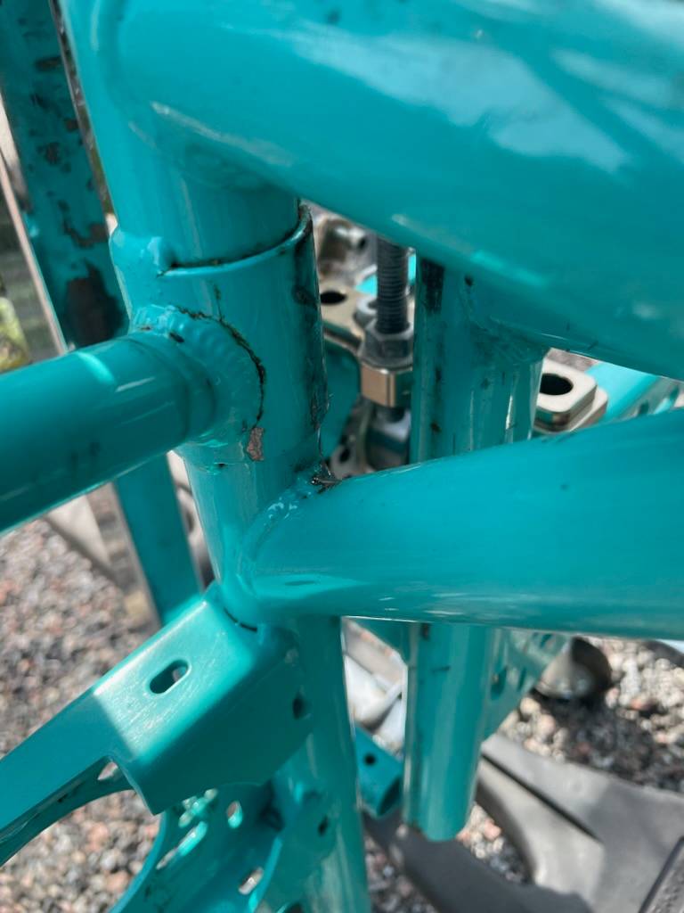

It has some cracks tho… and we figured if we weld it up nicely and send it to powder coat and sell it it could make some profit maby sell for 1500? Any ideas if this is worth it or not?

Id i weld it up for myself to be a wet kart?? Is it worth it?
To me. Once there is a cracked on the chassis its not worth saving. Safety hazard.
in what way can it be a safety hazard if i wels it? just wondering
Perhaps just that it’s forever a bit weaker. It seems to me that eventually you give up on rewelding chassis after several breaks and just get a new one. At least that’s how I felt about it. It seems to cascade once you start having seat stays crack.
