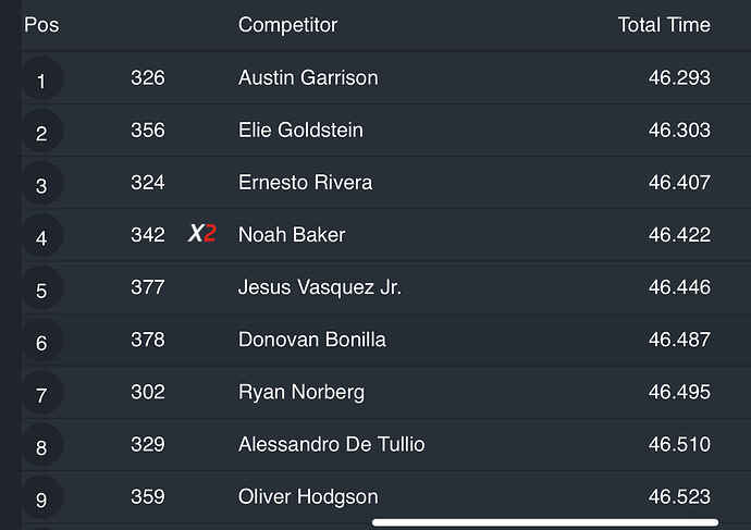

x30 times at big events tend to be incredibly close, so I think it’s fair to say that the parity is pretty good once the engine has been checked over.
