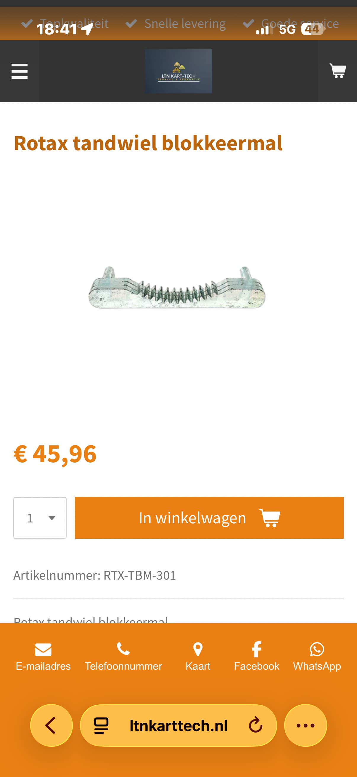

Can i break the clutch drum nut loose without one of these?
i need to break the nut loose to replace the clutch drum and little Sprocket but i dont have one of these can i still break the nut loose

We bought this one. Does the job and is not that pricey.
You will probably need it a couple times more during your adventures with a Rotax, cleaning and inspecting the clutch will be much easier.
