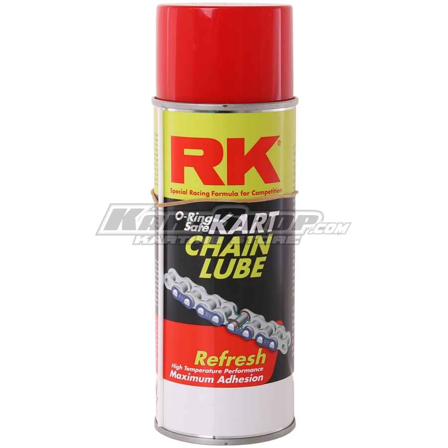

If you’re ever stuck for something I whole heartedly recommend Wright Karts down south for parts and consumables. Amazingly helpful folks even to the point of taking a box of RK chain lub for me to meet one of our jets that happened to be stopping nearby for a few hours.
