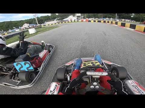

OVRP comes to mind. :sunglasses:
Isnt that straightaway only like 600 feet long? Think more like the Battle at the brickyard. 2.9 gear ratio and a hairpin with a radius of about 20 feet.
It’s a good length straightaway but the switchback is tiny!
Where is this track?
Cuddebackville, NY, about 2 hrs from central Jersey
Heheh
Like a boss!
