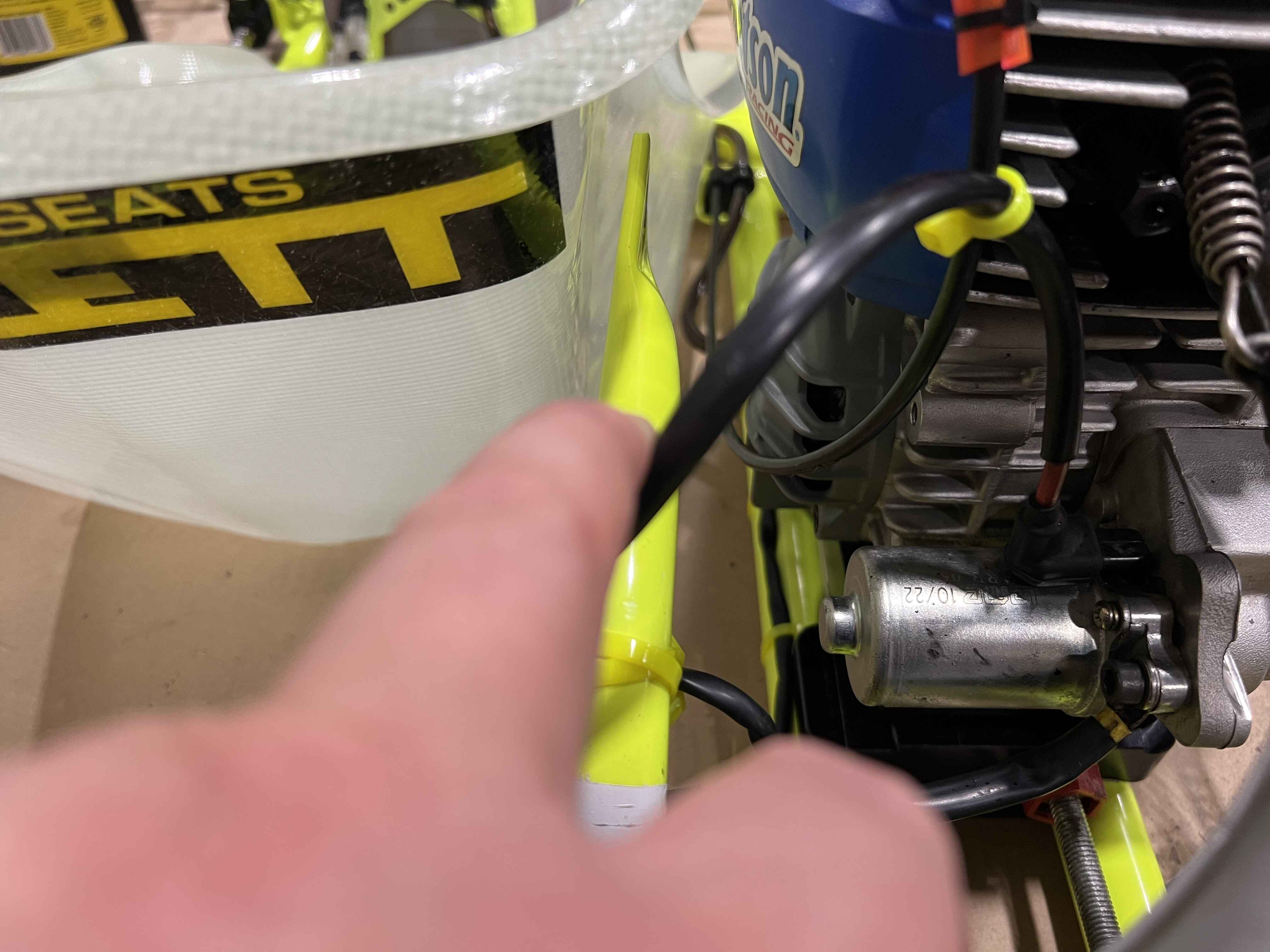

Purchased a new Tillett T5 VTI CCD for my son.
It looks like the seat that was originally installed on this kart was a different Tillett seat. Can’t tell really as there are no tags on it.
I’m not sure I will be installing this myself but for now I’m just trying to fit it to see how it would work.

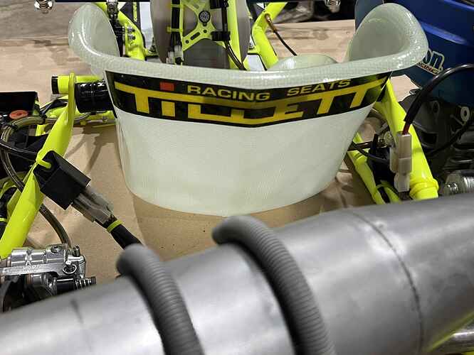

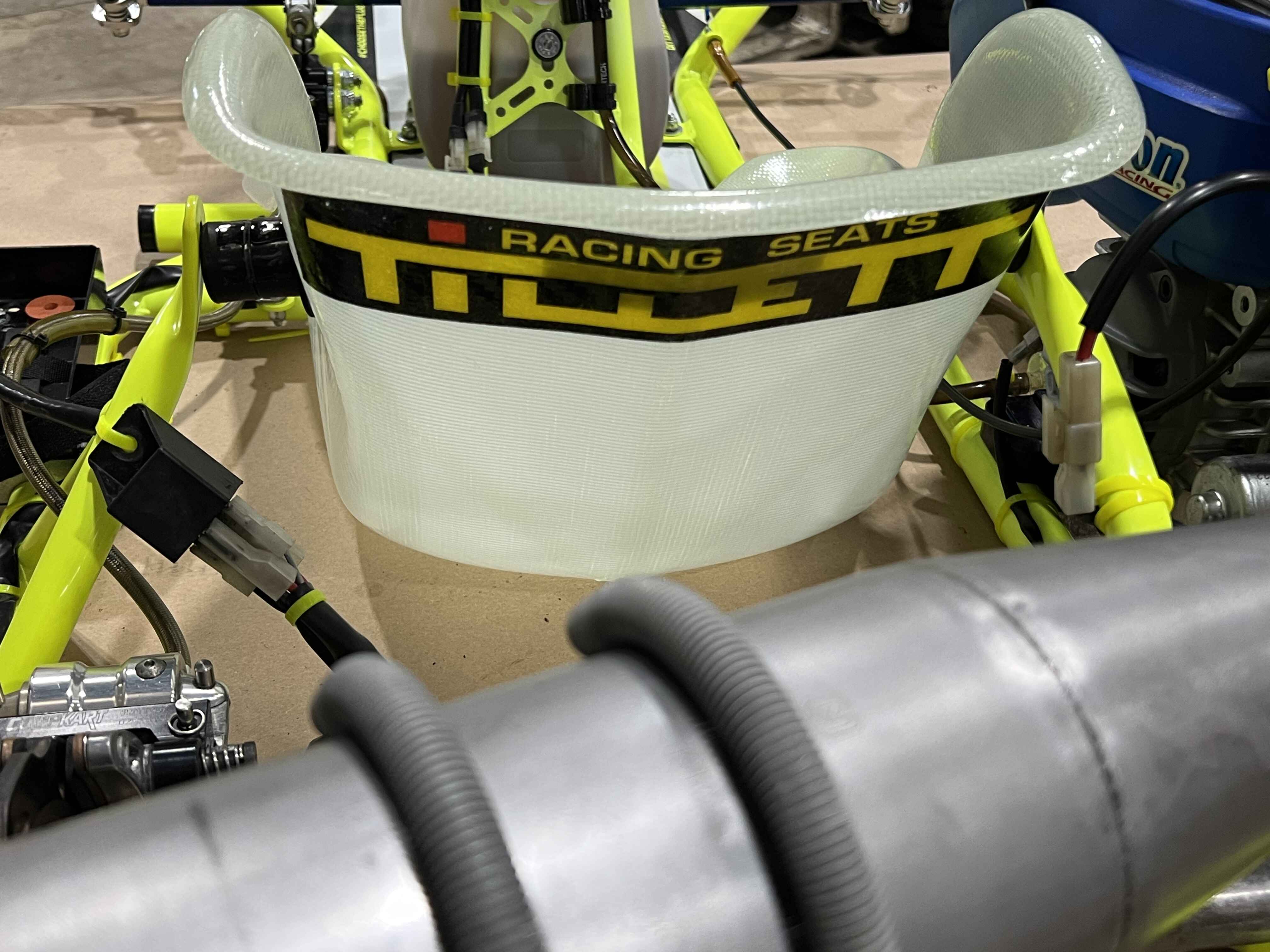

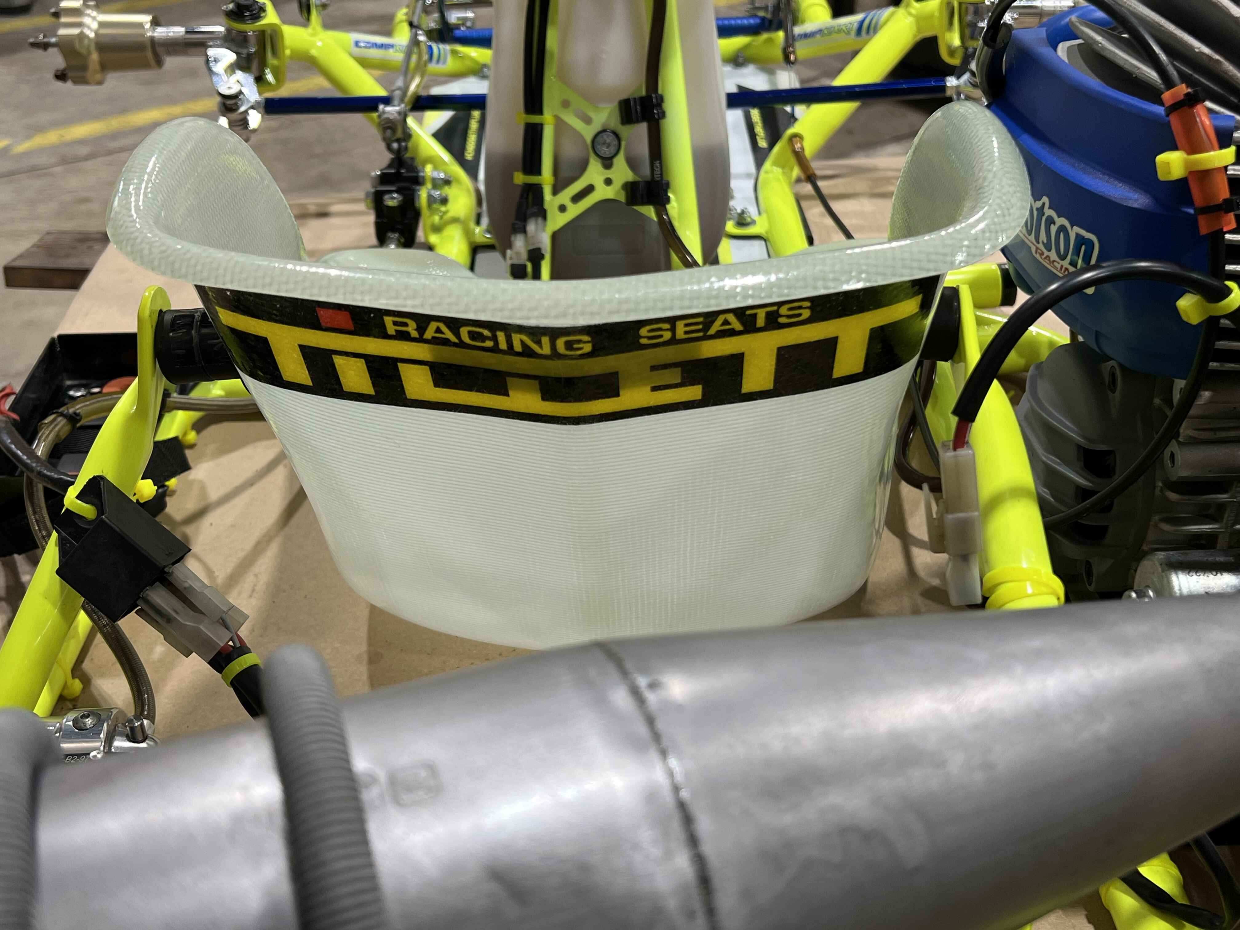

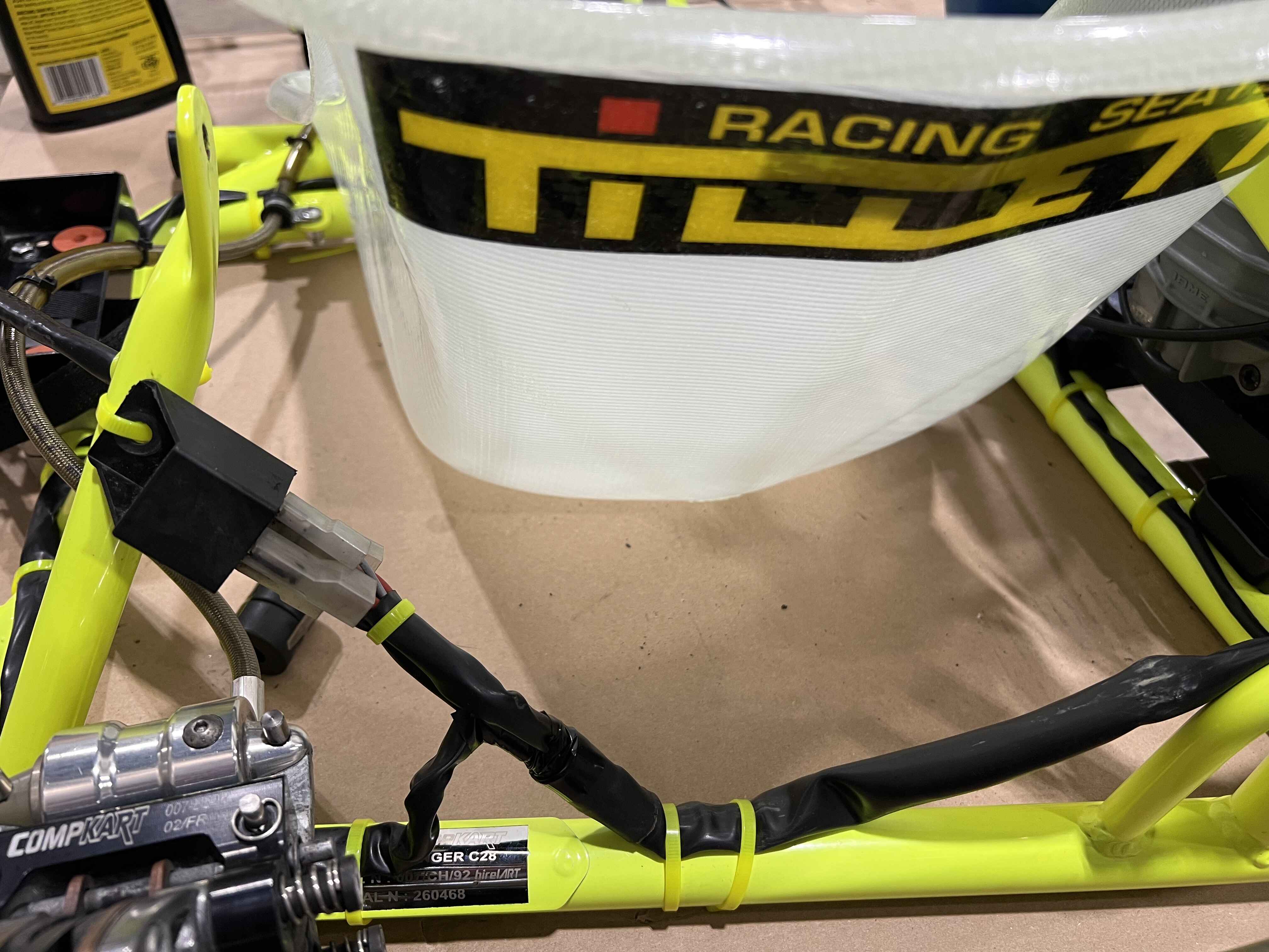

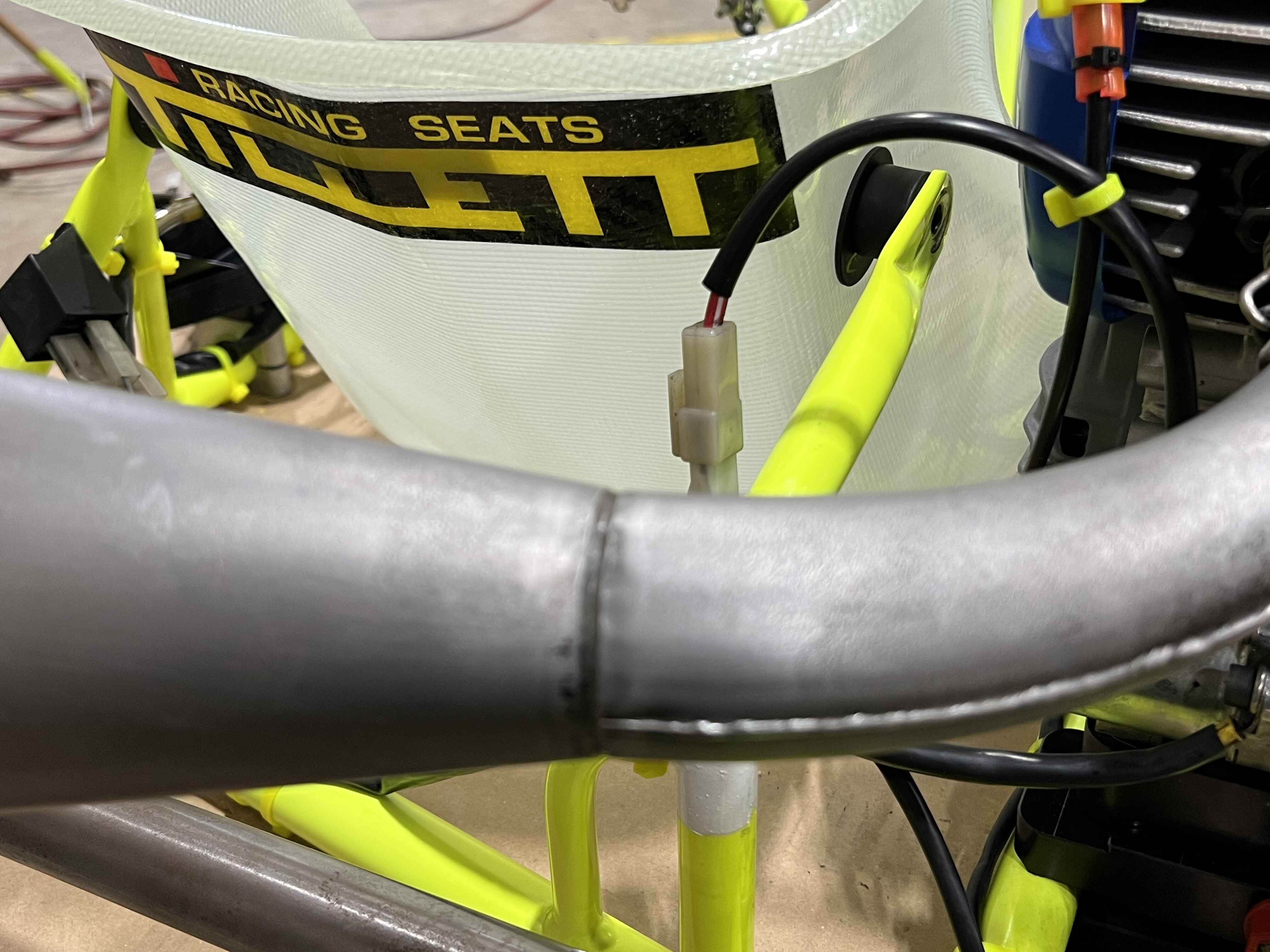

The T5 seat is a LOT!! smaller than what the kart came with.
Is this ok? Setting it up work this many spacers??
While you can do that with spacers, I would encourage bending the seat struts in. This is a tricky subject though as repeated bending or excessive bending will likely cause the metal to fatigue and crack, usually just above the weld. It’s likely the previous seat required bending the bars out so you may already be on borrowed time. Typically, I use an old axle to give leverage.
no, not ok. Bend left seat stay inwards. You should be able to fit one safety shim and one or two shims each side to take up some room and center the seat, no more than that.
To bend the strut, you need a helper and a used axle (er equivalent long lever). Heat up the base of the stay with a heat gun (to soften the paint a little bit - optional) and use some rags between the lever and the paint. Go at it while the helper pushes the frame down. Try to feel the metal gradually and you’ll be fine.
Bend the left side seat strut in for sure.
