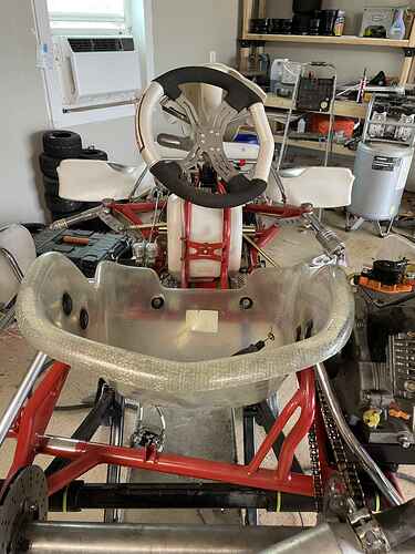

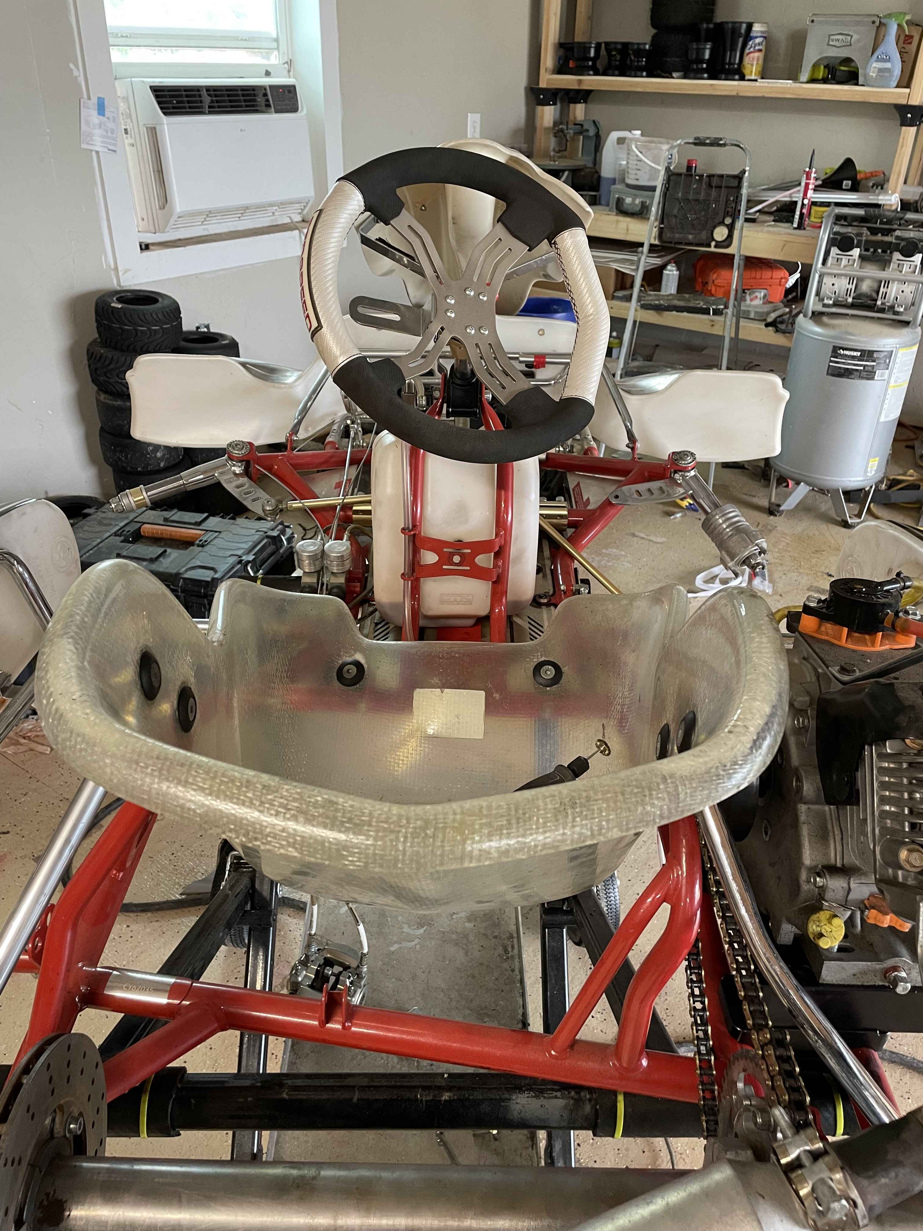

Here are pics of mocking up the motor and chain.
I just want to see if it’s normal to have the motor so far to the right.
If I ran mini gears and a 0 degree mount I could maybe move it to the left a bit.
Currently the seat looks pretty centered. Should I try to offset it more?
Both my old margay, and our crg fs4 were built for 4 stoke, so I not used to everything being so close.
If there is any room move it to the left 1 hole. It is hard to judge in the picture. Usually the Li opting factor is the seat strut. At least for me. Other than that you are set.
We bent the left side seat strut out, then put spacers on right to shift seat over more.
We also ran with no extra stays/struts 99% of the time.

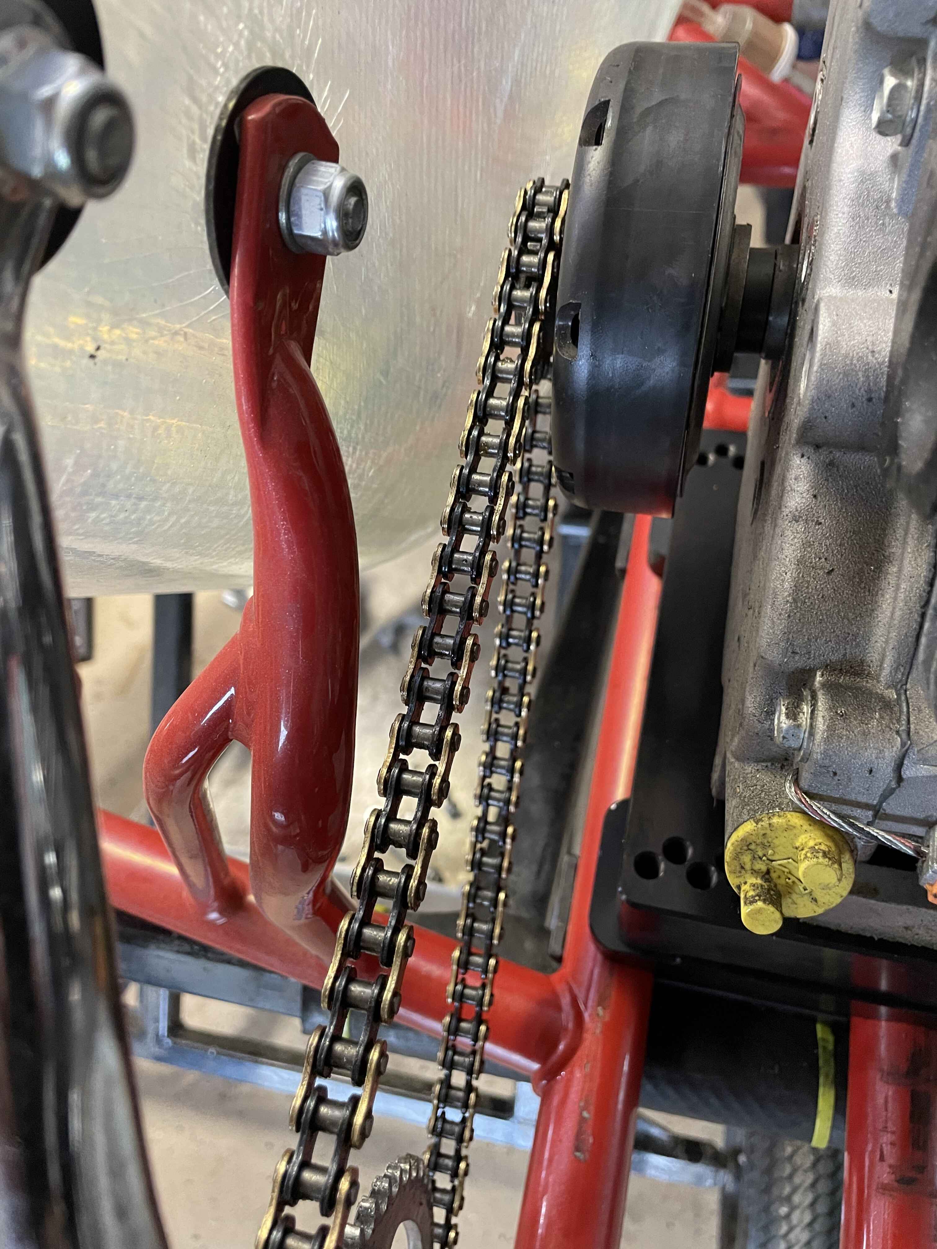

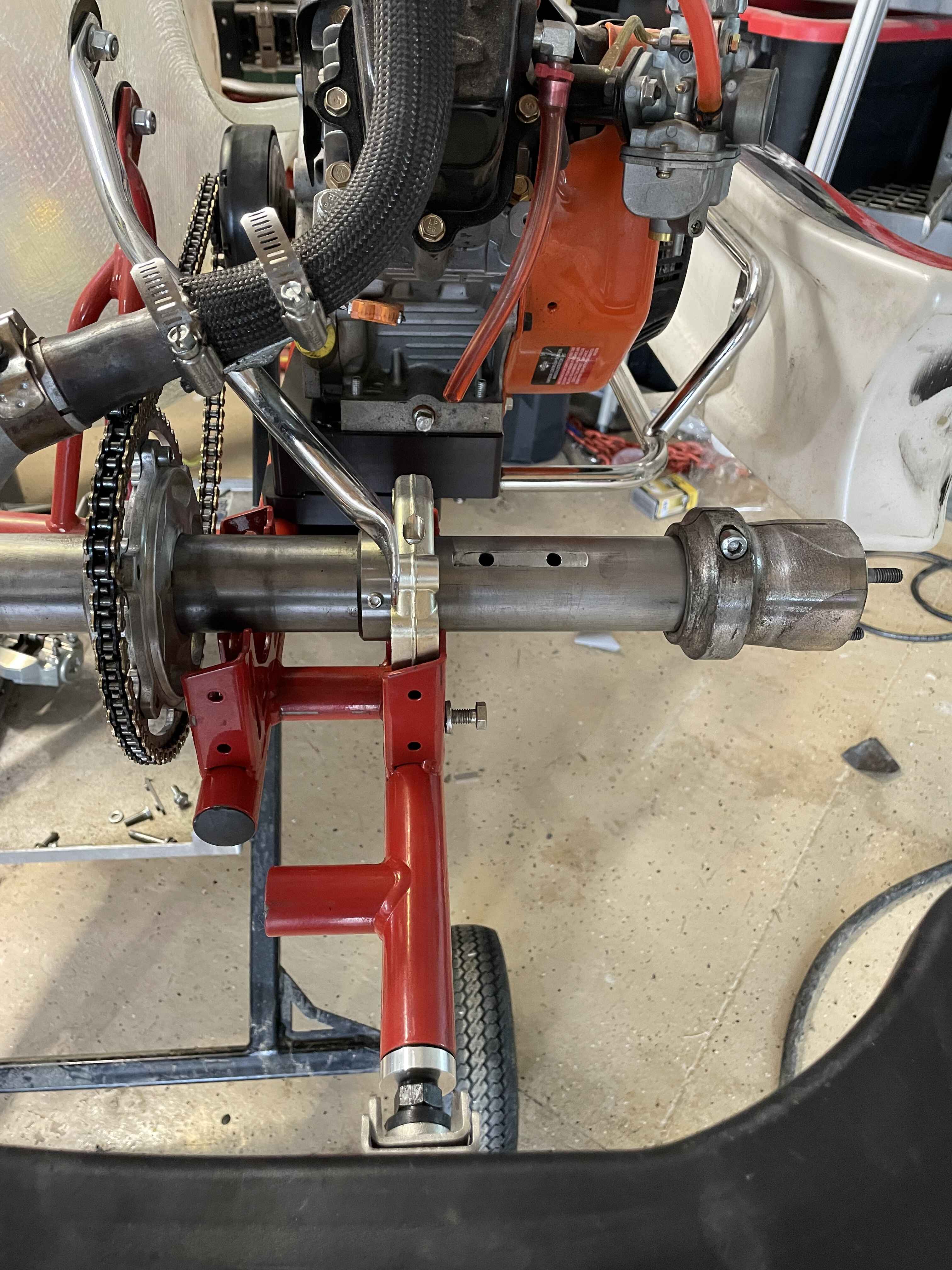

Sofar here is what i have done, and its getting close.
I bent out the left strut. I am going to need to go up to a XL seat to fit with my rib protector.
I reversed the clutch and moved the motor in lot.
I think i need to move the motor furth back. How far are you guys setting your motor back?
You can go back a few inches at minimum, if you need.. I like mine in front of the cross member so that the mount doesn’t sit on that weld, but even than some folks go back that far.

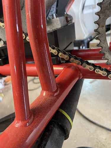

Also, find a small piece of Kydex, heat form around that crossrail, and adhere with some 3M VHB tape…will save chain rash.
