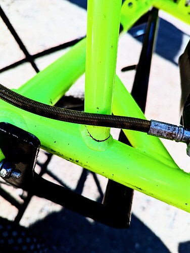

Noticed my frame has a crack. Is this weldable? COMPKART covert 3.0
Definitely repairable. Pretty common crack across brands. Doesn’t make it suck less though.
James is right. THE MOST common crack in the history of karting. We repair about one a week in our garage for folks at the track. Pretty sure @Matt_Geist could weld seat struts with his eyes closed now.
Get her welded back up and it will be like nothing ever happened.

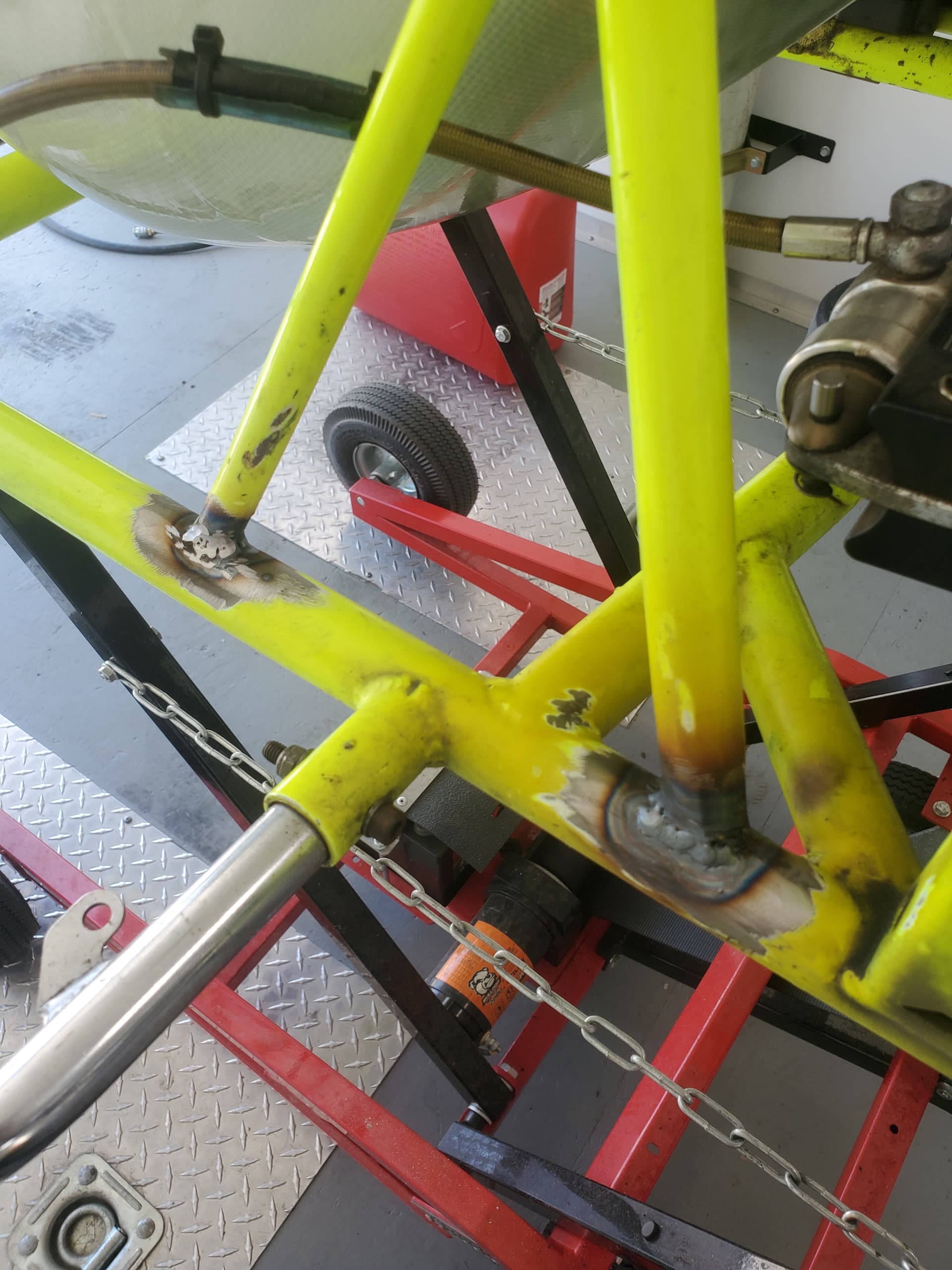

I crack most seat struts out of the box moving it to fit the fatty seat.

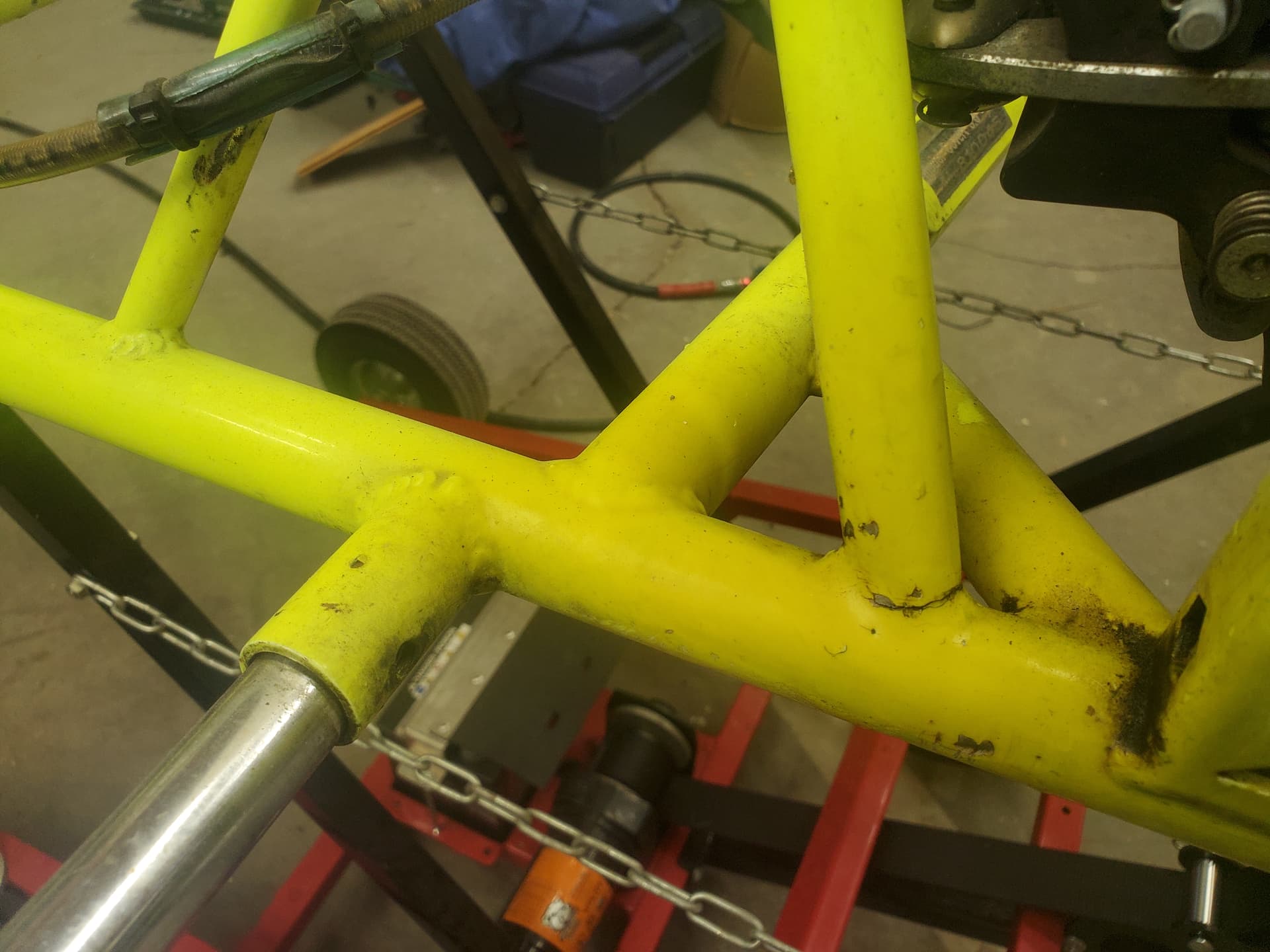

We’ve gone through a few rolls of welding wire on that joint for sure
You are mig welding them?
Yes, sir. Flux core mig welder from Harbor Freight. Just ugly enough we don’t charge anything but plenty strong enough to last a long time.

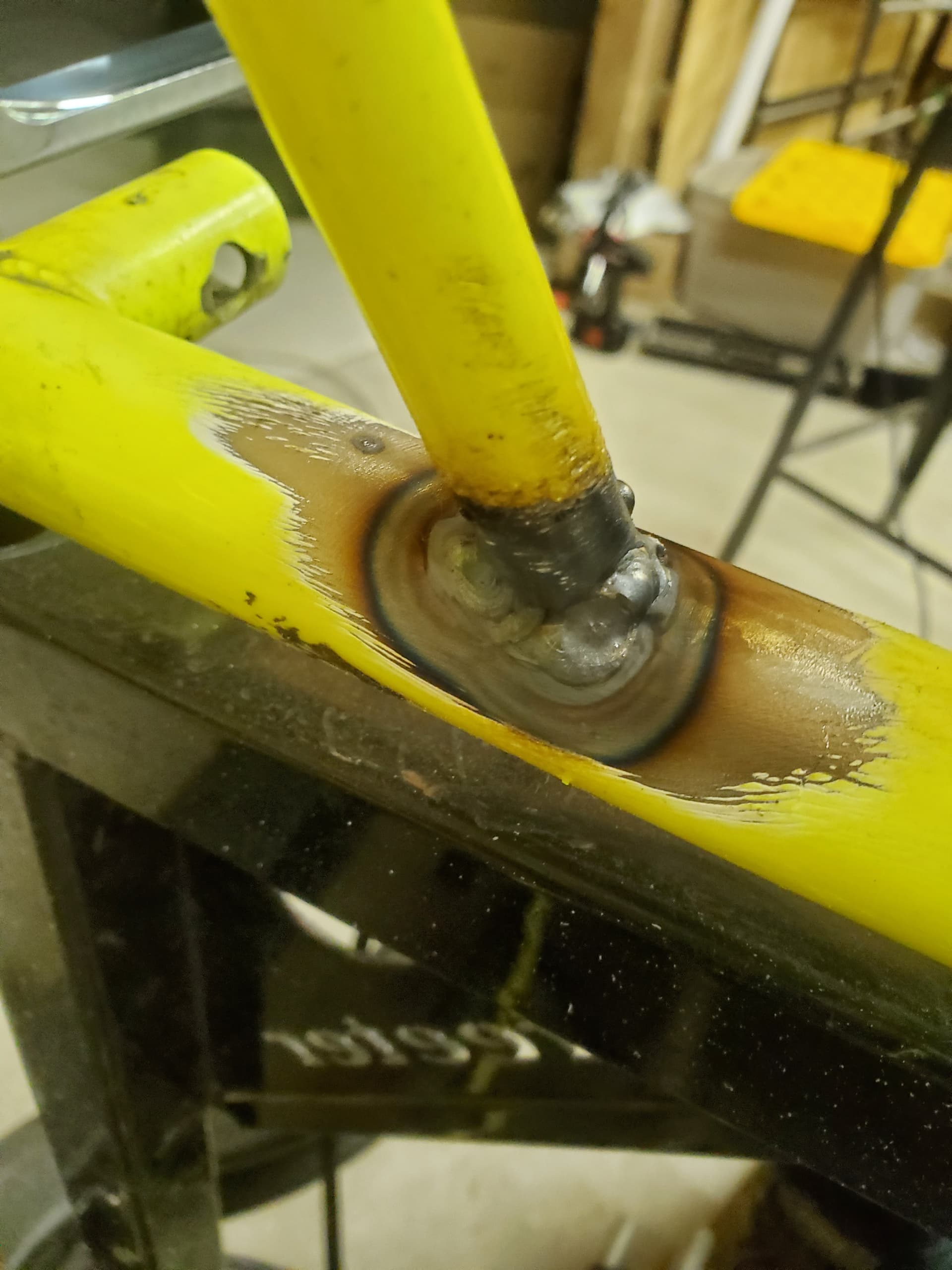

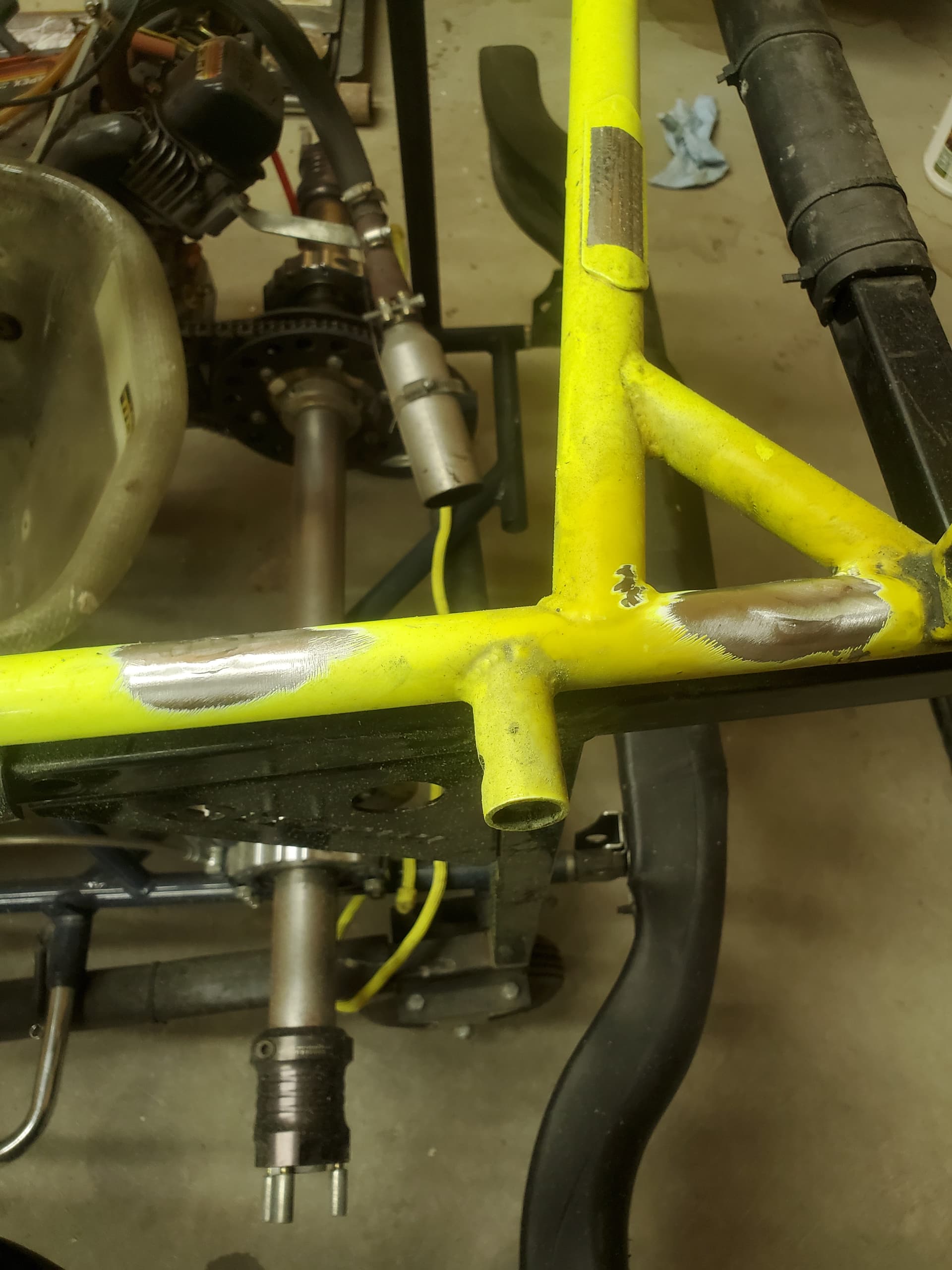

I"ve been practicing for a few days with my Titanium Flux 125. Probably give it a go tonight on my Kart Republic, I’m mostly worried about my settings, since I need to blend the big old bead from the first weld into the tubing, and the thicknesses are different. I do not want to burn a hole in the tubing.
I just had the same issue. No real experience welding but ordered a TIG setup and solved it. Held up all day!
