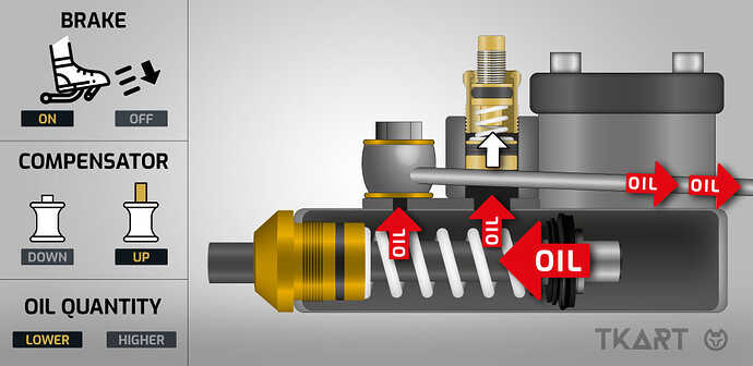

As to ABA from CRG, it has a compensator spring/piston/chamber in the front, 90 degrees angle to the main piston/spring. The spring tension is adjustable (that’s the protruding bit you see from the outside). When you press the brake pedal, part of the oil volume and pressure is taken up by that piston/spring which acts as a chamber with variable volume (regulated by the spring), which is reducing the effective pressure out of the pump to the calipers, until you press hard enough to overcome that spring. In this way you reduce the tendency to lock up as some of the pressure is now dampened, resulting in a less abrupt braking action. The more you pre-compress the spring via the adjustment, the less “dampening” effect you will have.
Interesting solution for sure but contrary to ABS, which essentially works with wheel speed sensors that provide a lockup signal for the system to decrease hydraulic pressure and let wheels regain speed/traction, the ABA is a dampening system that works by modulating the pressure differently, reducing the abruptness of the lockup action, but it will not prevent it as you keep pressing the brake pedal. I’m very curious to test it and see if a driver can feel it and adjust the braking technique accordingly…

So it essentially works by generating rising rate resistance to pedal-piston compression approaching the braking limit. Makes sense.

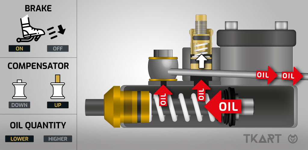

Exactly, google image returned this, much clearer than my wonky explanation
