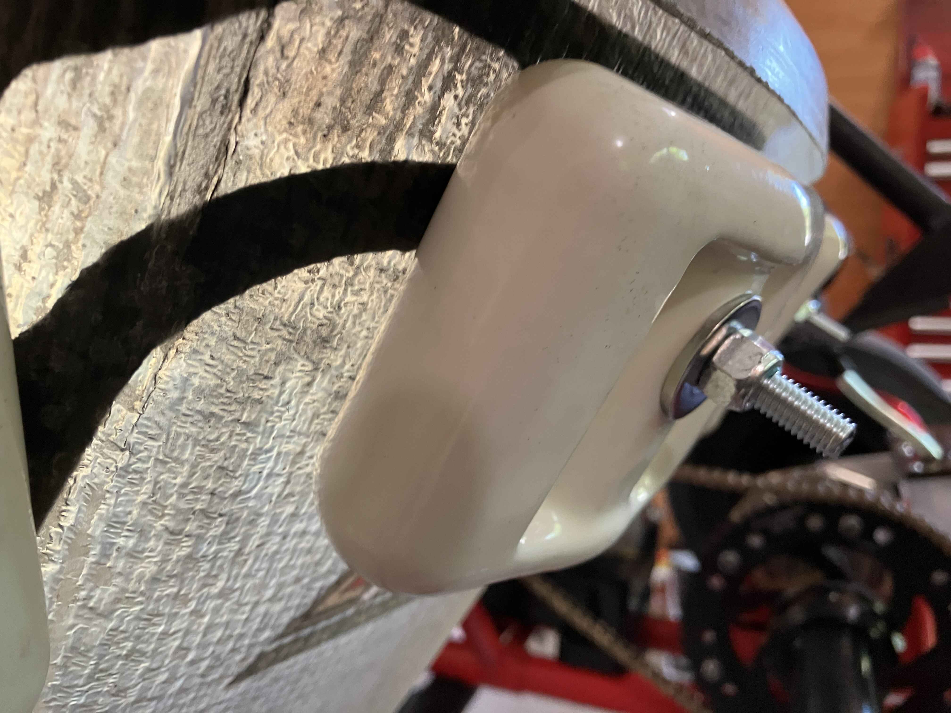

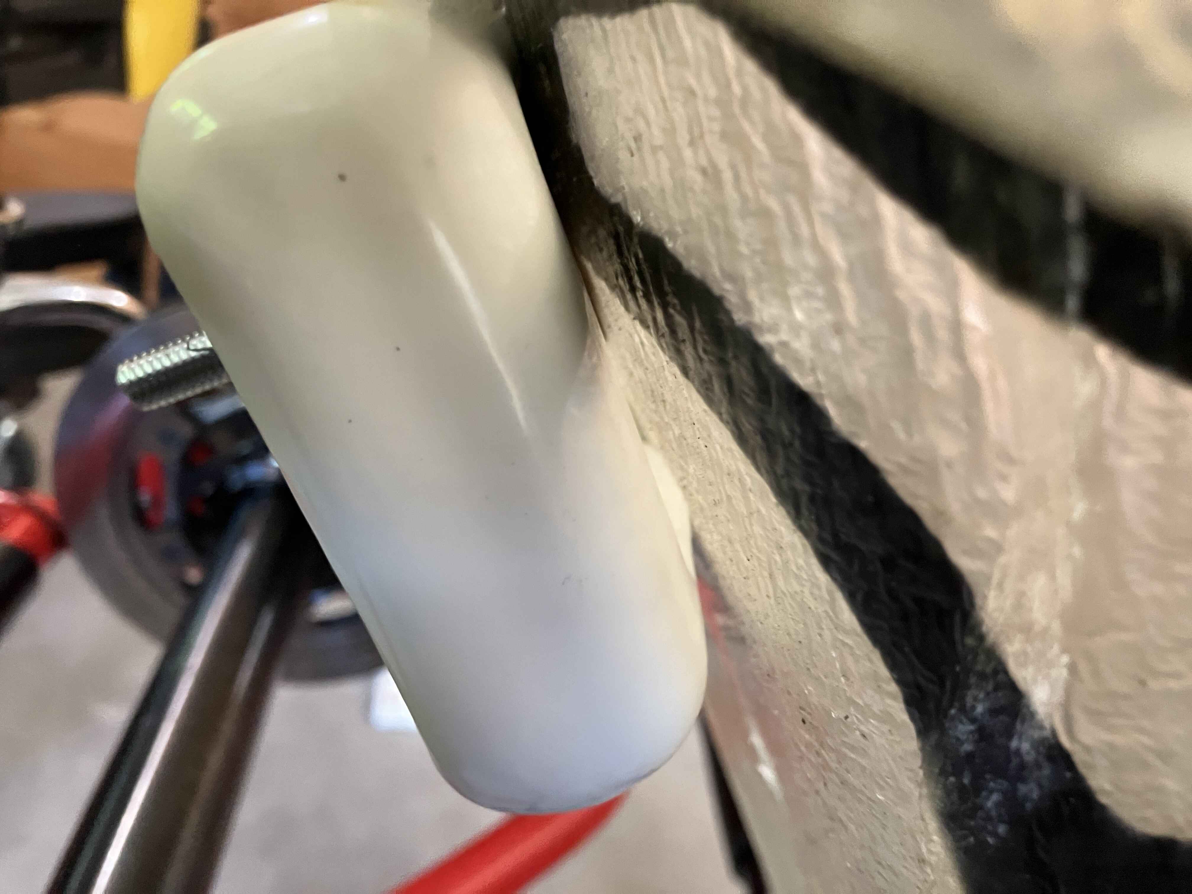

I’m using 3# and 5# scuba weights for ballast. They’re slightly curved.
Should contact between the weight and the seat (or frame) be minimized to reduce any possible stiffening? Or it doesn’t matter?

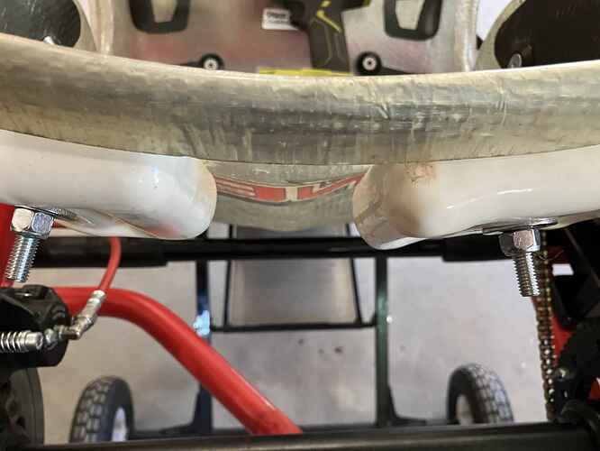

Placed curve-in, there’s a slight gap between the center of the weight and the seat, while the edges are braced against the seat.

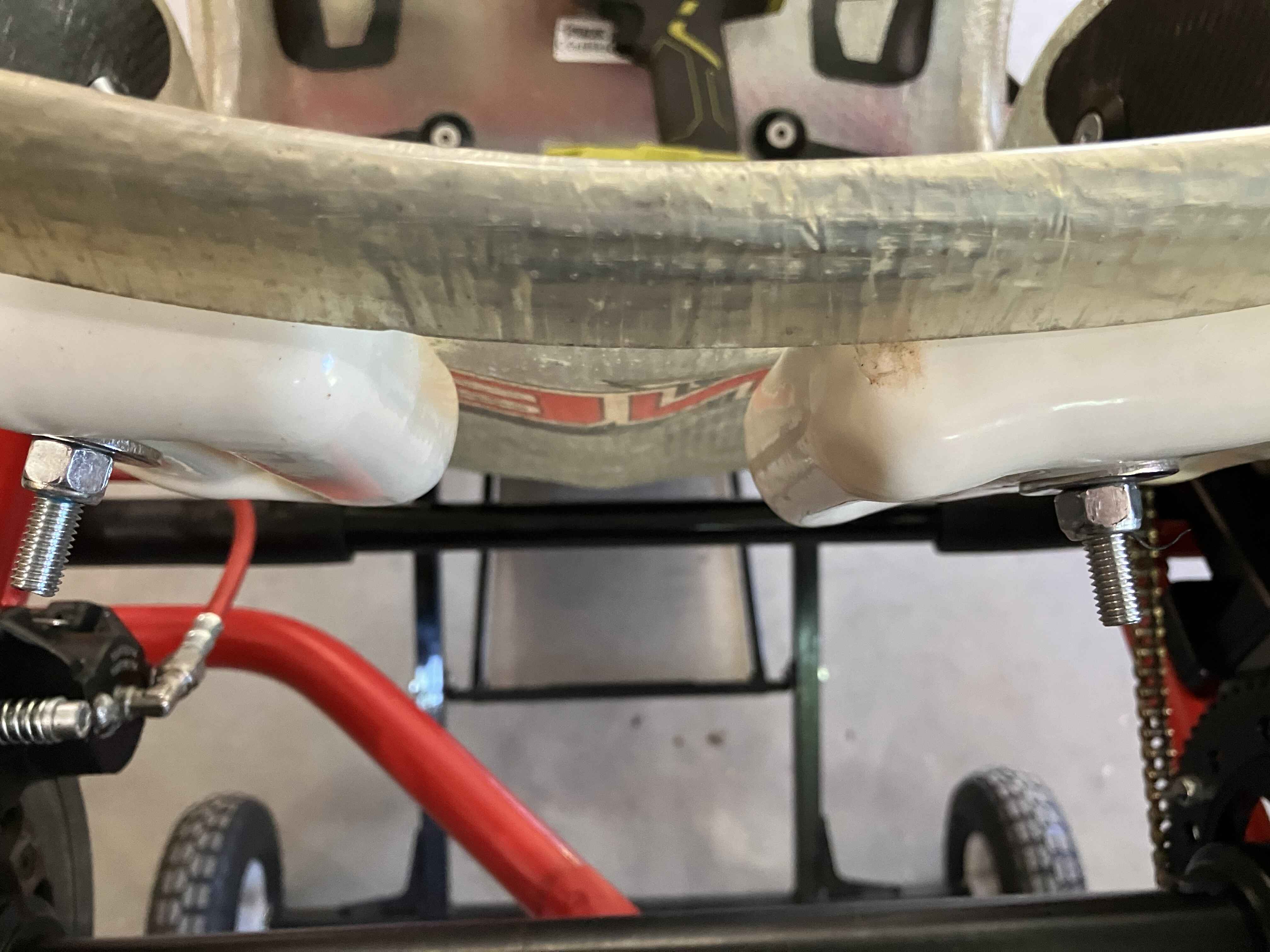

In contrast, if placed curve-out, the center of the weight is in contact, while the edges are not.
And a side-by-side comparison:
If curve-out is better, should contact be further reduced with a washer between the weight and the seat?
Note: I have to add 50+#, so the number of potential contact points is high.

Curve out is how we mount ours. We do put fender washer under though just in case. No issues for a few years now

I got the impression you were saying that the weight isn’t sitting flat against the back, that the weight edge is making contact as opposed to the broader surface. But from the pics it doesn’t seem like there’s an excessive curvature that hinders it making contact. Also, looks like the scuba weight is coated in some sort of rubber surface so even then the edge wouldn’t scrape and wear the seat.

I mount it curved-in, but use rubber washers + fender washers on both sides, so it’s almost flush along the entire length.
