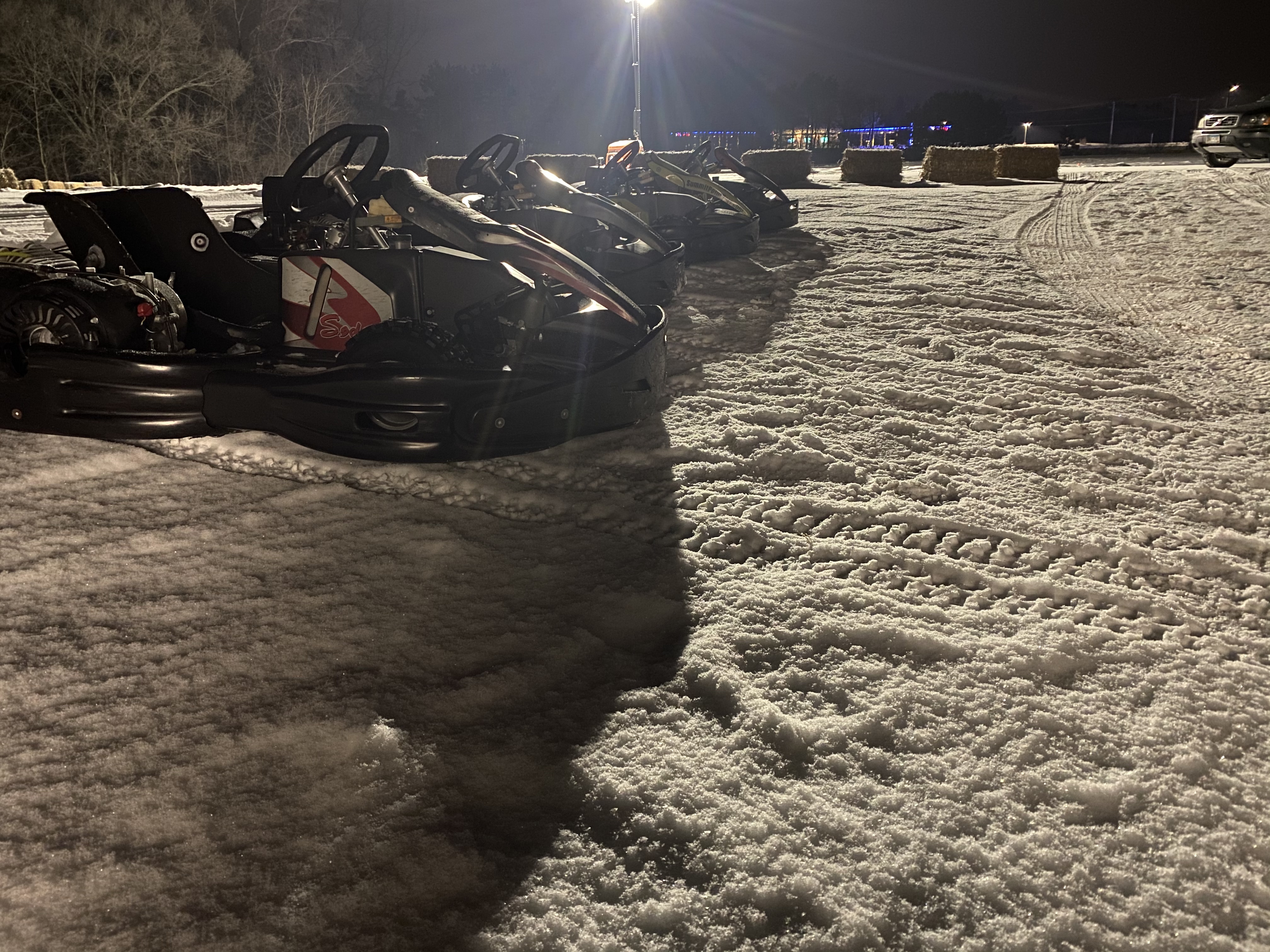

Ripped the band aid off today… It’s go time
Yooooo thats awesome congrats! Wish I could go up there
Awesome!!! I really hope this works for you. It’s such a cool (literally) idea.
Finally some video of the actual karts. It was challenging to find time to shoot with everything else going on, but here’s some “expressions” as the pros would say.
