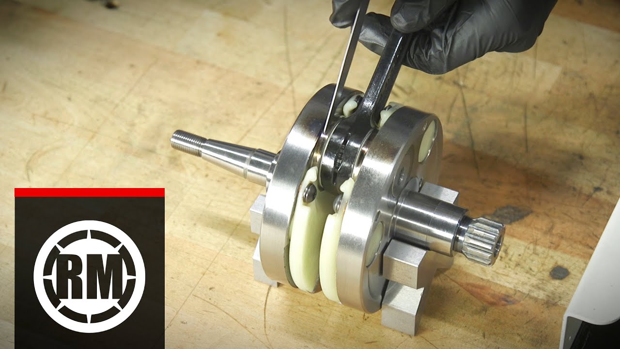

What is the process of measuring the swing?
Dial indicator on the side of the rod at the wrist pin journal (or piston just above the wrist pin bore). Slide the rod all the way to one side of the crank. Then you rock the rod on the big end pin, measuring how much the rod can “swing” on the pin. This directly correlates to the radial clearance of the big end.
It takes a little finesse but you can do it pretty easily once you get the feeling.
For other forum member’s benefit, This video shows it as you’ve written it.
