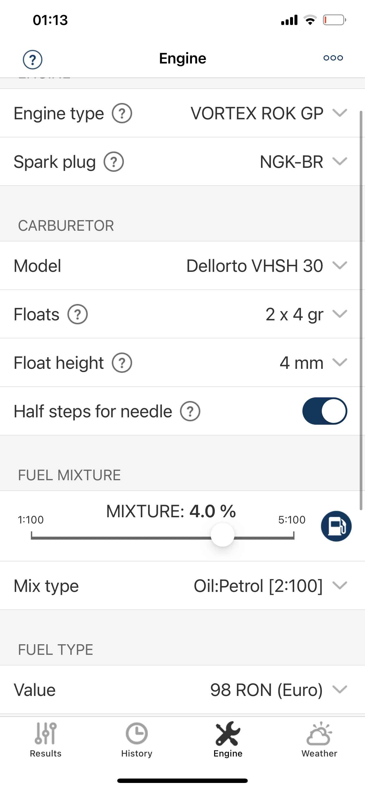

I want to setup my Carb.. but because I am new in this sport i couldnt take risk and do it right away
Does any body use the application of “Jetting Rok”?
With this setup am I going to risk my engine?
I did my setup on that application but i didnt check it on the grid.. !
Engine is Vortex Rok Gp
Carb is Dellorto vhsh30
Weather : 30 degreas celcius
Humidity : %60
Grid has some medium straights
1 tour of grid is 1200 meters
I am wondering Can I believe in this app? Or CAN I USE THIS SETUP?
Any advices ?
Thanks
The RoK and RoK GP are a little different I think. Is it giving you settings specific to the GP?
Yes..
This is what i have done
You can go with those settings provided you make sure you follow the same oil/fuel ratio.

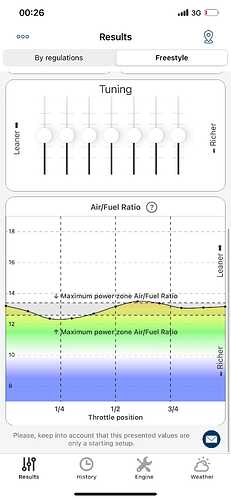

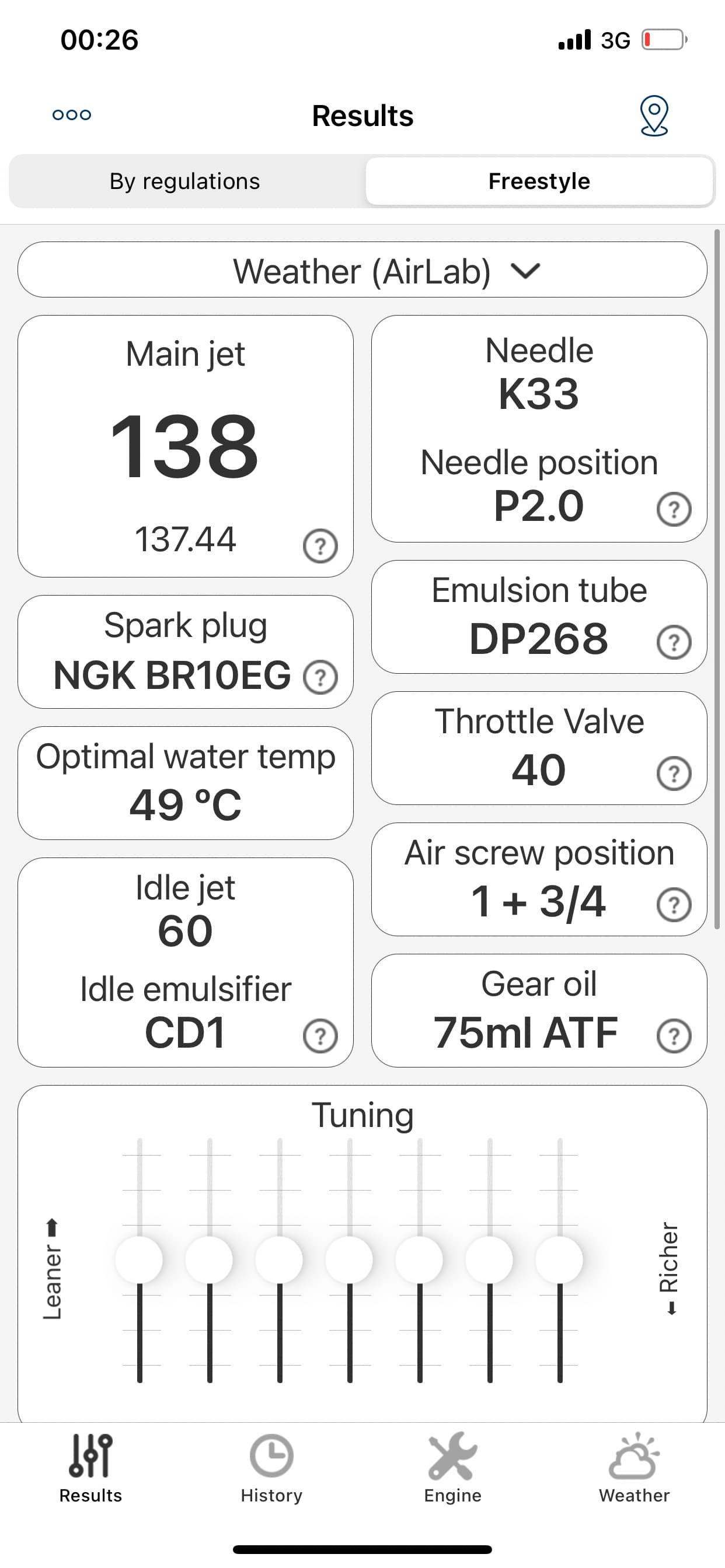

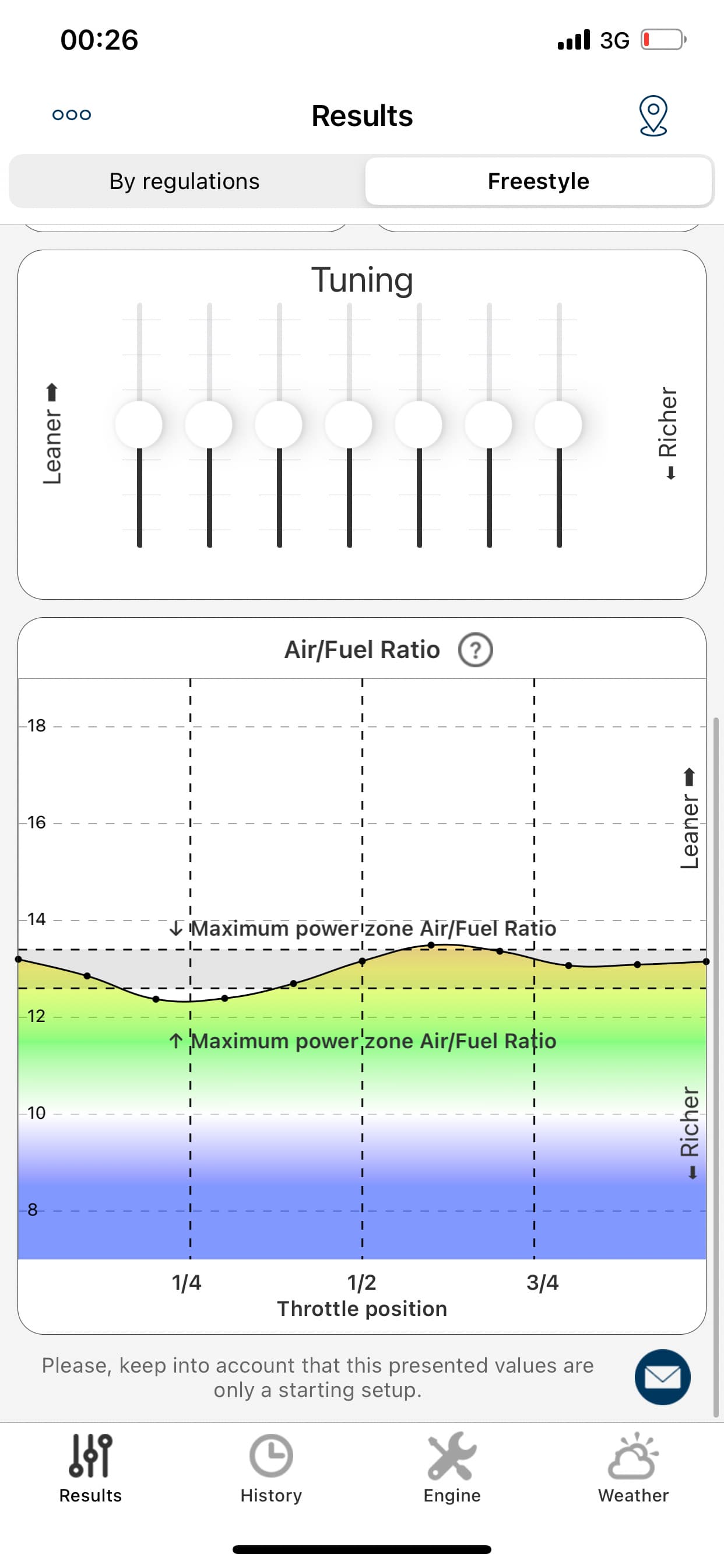

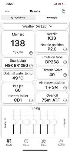

At this point I was getting frustrated. I downloaded the Jetting Rok app listed above and input my specs for engine model, fuel type and oil mix. It then pulled local atmospheric data from the web and return a suggested jet value. To my amazement it called for a 145 main jet. At my last race, the local team mechanic suggested I would only need 2 or 3 jets. This app was now telling me to go up 6 jet sizes from what I originally stated with. I also did not have that. The best I could do was throw in the largest jet I had and raise the needle position to its highest setting and hope I didn’t run it too lean to cause damage.
I ran that setup for the prefinal and the final. The engine did end up revving higher than before and felt like it was making good power, but the EGT temps never really went up by more than 10 or 20*F. Was I just so far off the mark that they could never get close to target? Being new to using and EGT sensor, do the values increase or decrease in a linear function or is it more exponential? I am in North Texas and with the seasons changing, it is not uncommon to be in the upper 30’s one day and in the 80’s (F) the next day. What range of Jets should I be keeping in the tool box to cover both the colder days and the extreme summer temps over 100F ?
In my experience the jetting apps are always very rich. For the cold 30F days you might want to swap out to a BR9 or similar heat range as it’s a hotter plug. For anything over 50F and over a BR10 should be good. It’s been a few years since I’ve run the GP, but I recall the jets being much leaner 130 and below (for my area anyhow). The inner pilot you can change to a B45 and that’s it, definitely recommend doing so if you have a CD1.
Thanks Ricky, I will check which pilot jet I have in there. I can understand the app running a little on the rich side to error on the side of caution. I thought the 145 was way too big, but with the 135 and needle all the way up, it was making better power and I was able to get closer to the rev limiter. So, maybe it was closer to the 145 jet than the 130 jet. :roll_eyes:
