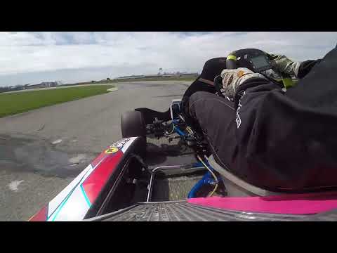

Back to the track these last two weekends heading to NCMP. A track I know pretty well. One thing I’ve noticed since I’ve been back is my inability to brake consistently. At least that’s my theory. I feel like I am over braking in big corners, like I70 corner and Turn 1. It also feels like the kart gets super unstable under braking, often having the rear come out on me. This continues on corner exit, where unless I roll into the throttle, I’m losing the back end.
I’d hate to blame this on kart setup, as I know my driving needs tons of improvement, but the only change I made for what I normally run at NCMP is putting longer rear hubs on (115mm). Normally my kart runs the standard 50mm hubs it came with. Did NOT get a chance to test this theory as it started raining yesterday.
I know longer rear hubs will stiffen my axle, effectively losing some flexibility under braking, but I’d have a hard time believing that this change would have such a dramatic effect on the way the kart handles. Which brings me back to my driving. I have lost tons of confidence in the kart and feel like I’m in the way out there.
Any help here would be greatly appreciated, and if mods need to put this in the Driving Video Feedback thread, please do.
I can’t speak to the specifics of KZ setup but the thing that stands out is how you still aren’t using the whole track enough, so you aren’t really driving the kart near its limit, and because of that the kart is always going to be sort of unpredictable and difficult to diagnose since it isn’t flexing and working as hard as it needs to. In that sense your driving seems consistent at least.
Doubling your rear hub length is quite the change though.
Also are track conditions green? If it rained or it had been a significant time since you were last out the track conditions probably are quite a bit different which could be a big change in feeling or lap time.

  1. Use the entire track (specifically on exit) – if you are “choking off” the track by not using everything on entry and exit you are essentially diagnosing a false problem. Use the whole track.
  2. Inconsistent braking – go back to day 1 driving school and make sure all of your braking points are being done in the same place. Place a cone on track if you need to for reference. Ensure your system is bled and everything is working correctly. Mechanical consistency is the precursor to driver consistency.
I often find going back to basics before diving into a giant setup change is the best way to eliminate variables quickly. Driver error is the cause of a lot of problems in my coaching experience. Others can speak to setup specifics much better than me when it comes to karting, but I always start with driver consistency and mechanical consistency.
If possible I would have a driver with trust worthy feedback have a go and compare. But make sure your basics are in order first with regard to braking in the same spots every time.
Over slowing for a corner is often mental.
I’ll just chip in here to say to remember to push yourself back in the seat at the braking points - you want your weight as far back as you can get it and putting some pressure into the foot rests will help you do that as well as help the chassis work for you more.
Also, and this came up for me recently - brake fluid on these karts truly are consumables that have a finite life, and it may not be 100% obvious that it’s a problem (e.g,. the brakes still work technically, just at a far reduced level both in feel and outright performance). If you’re doing everything correctly’ish and nothing much has changed on the kart, it’s possible that your brakes just need some maintenance - flush the system with new fluid (easier than it sounds what you get the hang of it), and make sure the pads didn’t have something weird happen with them. Good luck!
I’ll echo the recommendations to bleed the brakes, check the pads (make sure correct compounds are installed), and dial in your bias. Looks like too much rear.
Also double check front alignment, as the chassis looks a bit twitchy.
Braking at the top of the hill into I-70 on coldish tires is always going to be sketchy. You need to brake after the crest of the hill so the kart isn’t unloaded when you go to hit the brake pedal.
