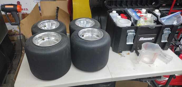

With the addition of a radiator fan I built a new wiring harness for the Danger Dorito. Took some time, and I hate wiring but I’m happy with how it came out. Also got tire prep all done. Got some minor odds and ends to tie up and load up for this weekend. Have 1 kid kart, 4 KT karts, and my Danger Dorito UAS kart heading to Salem for some dirt track action.
