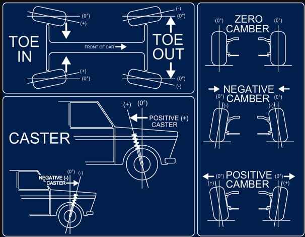

I have one more question which confuses me… difference between CAMBER and TOE. Does it have to do with adjusting Kingpin(camber) and Tie rods(toe) ?
tjkoyen
(TJ Koyen)
June 10, 2026, 1:02pm
14
Toe is adjusted with the tie rods, camber with the kingpin pills, correct.
I don’t have a good diagram outlining toe / camber / caster for a kart, but here is a diagram for a car.
You obviously cannot adjust toe / camber / caster in the rear wheels of a kart like you can in a car.
There are many good videos on YouTube (Power Republic, KartClass, etc.) on adjusting these items in a kart. How / when / why to adjust each.
