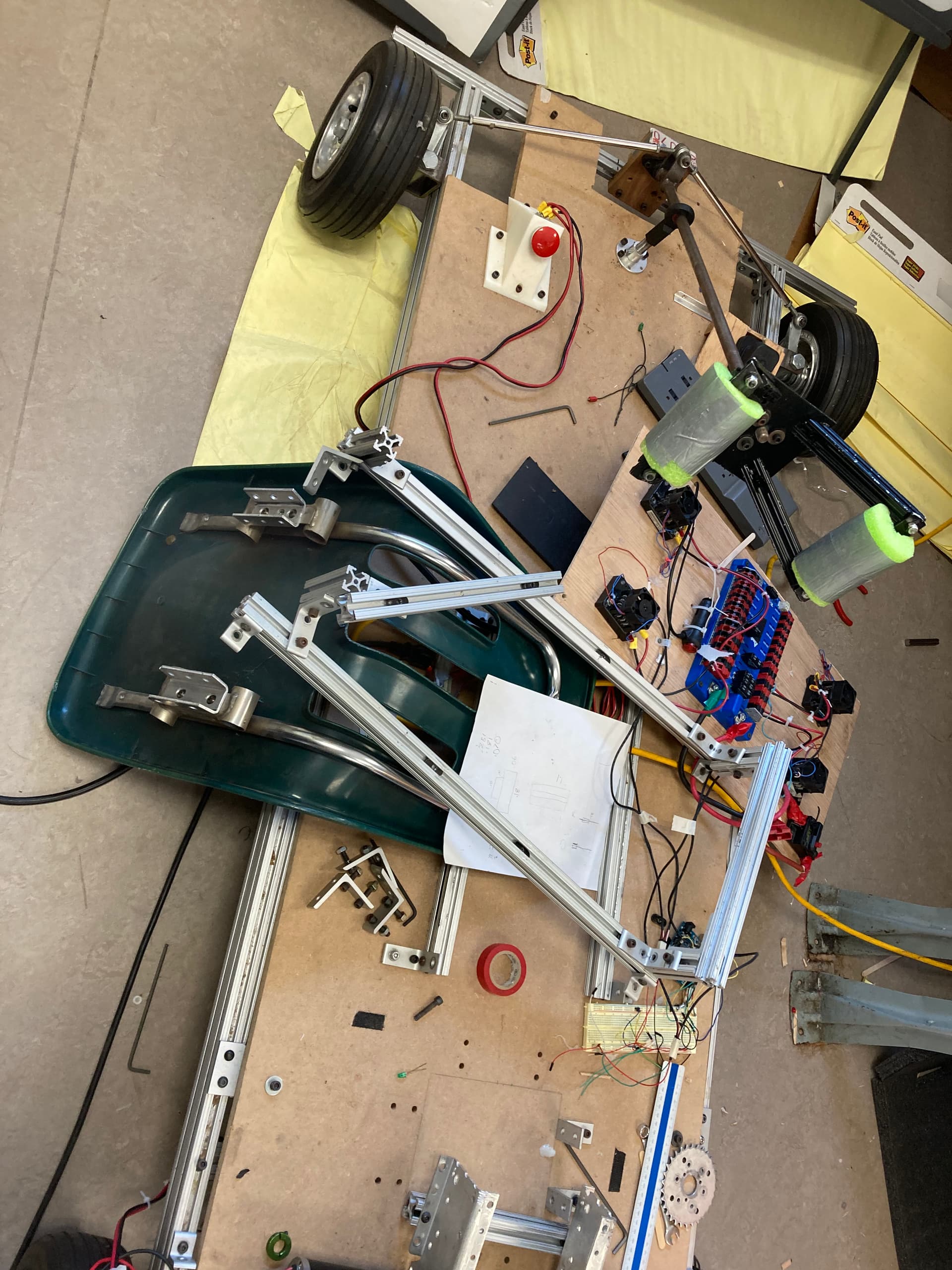

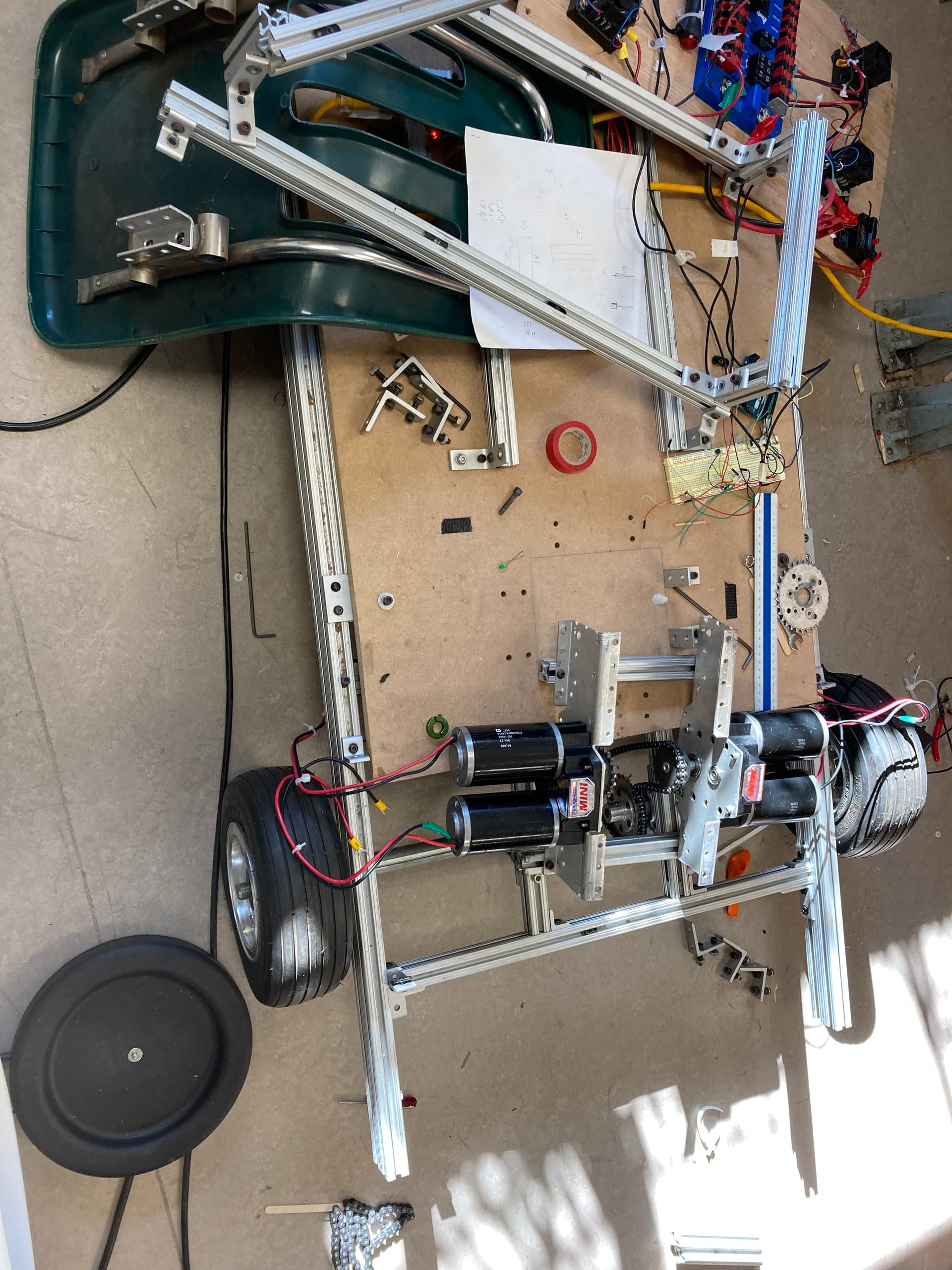

Fortunately another student made an… effort at an electric kart. It’s very much a mess and I’m trying to make it actually work atm. So maybe if I get this done I’ll have some good knowledge and experience.
So 80/20 aluminum used to make sim rigs appears to be chassis.
Indeed. It’s missing screws, half of it isn’t tightened, one of the motors was mounted wrong in the gearbox thing, nothing fits, it’s a mess. I just machined a motor mount yesterday so hopefully it comes out looking good. Maybe I could try and make my own sim rig?
