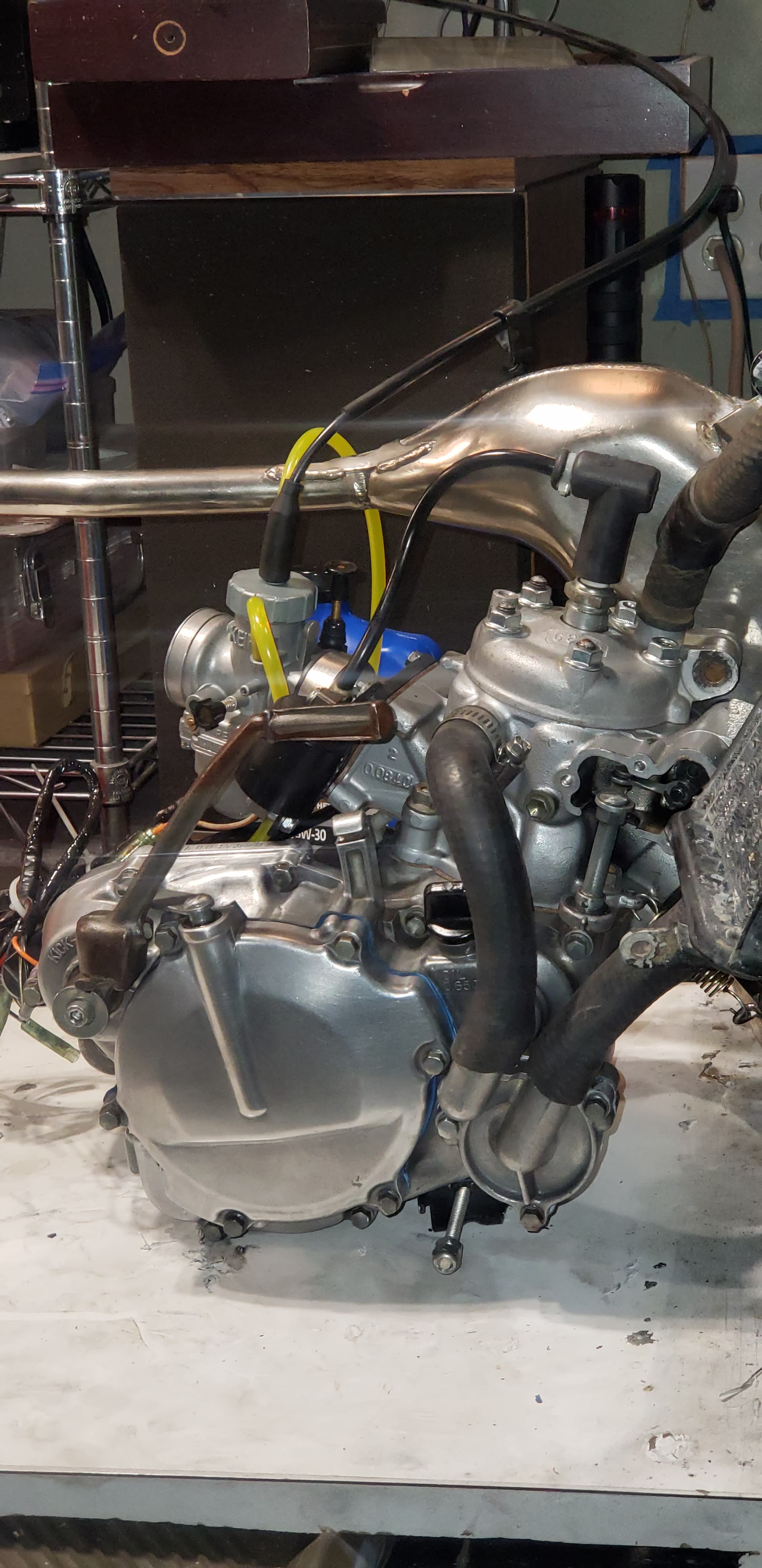

hello fellow speedfreaks, i have a question re: angle of attack. i couldnt find a decent motor mount for my kx 85 so ive decided to make my own using the lost foam process and needed to know how tall to make the rear mount to achieve the correct angle. Thanks to all and happy karting!
In the absence of any other feedback, parallel to rails would be fine. ie no angle. Verify you have sufficient arm room and clearance around the chain to the case and you should be good to go.
Excellent. Thank you! How about in relation to the rear axle? I thought i read somewhere that you want your drive sprocket as close to being level with the rear axle as possible. is this true?

The cadet shifter is a YZ65. I think the engine is installed level front to back.

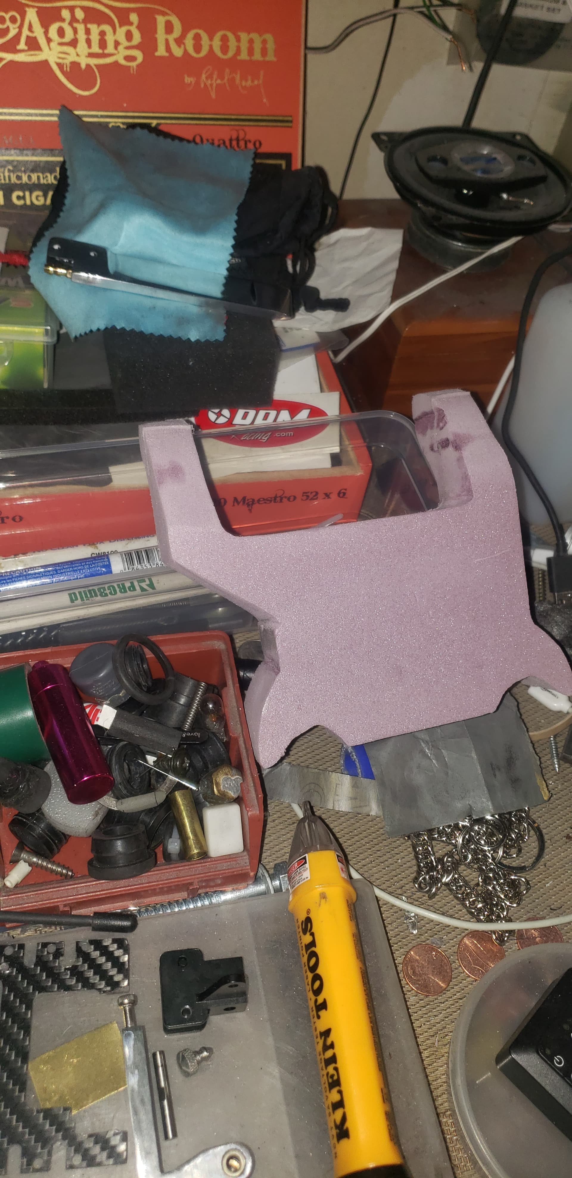

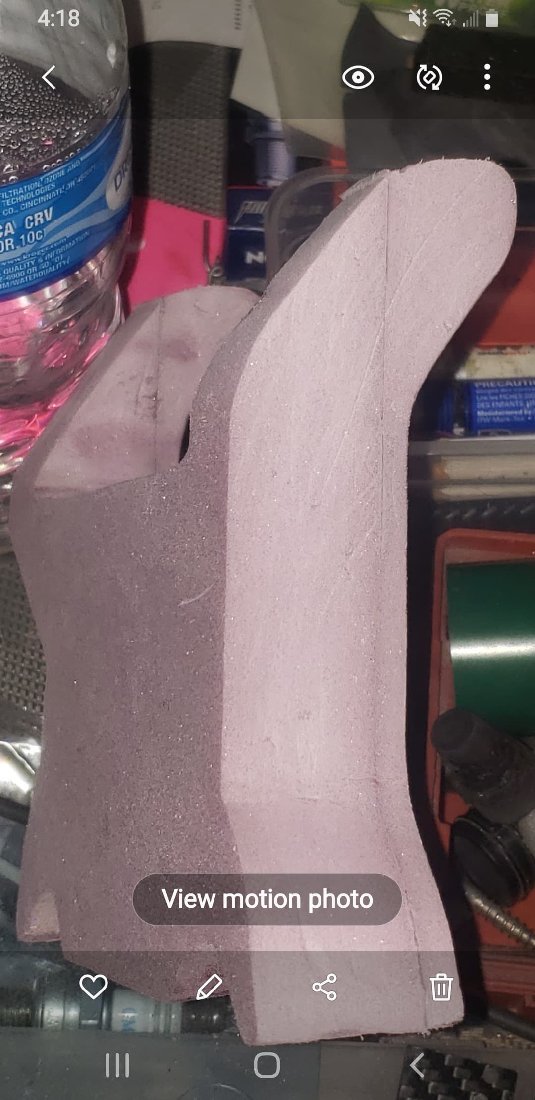

Thank you all for the leads. I will follow up on them and reporr my findings. In the meantime, I attempted my first foam hot wire cut of the rear of the mount. still have some shaping and cleaning up to do on it with sanding. This is just a practice run and will attempt another one soon.
