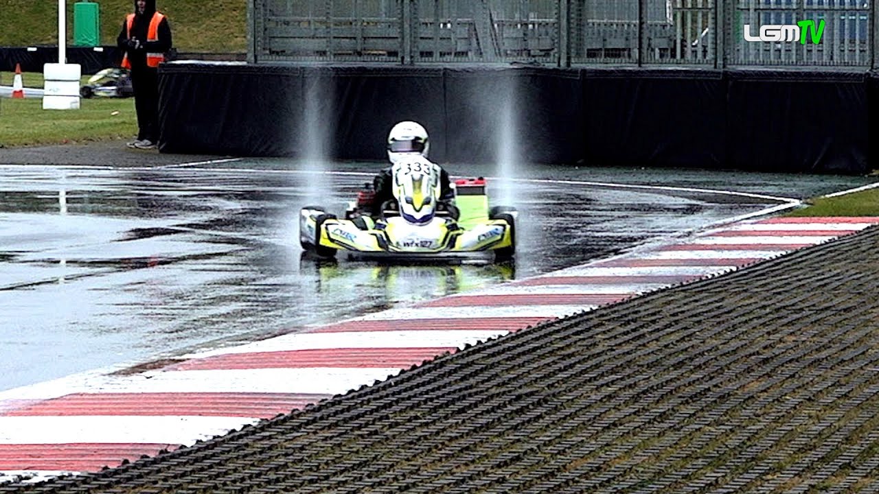

I’ll post my favorite pic of me for the billionth time on here:
As James said, you don’t always need to be this aggressive, you need to have a very good feel for the grip limit of the tires at all times. Sometimes you need to coax the kart into the corner softly, sometimes you need to physically force it to work. But my experience is the fast guys are really charging the entry to the corner in the rain. Mediocre and slow guys are too cautious and always drive too far under the tire limit to make sure they don’t spin or go out of control.

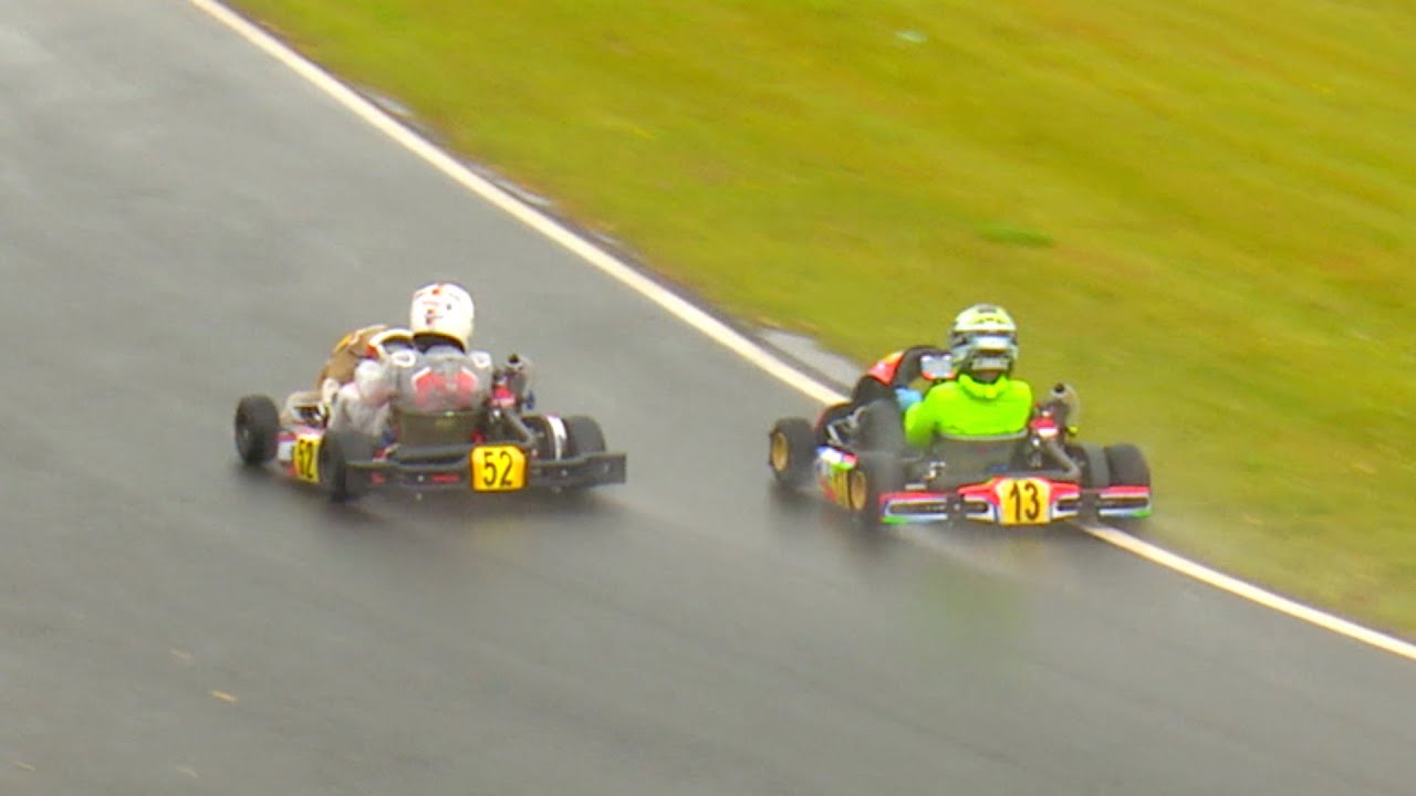

Fantastic battle in the middle video between Corking and Wilkins (spelling? sorry). Really interesting tactically. Outside vs inside lines, frequent over and unders.
