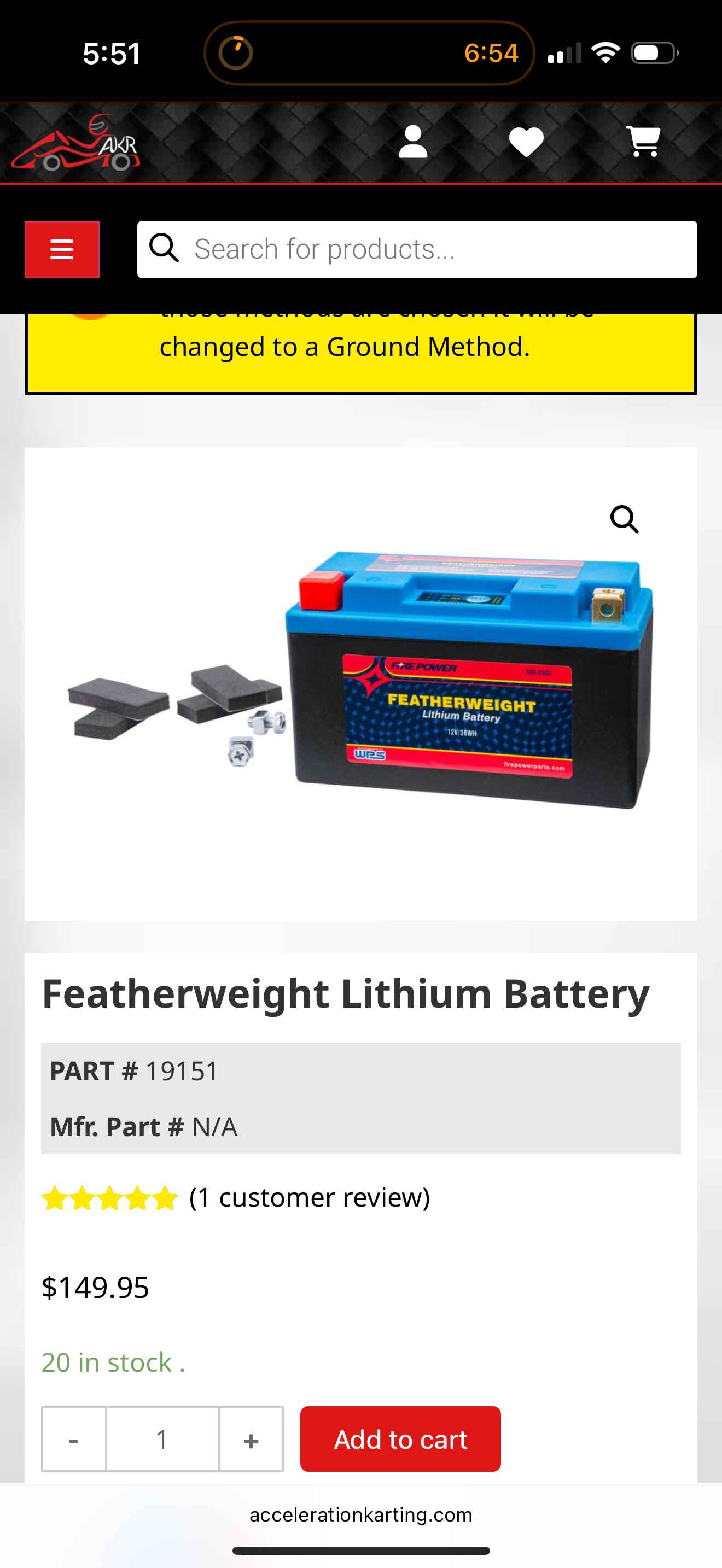

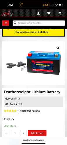

Hello Everyone.
Just messing around with parts to cut weight. I’ve seen this featherweight battery for a while.
Only thing is will it work with an X30, since it has a positive negative connection that uses a screw and nut (similar to my Coleman starter).
I take it I need to make a change to the x30 wiring so it fits, or is there an easier way? If so what connectors would work?
Also open to feedback/input on it if anyone has used one.

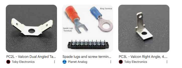

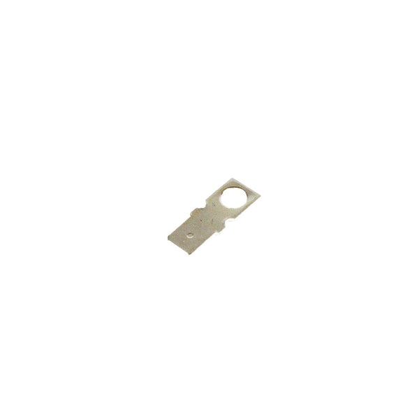

Just need to get your self a spade to screw terminal and it should be fine to work
You can bend these to whatever angle you’d desire and should work with a KA/x30 harness.
Thank you both so much. Simple now that you show it.
