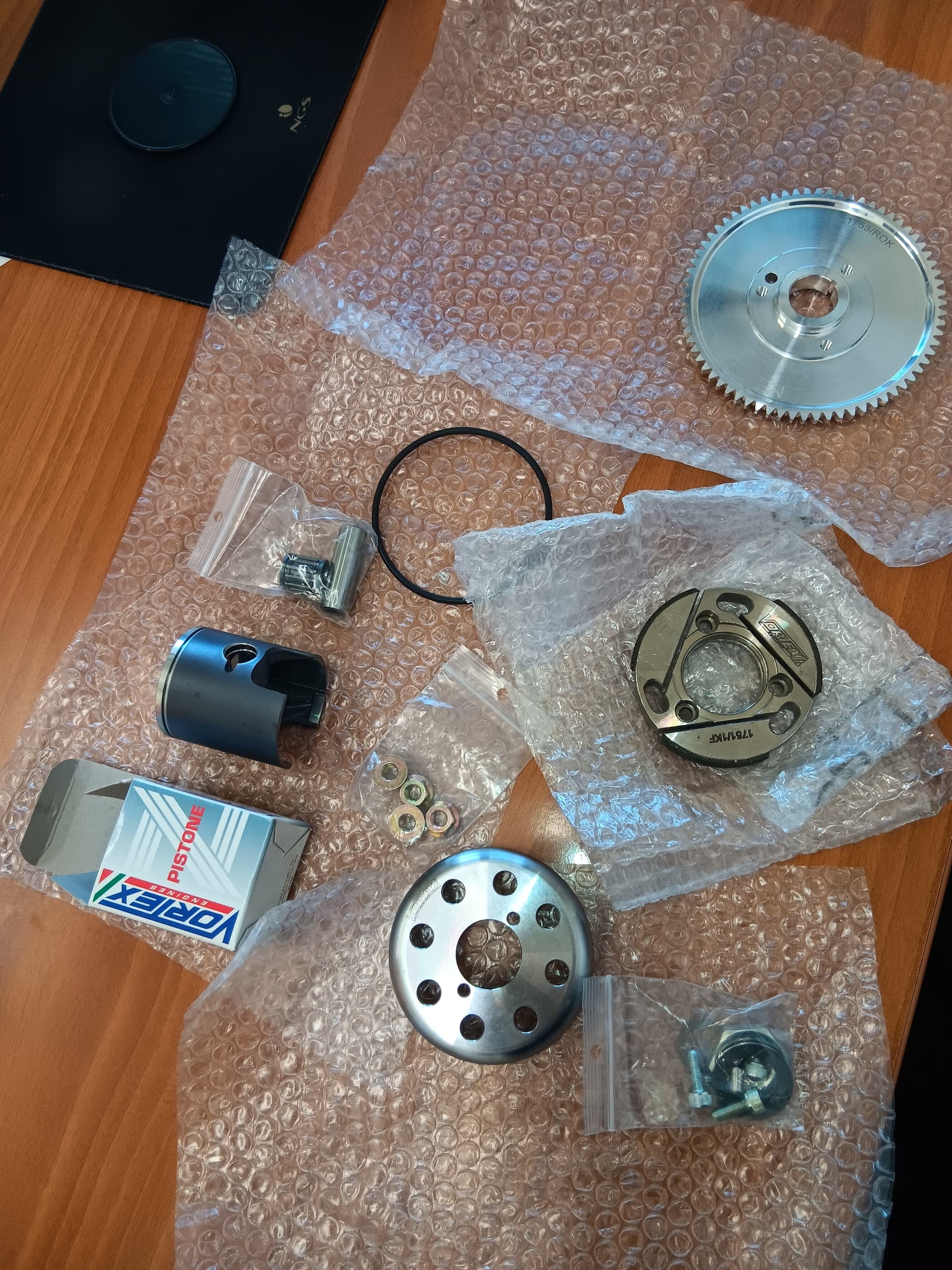

the next step on the rok path as we all know in here i was on it too before you , is the upgrade from the old time clutch type to the new one .
the second choice is better and stronger and with to springs to break .
What will I need to buy to make the clutch fit onto my engine that uses the springed clutch? Also, is the extra 100 euros for a newer clutch really worth it?
check the scematics from this page . the whole upgrade kit is under those to see what you need .
you can buy those from many ventors around europe
Thank you very much! Do you notice any difference with the new clutch while driving or is it more for reliability?
More.reliability is the real deal , and i think the new set what something small better in performance but thats maybe my mind playing games . Or the better performance was just because it was a new set of fresh clutch
Will my pinion and cage from the old clutch drum fit onto the new one or will i have to buy a new one?
Νο nothing from the old type is usable .
Check the kit package and you can see the only think left the same is the bare side of your crankshaft, everything alse will change . And the gear for the electric starter bendix also .
On Kartstore you can find a complete kit to retrofit the new style clutch, as well as a replacement old style clutch. I would not bother and safe the money and go with what is already on the motor.
