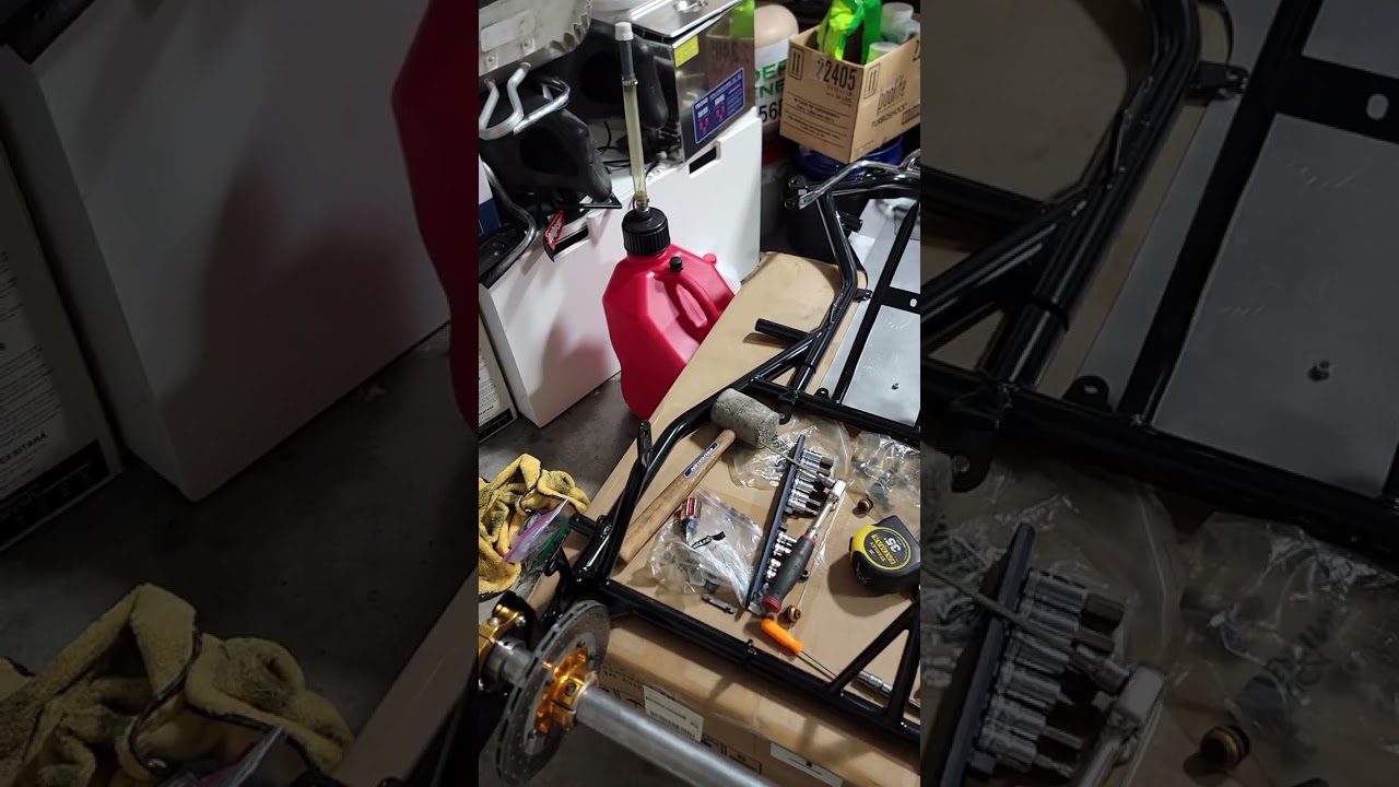

New update and a couple of questions.
Got the kart stripped, blasted and powder coated. Its coming along nicely. Spent a lot of time cleaning up all the rusty chrome. Some is not salvageable. Its in good structural form but some of the more crusty bars are too nasty to put on the fresh chassis. May have to find a pair of KG unico nerf bars.
Im replacing every bearing on the kart. Today i spent some time setting up the rear axle with the new bearings. Are fresh new bearings a bit draggy? Axle spins but not as freely as ive seen. Im sure its fine.
Still need to get lots more hardware. Every nut and bolt on this were crispy and ultasonic cleaning didnt help much. Do you guys use stainless hardware? I got some stainless hdw for the rear axle cassettes from my local hdw store, 9 bolts washers ans nuts set me back 45 bucks. Ouch.
Still need to get a rear bumper and mounts to replace the rear bumper bar. Also new graphics. I reached out to OMX about a KG Unico graphics kit. Theyre saying to order a Stilo kit but doesnt seem the same as mine from the images i can find.
Im absolutely loving this project. Ive always wanted a kart and rebuilding this is and learning about karts is just so much more enjoyable.
The hardware store is going to be your most expensive option. I have had good luck with Amazon and eBay (seller Monster Bolt) and McMaster Carr are all good options. Stainless isn’t necessary unless it will be stored in a damp location.
Fresh bearings will be very tight. They will run in with use. Make sure the axle slides in the bearings before tightening the set screws.
Also, the sprocket will likely not work as it is too large of a diameter and will high side on kerbs or when you go off track.
Barbie drift bike is :fire:
Lucky kid.
You likely will not want or need the center bearing, especially in 206. Some will leave it in so it is loose to the frame (no bolts). In watching your video I see it is a one piece sprocket. That will make any change of gear much harder as you will have to slide the axle out. The two piece will allow gear changes without doing this. You may want to consider a sprocket guard as well.
Personally, I would stay away from stainless hardware; it’s for boats and lawn furniture. Unless you get REALLY expensive stainless hardware, It’s generally not as strong as a decent grade of alloy steel at a fraction of the price. I usually try to get cadmium or zinc plated alloy steel hardware. The plating keeps the corrosion to a minimum vs. the more standard black oxide coating. Mcmaster-Carr is your best friend…
