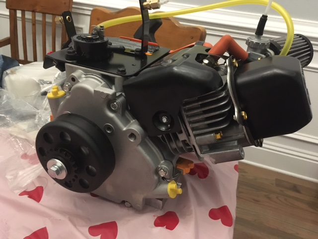

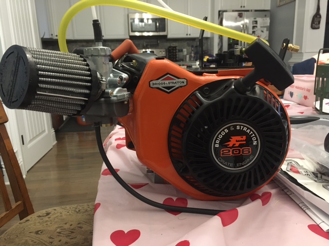

So my new 206 came in the mail so today I did my best impression of a monkey Fu#king a football as I tried to piece things together on my kitchen table. I used flame proof paint on the exhaust and the muffler (not shown) but it dawned on me when you order these kind of parts, fasteners don’t seem to be included (which is pretty lame IMHO) so tomorrow I’ll be off to the hardware store as I source fuel lines, bolts, washers, clamps, etc. . . . (Lucky for me I had some extra fuel line laying around from a mini bike project) I also installed the Hillard Inferno clutch.

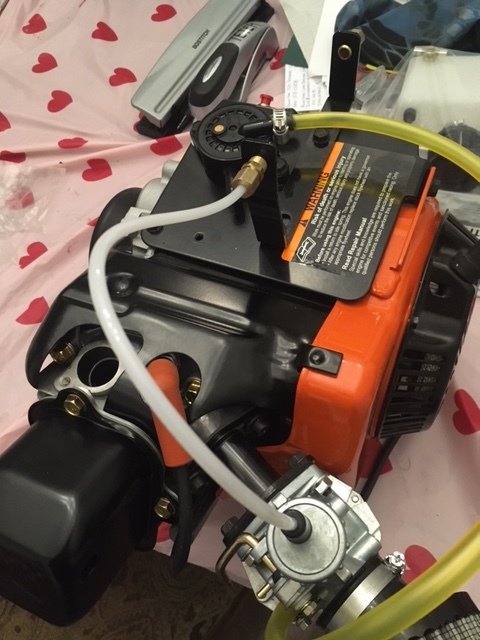

I am scratching my head regarding two things. Throttle cable into the carb, and just the throttle set up in general. Lots of small parts in the kit, but no instructions from TSracing.com, just a fadded picture included the size of a business card.
I have a similar throttle setup. Basically it’s two cables. One short cable that (usually) stays on the engine/carb, the other goes all the way to the pedals.
There should be a quick release hook/clip to join the two cables together somewhere in the middle of the two brackets.

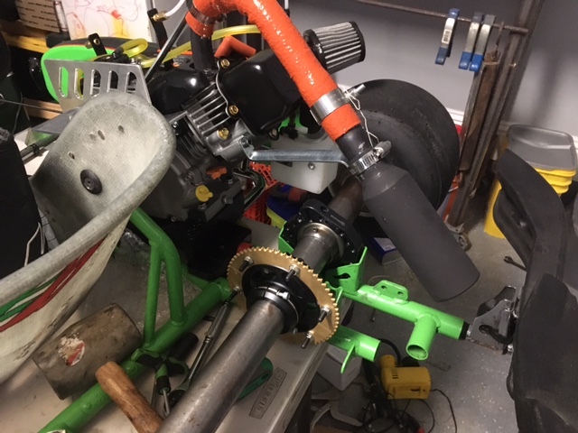

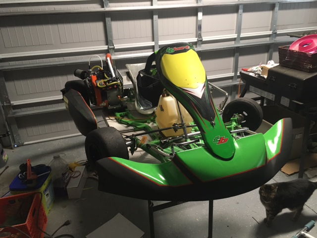

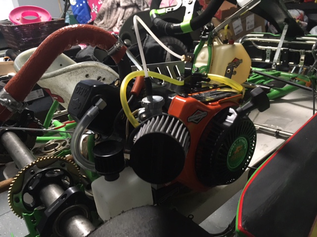

So I spent some time yesterday and got the engine mated up to the chassis. I replaced the rear sprocket and sprocket mount, as the old one was stripped out pretty bad and the mounting holes were oval in shape from age. I’m still playing with the catch can, as its a two bolt mounting system but I just have it mated to the engine with one bolt. Maybe I’m missing a mounting bracket of some kind?
I think the only items I have left is to cut and install the 219 chain, figure out how to rig the throttle cable, fill it with oil, and finally start the break in process on the engine.
I did notice my exhaust looks a bit different than most I’ve seen, that tend to sweep back and at an angle. Whereas mine just shoots straight back. I have no idea if I’ll need to swap that out later?

Air and gas and you are good to go! I have seen lo206 exhausts pointing in all sorts of directions. Maybe someone knows if it matters. It’s gonna take me a bit to get used to the chain/sprocket being on the inside.
Crap, did I mount it wrong . . . didn’t have a sprocket on it when I got, so I wasn’t sure which side it went on.
Not at all, the 206 is an inboard engine (sprocket toward the seat), I think dom is referring to not being used to it because most 2 strokes run outboard engines (sprocket toward the rear right wheel). The way you mounted the sprocket is on the correct side for your motor.
