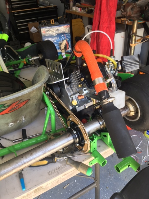

Do have a question related to the throttle cable. How much travel is it suppose to have? It seems like mine has about 1/8 inch of total travel from idle to full throttle. Don’t know if thats right?
Throttle travel should be about 3/4" - take the air filter off and make sure that the slide is closing and opening all the way.

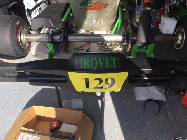

Get good enough at pulling the axle out, and file off the burs at the setscrews, and you’ll be able to pull the axle and change a 1-piece sprocket almost as fast as you can now change a 2-piece. That way you’ll be able to not worry about whether the two pieces are aligned.

You may want to get the sprint kart 206 header, the one you have that comes straight back is generally for oval karts. Appears to be pointed straight at your bumper, and can certainly melt it. The sprint version has a bend to the left.
:100:Great catch! :100:
Did exactly what you sugguested, worked like a charm. Thanks.
Also ordered a wrap around exhaust.
