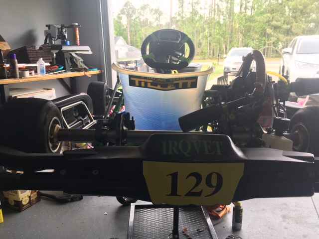

I still have a few things I need to button up on my chassis. Its currently down as I wait for replacement brake bolts. But in the meantime, I need to figure out why I have a slight bind going on with the rear end. I was looking at it yesterday and I noticed the inner brake pad is way more warn than the outter side. Like 70/30% left on either side.
Not super knowledgable on floating brakes. I tried to snug up some bolts on the brake carrier and I guess I had a bit of a gorilla grip on them and they sheared off. (Insert Homer Simpson voice here)
Do"h
So I’m going to loosen everything up back there and try to determine if the bind is coming from the brakes or if something else is going on.

My two best suggestions would be to bleed the brake system and make sure the rotor is centered between the pads when they are at rest.
An air bubble in the system will now allow the pads to engage with equal pressure and one pad will wear faster than the other. (ask me how I know)
Using your hand, depress the brake pedal and watch the pads as they contact the rotor. If one side looks to touch before the other, you may need to adjust the rotor side to side until they are equal. If the pads do not back off the same amount as well could be a sign of something wrong with the caliper. Either Air in the system or gunk in the seals. There are rebuild kits available to replace the seals in the calipers.

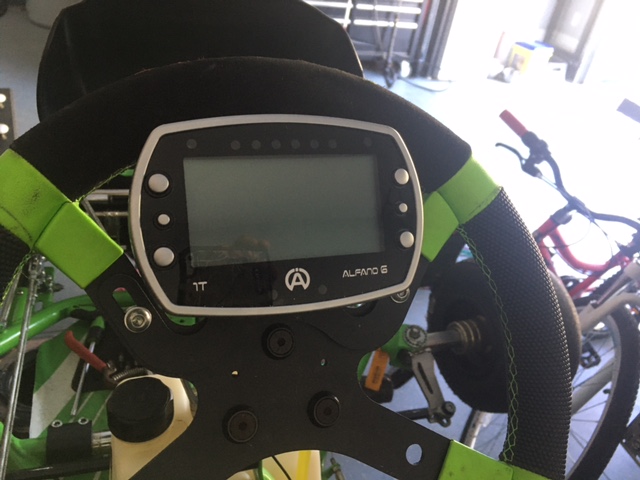

So I disassembled the entire rear end and checked alignment on everything. Changed the brake pads, and things are alot smoother now- now that everything is lubed up and realigned. I also got my Alfano totally hooked up with the addition of the head temp sensor. Once my new brake bolts and rims come in, I’ll mount the new tires and hoepfully be good to hook for next week at CKNA!

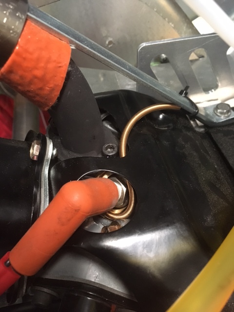

I like getting bolts from Suburban Bolt in Roseville MI, because they will drill either the head or the shank for me for safety wire. They will even drill Allen-head bolts for wire, which is a nasty job.

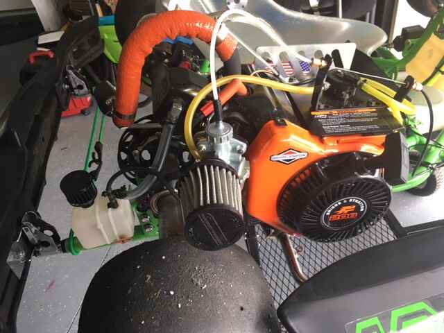

Damage Assessment:
  • Burn out clutch
  • Bent intake manifold
  • Broken carb cap
  • Bent sprocket guard
  • Damaged air cleaner
  • Underside of the Chassis got scraped up as he sent me over the curb
