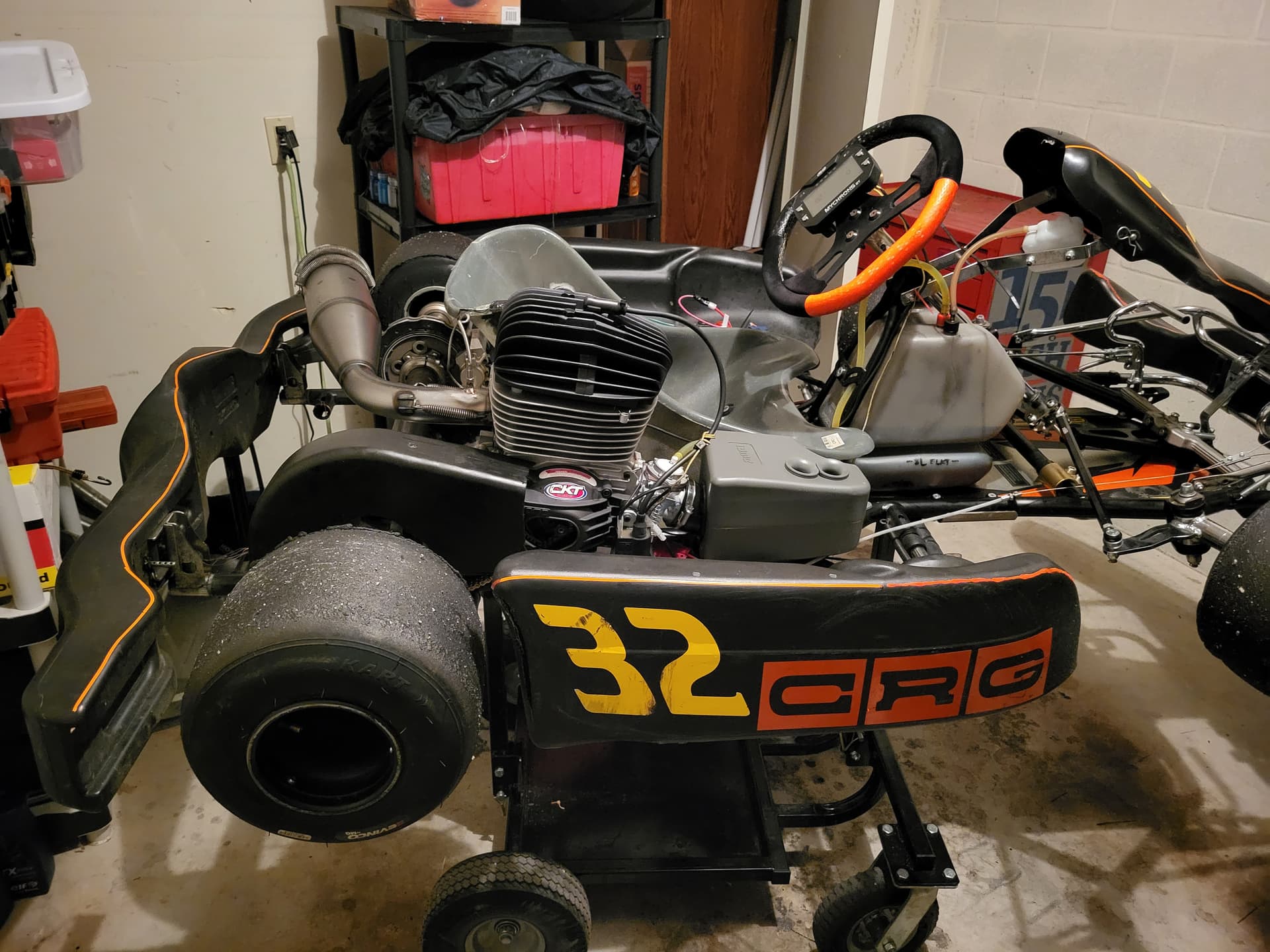

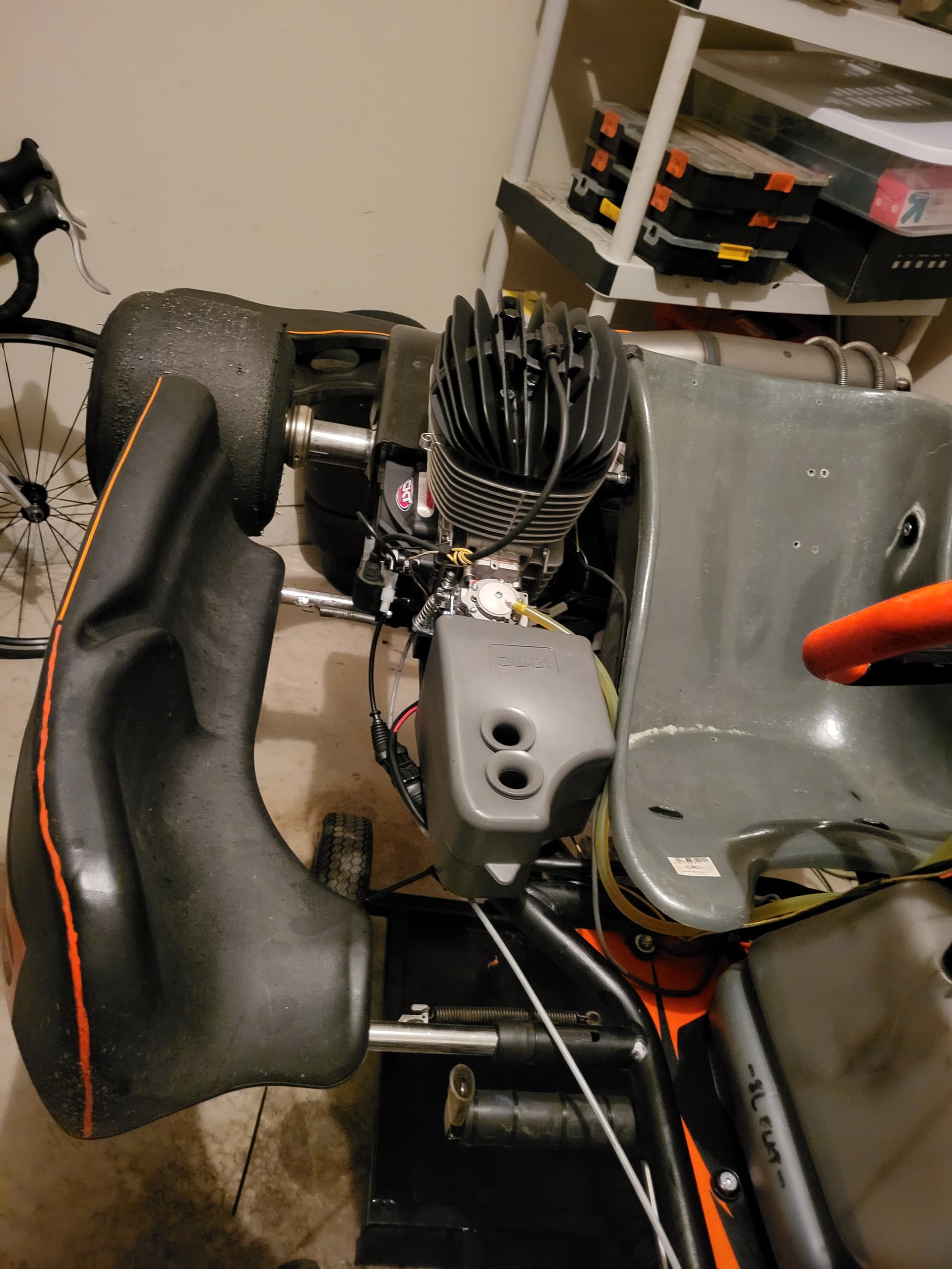

2021 CRG KT2, never bent or straightened, powered by a CKT-built IAME KA100, for sale for $4000. I can also sell you all of my CRG parts. Gauge not included and not really for sale.

The kart in the picture is beautiful
Mad
Yeah that’s a CRG with a 100cc 2 stroke. Air cooled so no radiator which you’d see on a shifter or 125cc. 2-stokes make fun noises.
