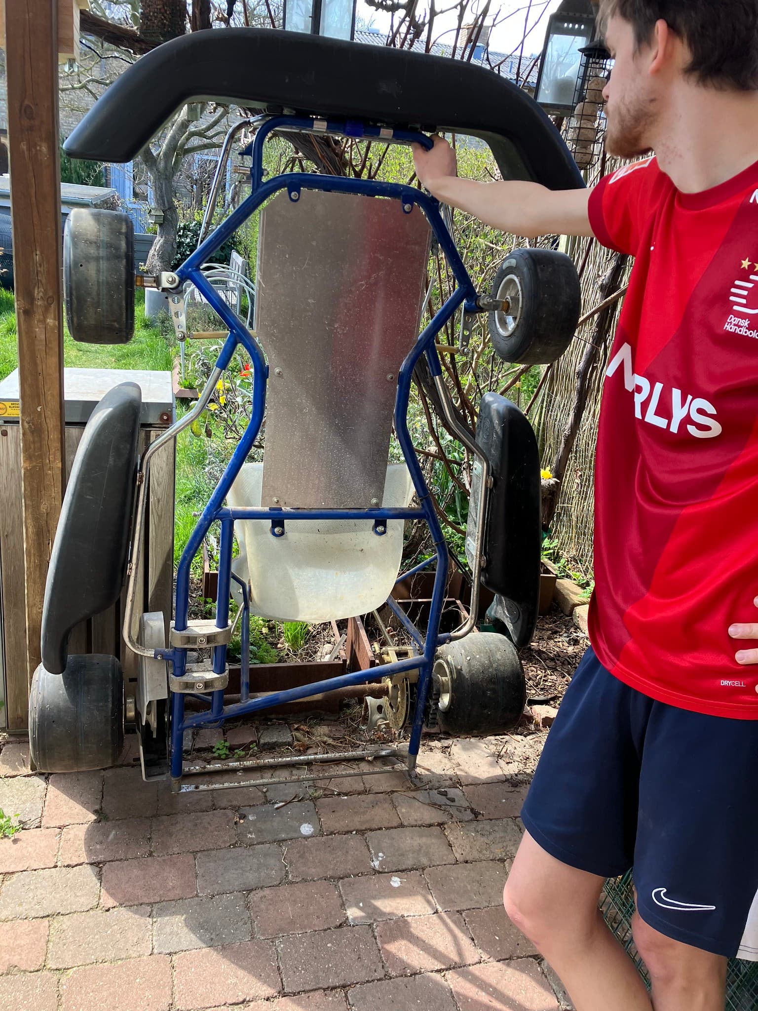

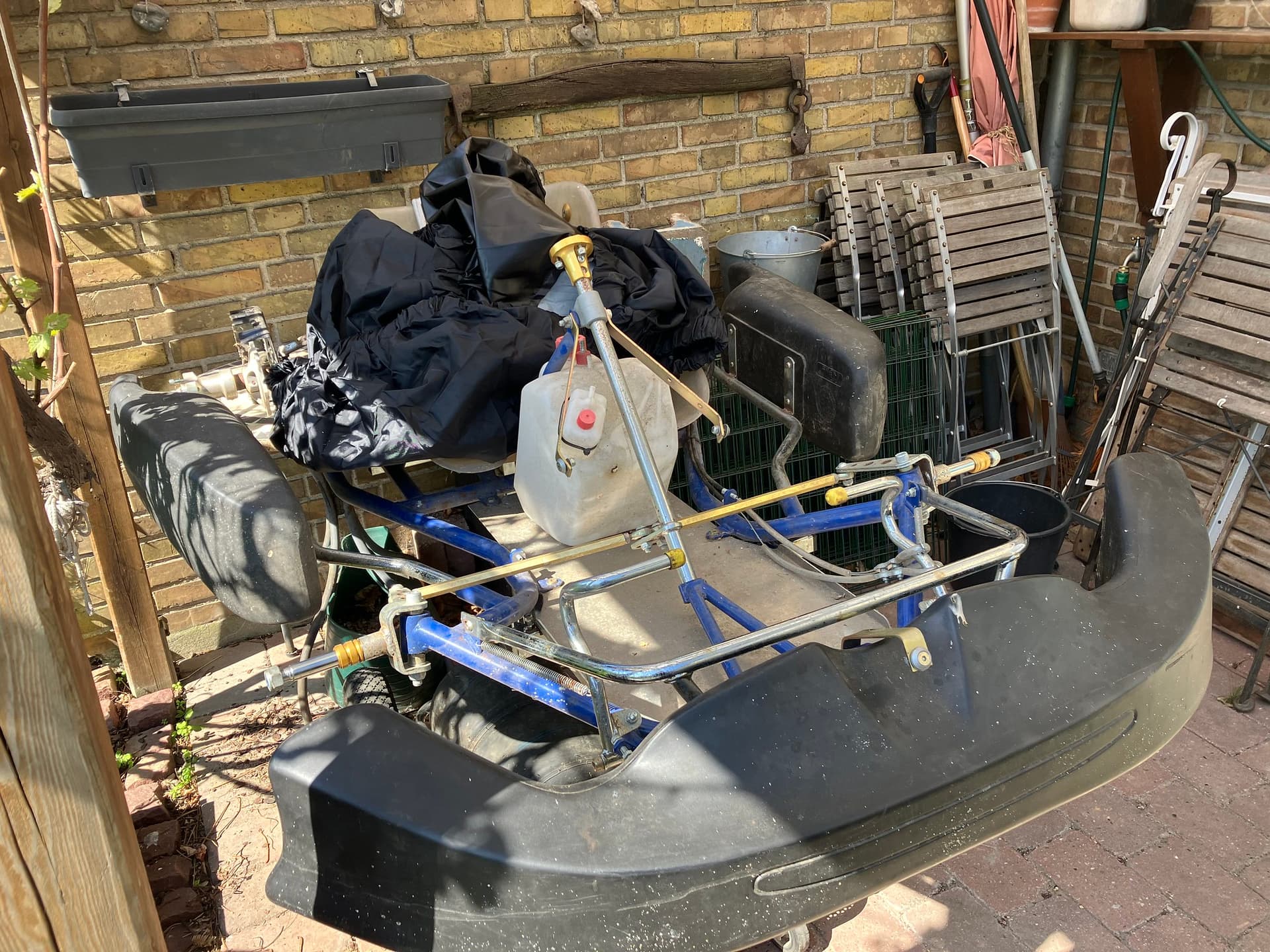

I’m new here on the forum so let me introduce myself: Middle aged, engineer, restoring an old french sportscar working with IT quality, helping my 25 yr son get into karting with almost no budget, northern Europe. We’re trying to get an old Birel/Vortex Rok kart which he bought last year run, but this thread is about restoring another, partially complete kart he got a few months ago: A KFS IAME 100cc. It was imported here at some point from France, with little meaning, as nobody are running the KFS karts outside of France. So we started researching what we could do with it :wink:
The bad stuff first:
Chassis has many rust stains
Rear axle completely brown from rust
Chromed parts all stained or rusty
Brake disc rusty
Parts missing: Carb and airbox, exhaust, steering wheel, nassau panel, hoses, cables…
The good stuff:
It has a new set of tyres
Brake and pads looks good
Seat is good

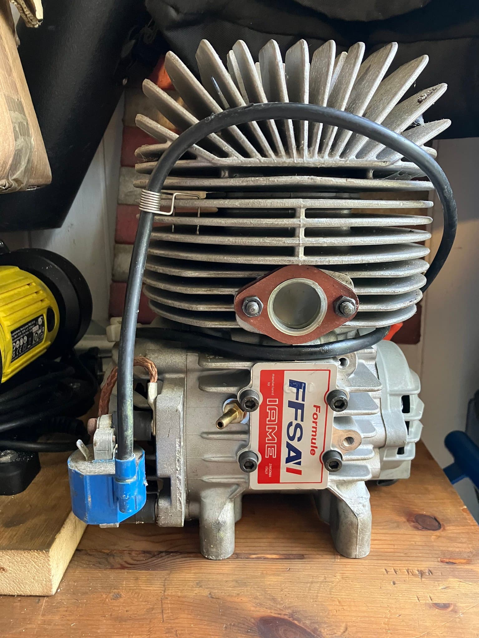

Engine is decent and complete
Original electrics is new
Chain, spark plug included
All bearings are good
So there’s little excuse for getting it out running, and researching a bit about the KFS karts gave us some interesting ideas.

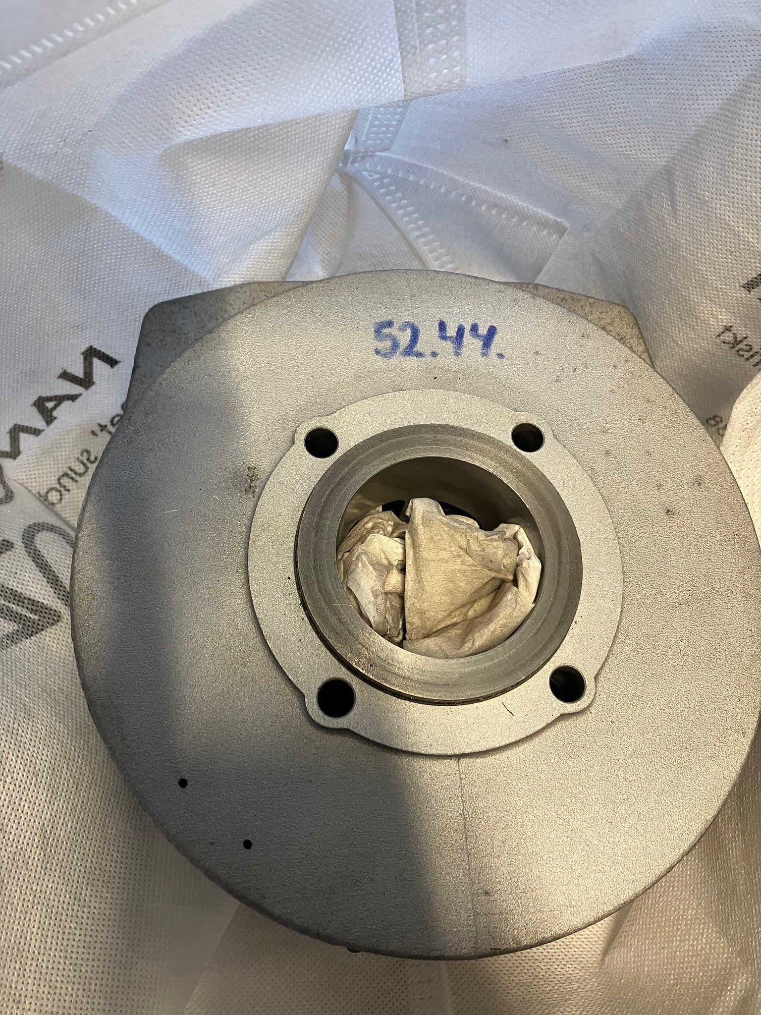

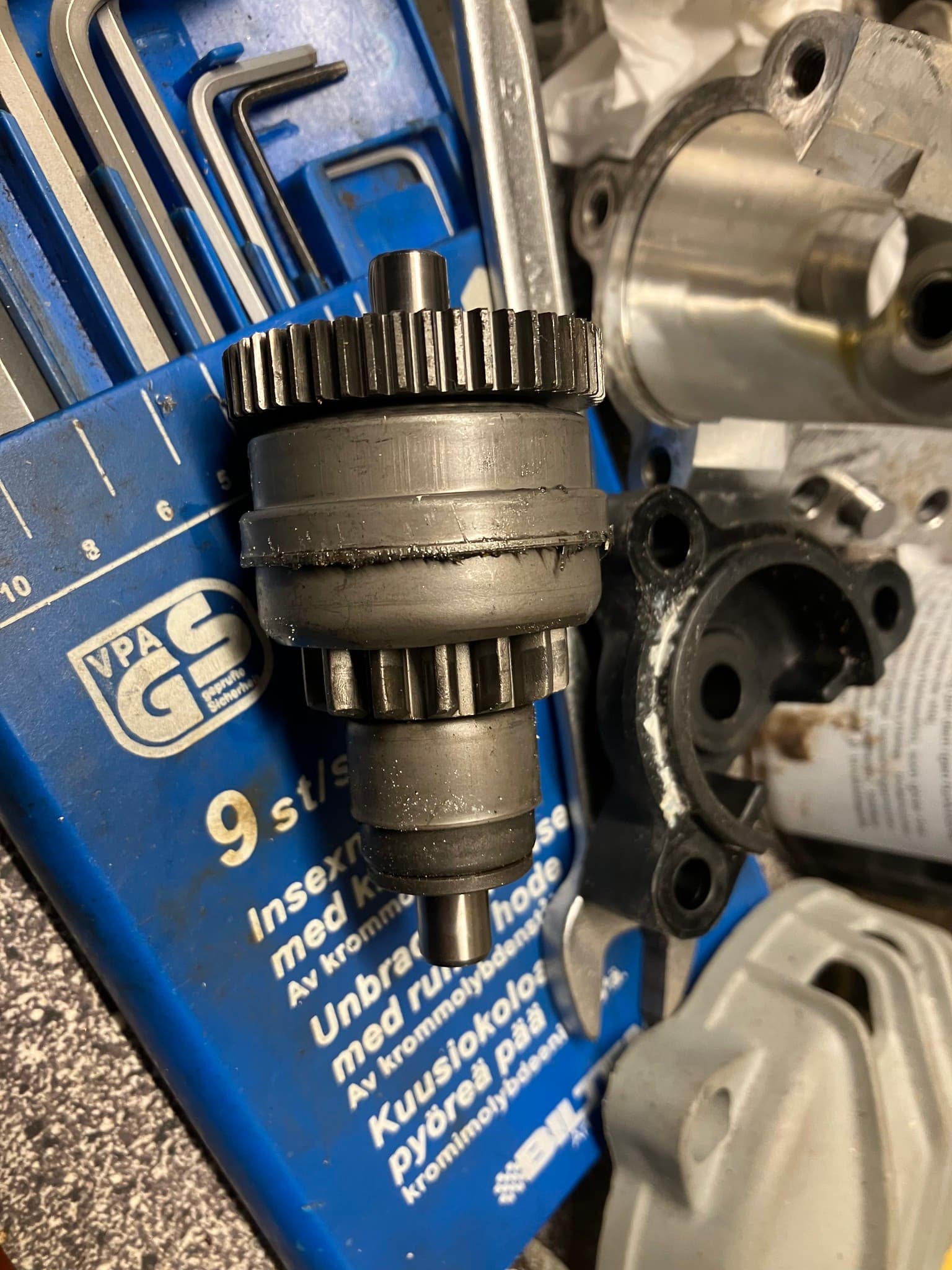

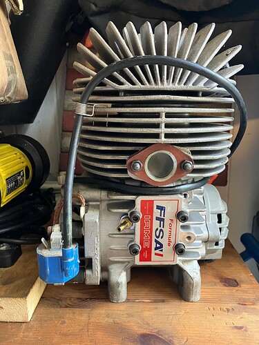

We got the cylinder back from honing yesterday and I took the starter, bendix drive, and clutch out too. Interestingly the clutch is completely new. I can’t understand why the engine was not honed. The piston has clear signs of wear. Anyway, we’re rectifying that now.
We’re not going to strip the kart itself yet as we want to run it. I’ve posted a list to EvoKart this morning, will be interesting what they respond. I’ve found all parts elsewhere, so we’ll get it on track no matter what :grinning_face_with_smiling_eyes:

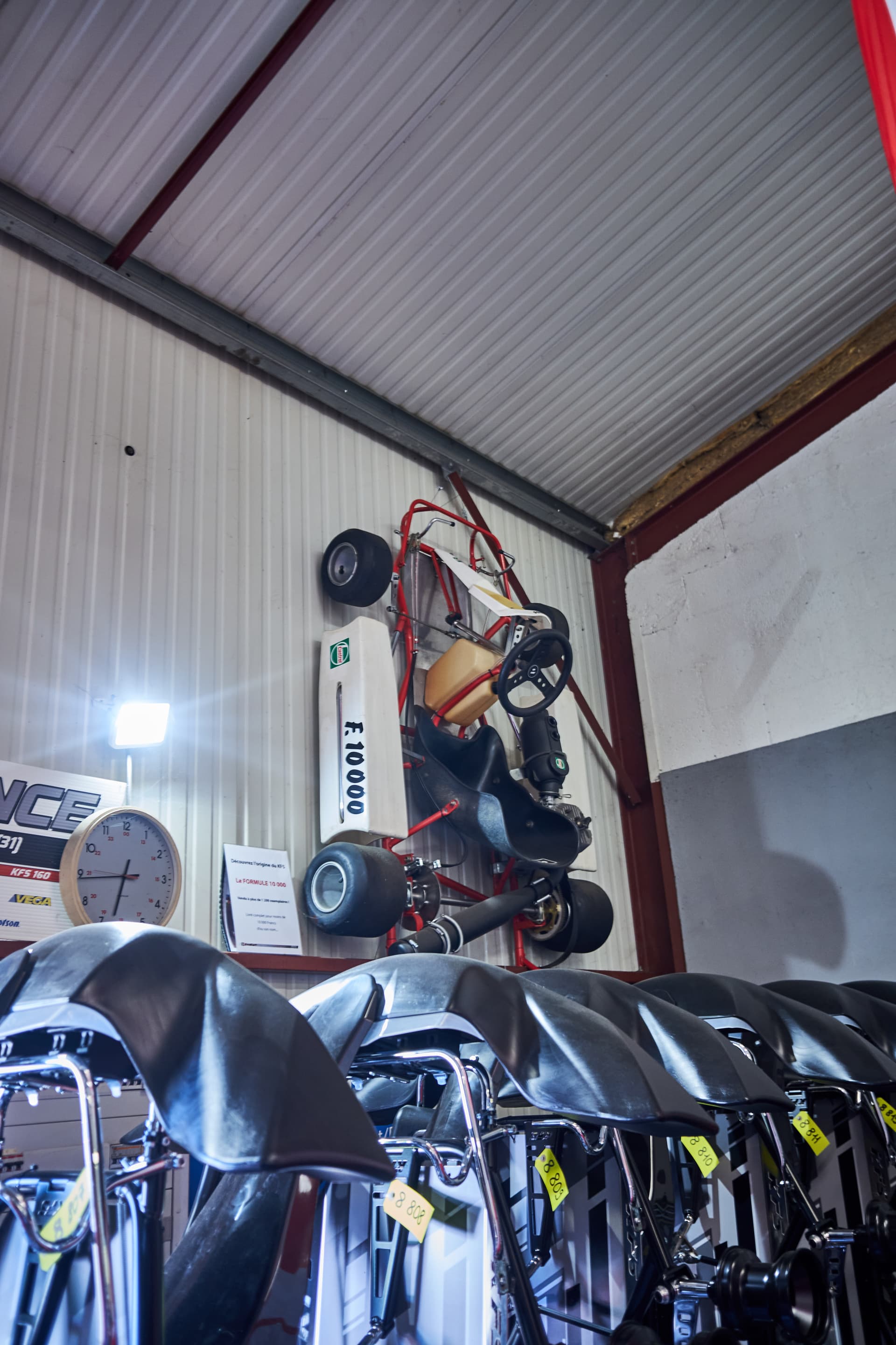

Where it all started, the Formula 10000:

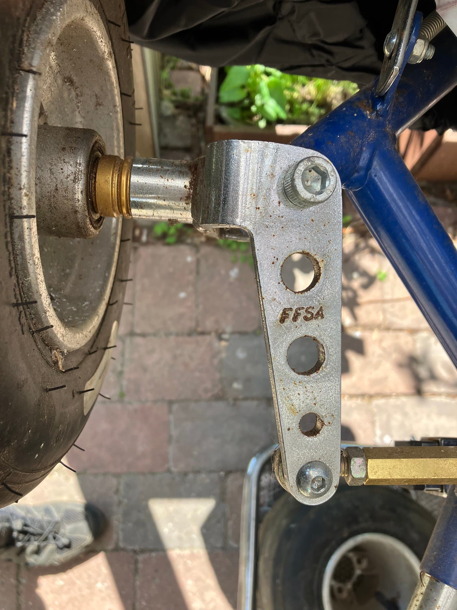

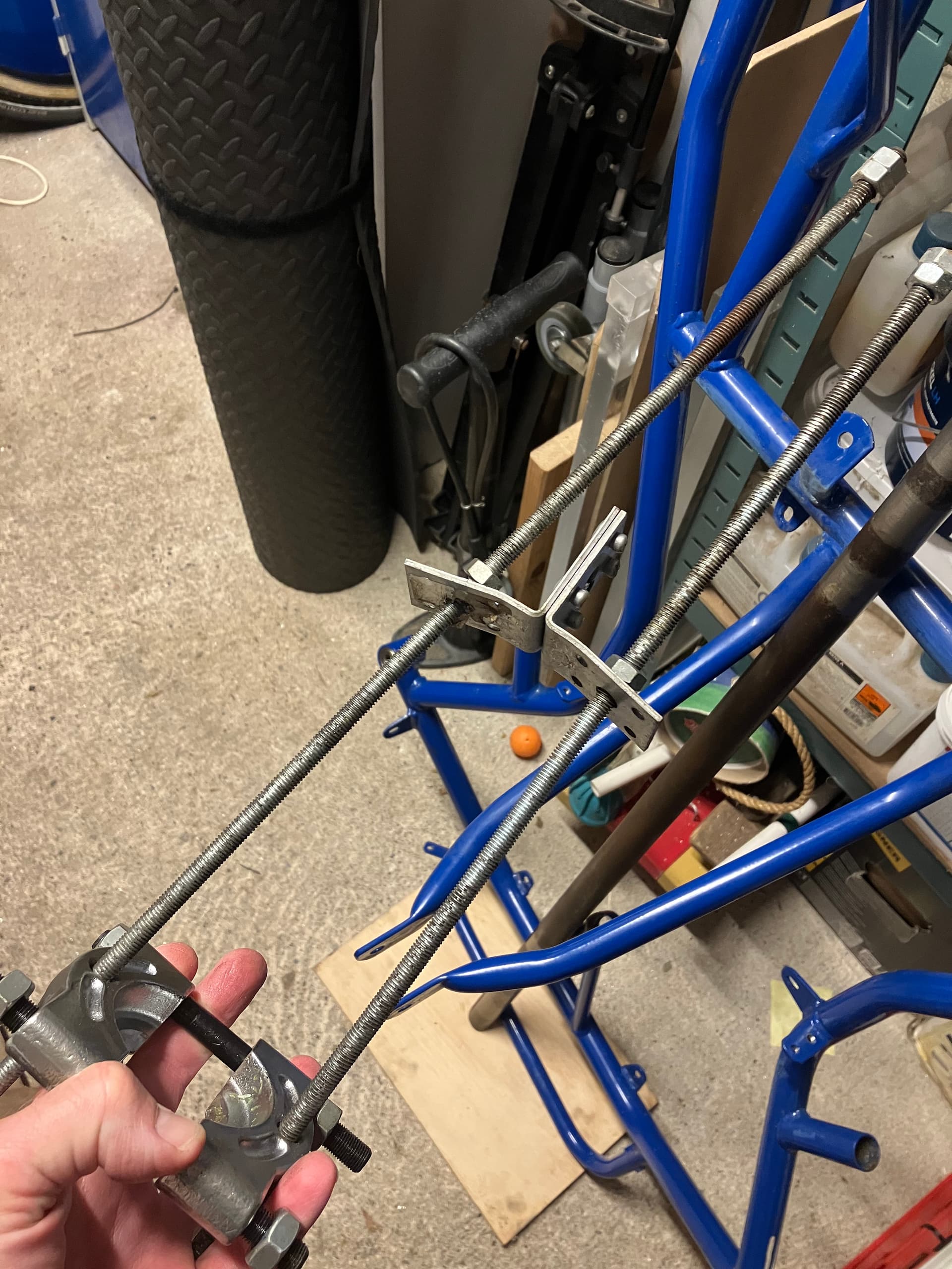

The rear axle is 30 mm solid and it was quite rusty but as it’s a solid one we didn’t feel there was any reason to replace it. Still we wanted to clean it up and remove the bearings and brake disc and rear sprocket holders. Removing the bearings was obviously not easy but worked out with the use of this contraption and a small blowtorch. It was quite a pleasant moment when after applying tension on my tool and blowing heat on the bearing, it finally gave a snap and was free.
The axle still looks rusty, but bearings slide on and off. New ones will ordered.
We’ve stripped the chassis almost totally to clear the rust issues. After buying parts at EvoKart, the son doesn’t have the money for a blasting and powder coat, so we’re apply rust converter where necessary, protective paint and a spray-can coat on top. Let’s see how long it lasts…

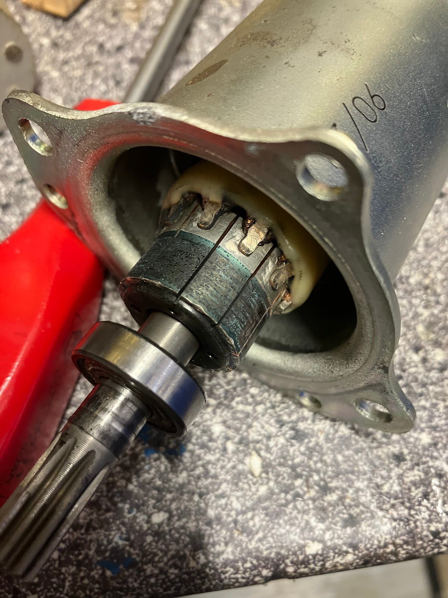

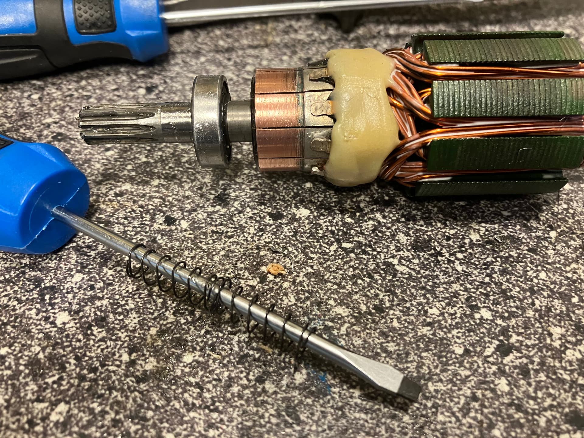

We have had some good progress with the kart restoration and now have an almost complete kart - a few issues have shown up, though, e.g. this starter:
Not surprisingly, nothing happened when power was applied to it. Storage in moist conditions can lead to the strangest of problems. Fortunately, the engine itself was well oiled and is fine.
After cleaning and reassembly, it works perfectly :smiley:

The Tillotson karb is giving me problems though. It’s a used part, but restored by EvoKart. I’m afraid they’ve done something wrong. Problems are:
  • I can’t blow fuel up to it
  • It doesn’t pump when the engine is cranked
I think the membrane inside might be incorrectly fitted. Click the picture to view a video showing it cranked.
Tillotson carb not pumping

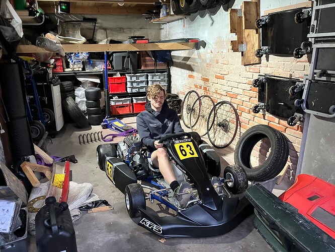

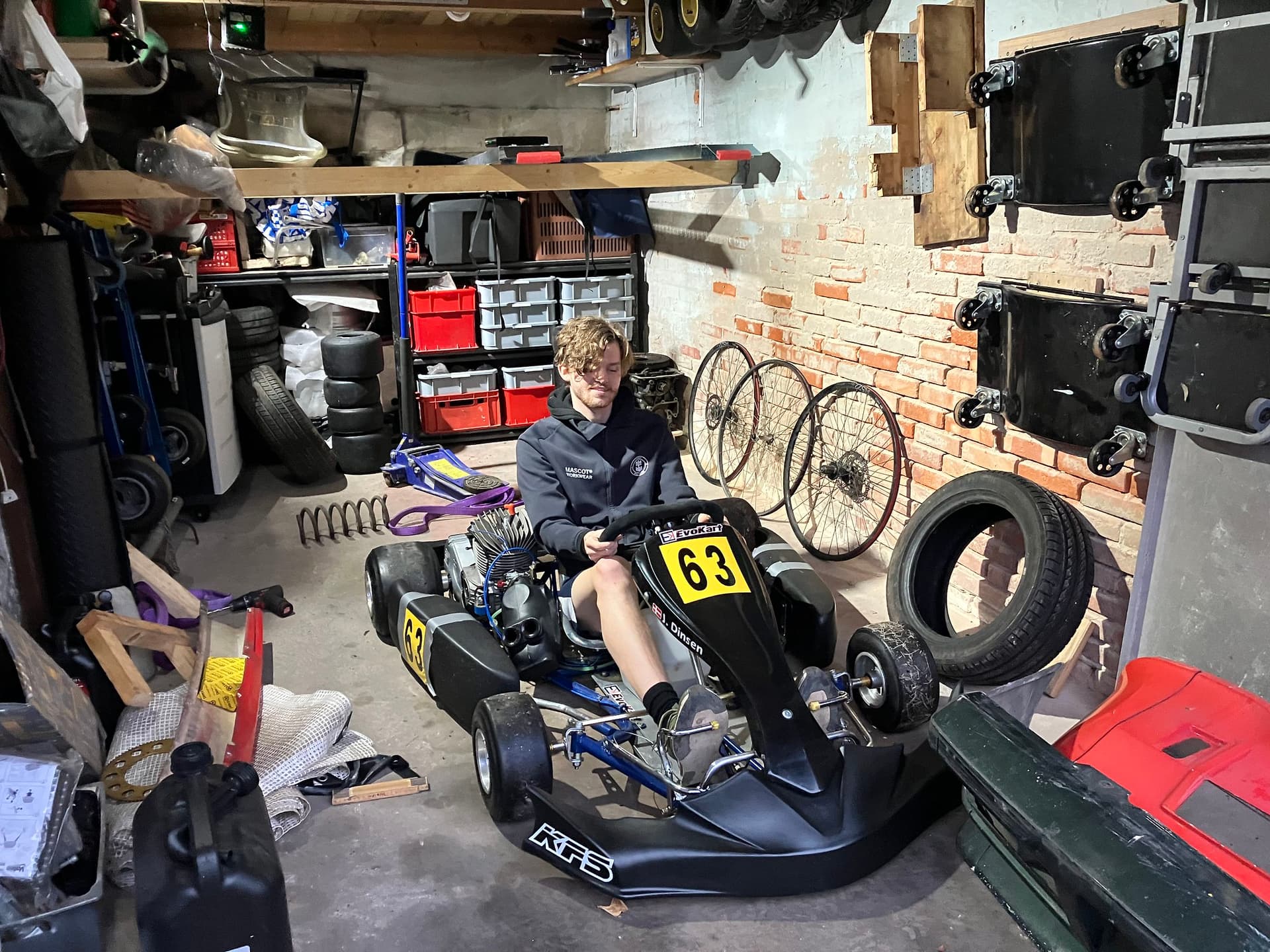

Here’s the young man trying the new seat inside my small garage. I have been restoring a 1982 Matra Murena here for 8 years now. The kart sits on the beams above the car!
